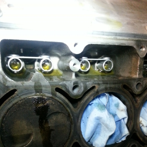

morel 5290's for me, just to many "ls7's failed" threads

So what's better about the 5290's over say Brian's SLR lifters besides the link bars. To me the main attraction of the better Morel's is the larger diameter roller and you don't get that with these.
I talked to brian when considering my 5290's, and he suggested them for the slower leakdown rate and the fact I wanted to ditch the plastic trays
however he doesn't suggest the 5206's for street use (the larger roller ones), they have extremely tight tolerances and could clog on a daily driver, they're suggested for track queens that drop the oil and filter after each race day
