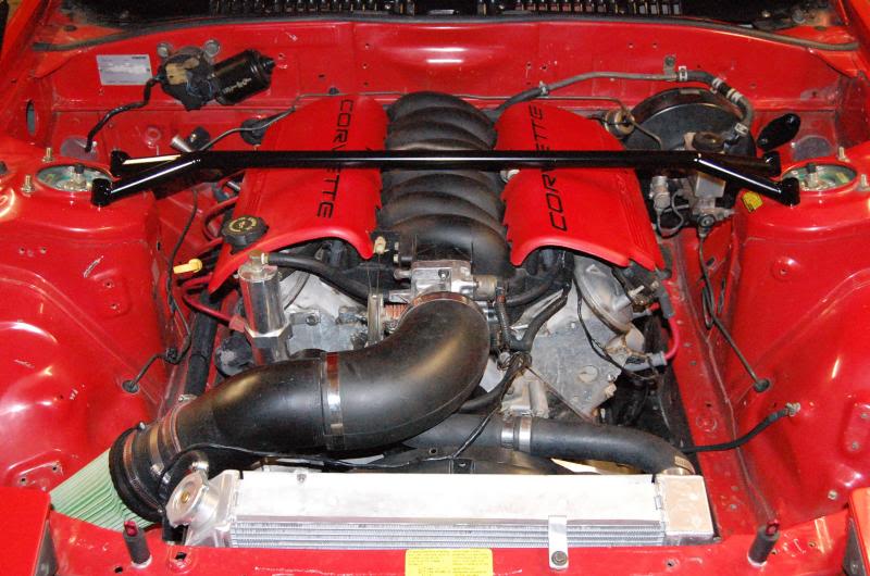

The transmission is the CK Performance Street/Strip build. Should be fine (famous last words).
