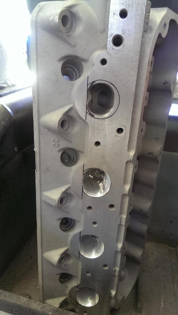

That's what I specd it for. Later I'd like to convert to a snail but just for now I want to play on the bottle some. I traded a friend of a friend the 241 heads to a set of 806 heads. Already port matched them yesterday on the exhaust side only. They've been milled down .03 so I assume it'll have a little less compression then compared to a 241 head. Am I right or just blowing smoke out of my rear? Hahaha

here's where I'm at so far. Still needs to be polished.

Nice! Do you plan on porting the intake runners?
