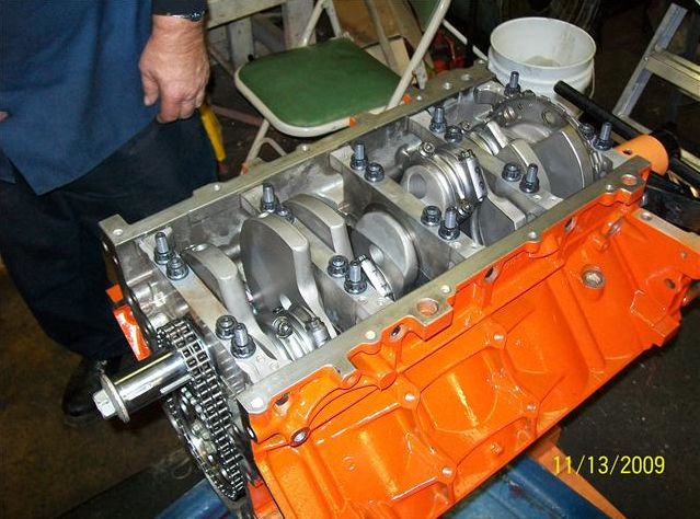

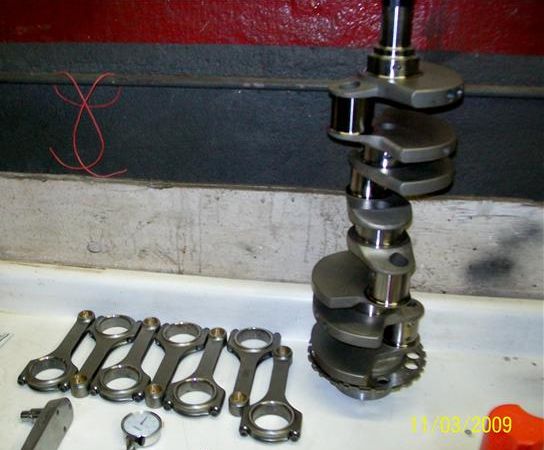

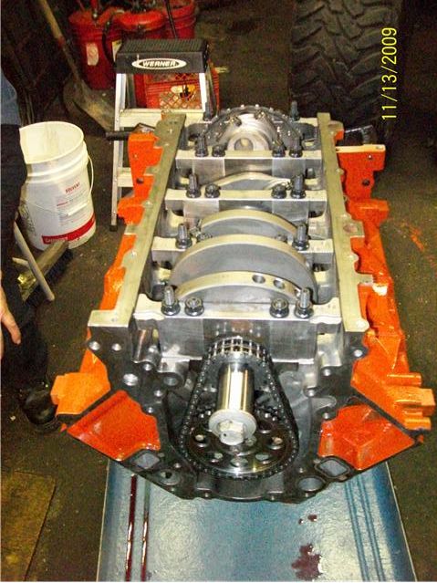

Check into the K1 crank and rods. Price is right, and top quality. 4.00 stroke and 6.125 rods, with Wiseco X Series is a nice package. They sell the package on http://www.wiseco.com
From what I have read, 4.00 is the longest you want to go with the stock block, and some say that is too much.....i hope not because I took a chance with this setup. Some say the pistons will be scuffed from this stroke.
I added the ARP main stud set, and that meant an align hone job...
here is a pic of my bottom end...and btw, the windage tray will need some mods as well...
.[ATTACH][ATTACH]A few questions For Stroker Motor Owners-bottem-end.jpg[/ATTACH][/ATTACH]A few questions For Stroker Motor Owners-crank-rods-1.jpg

Nice! Well there sure is a Lot of guys running 383-408 strokers But i have heard its on the edge pulling the pistons out too far,
What were your main and rod clearances at? which bearings did you use? does the kit come ballanced? how much for the kit? Thanks

I paid 781 for the pistons and 780 for the crank and rods. Add a few hundred for the main and rod bearings. I used clevite bearings as suggested by Wiseco/K1. I will check with my dad for the clearances. He built it while I was in Iraq. I had it all balanced as well. Its not exactly a package deal, they just sell the crank, rods and pistons all on Wiseco's site for any kind of set up you desire. The crank is non twist forged, cross drilled, 4340 steel, and is nitride hardened which is better than induction hardening. Good quality crank for any price, and to me 780 was a steal. The Wiseco's X Series pistons are top of the line. I was looking at Lunati first, and the prices are outrageous, and I can't see that any of it is better quality. The K1 rods are also very nice. My dad has built many racing engines, and he was impressed with the quality. This is a street motor for daily driving, but I am sure I could slam it with nitrous or a supercharger, and it would be bulletproof.
