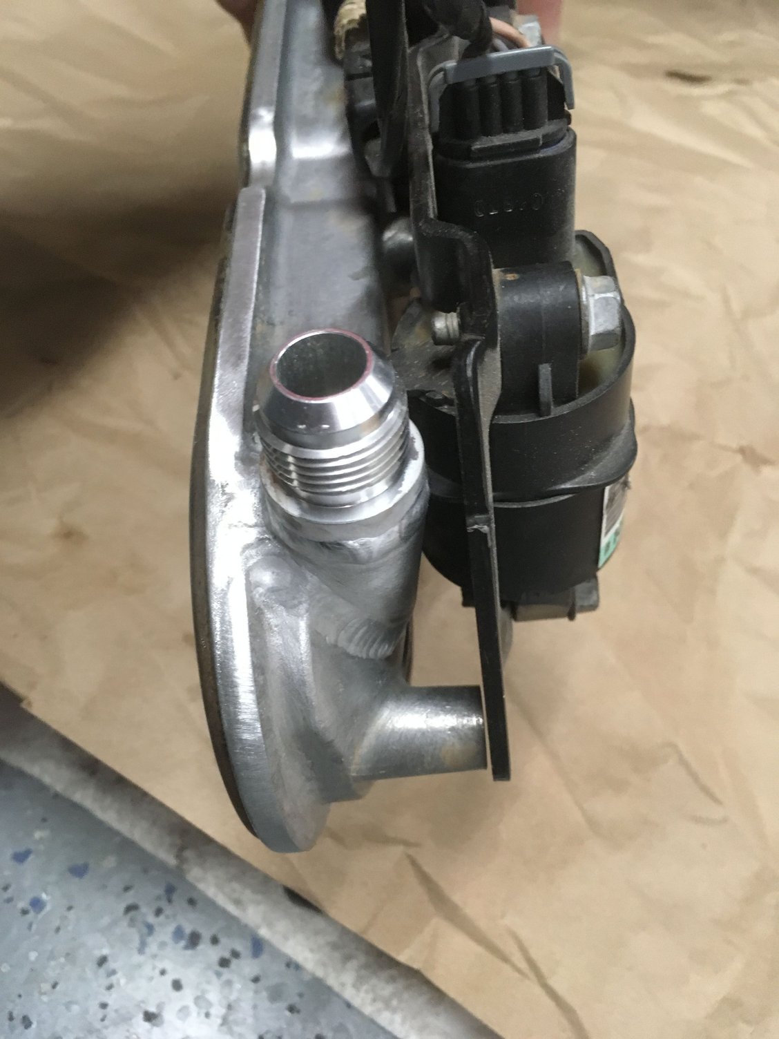

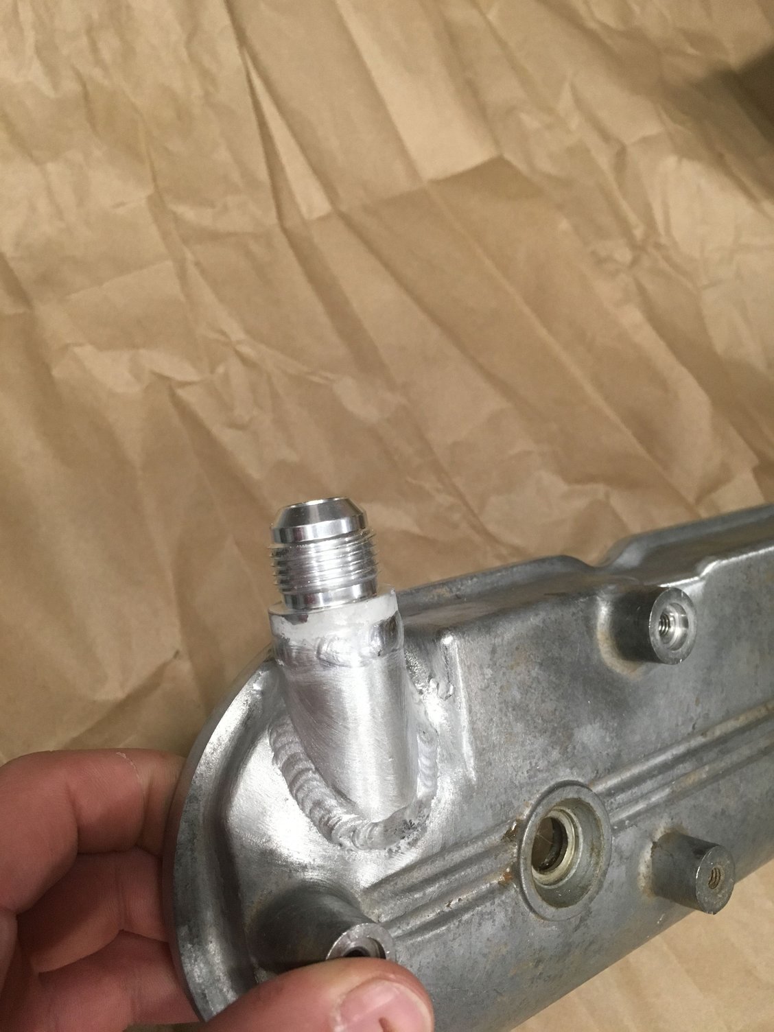

Is one of those in the old oil fill Port? Are those both at the front of the motor? If so I definitely like that setup! Especially since y'all are sure I can run 10an lines.

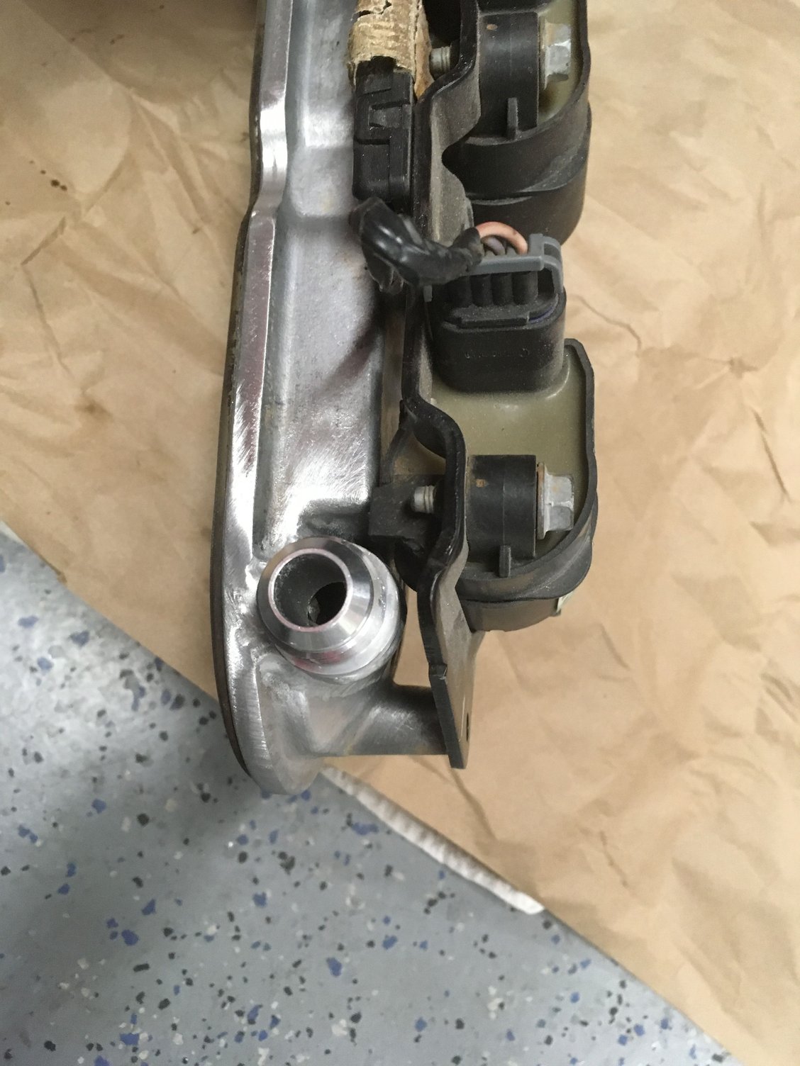

First pic is a 10AN bung on the PCV boss, rear of the driver head. That's pretty common

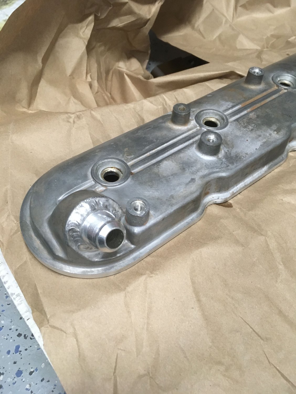

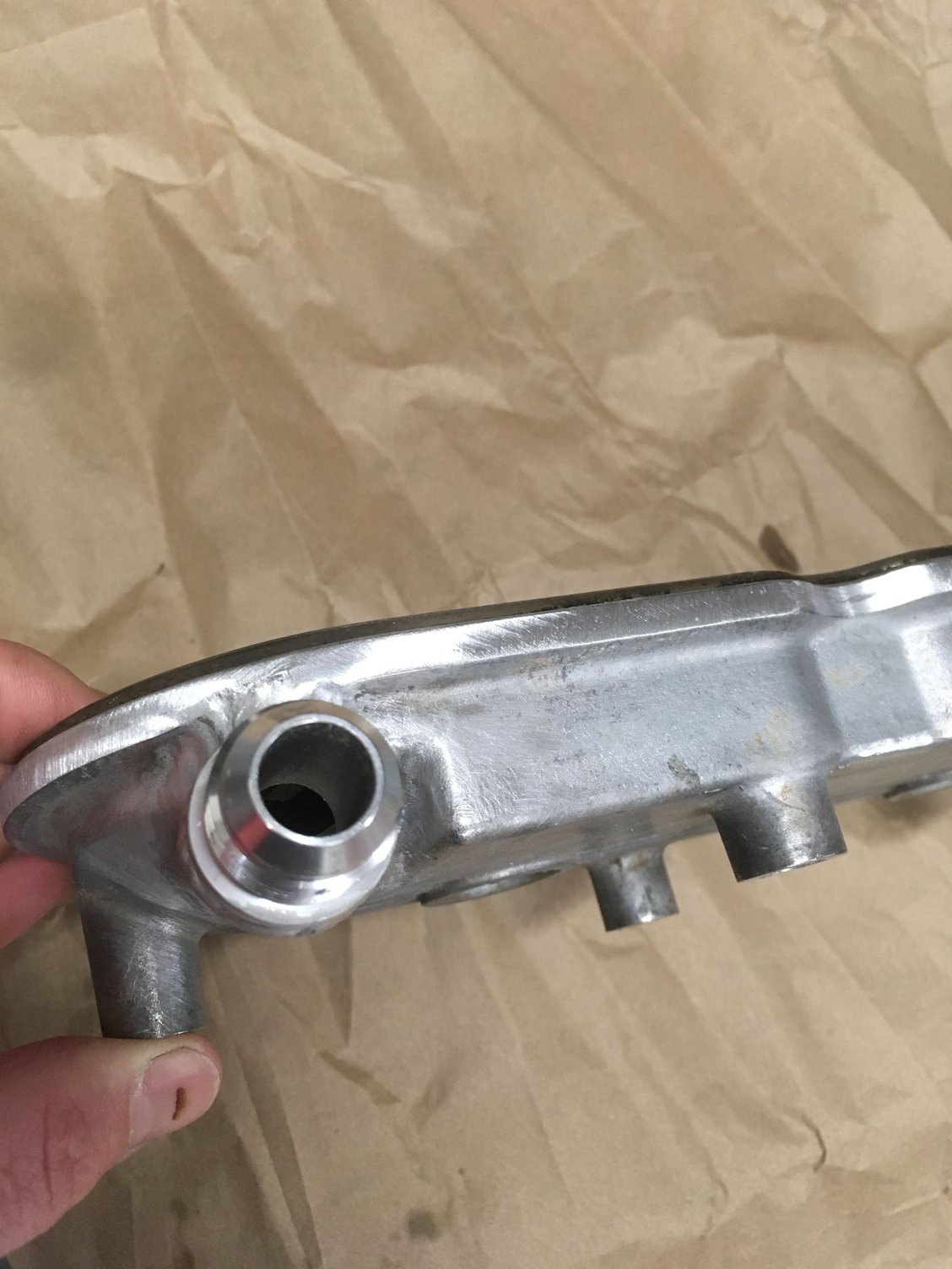

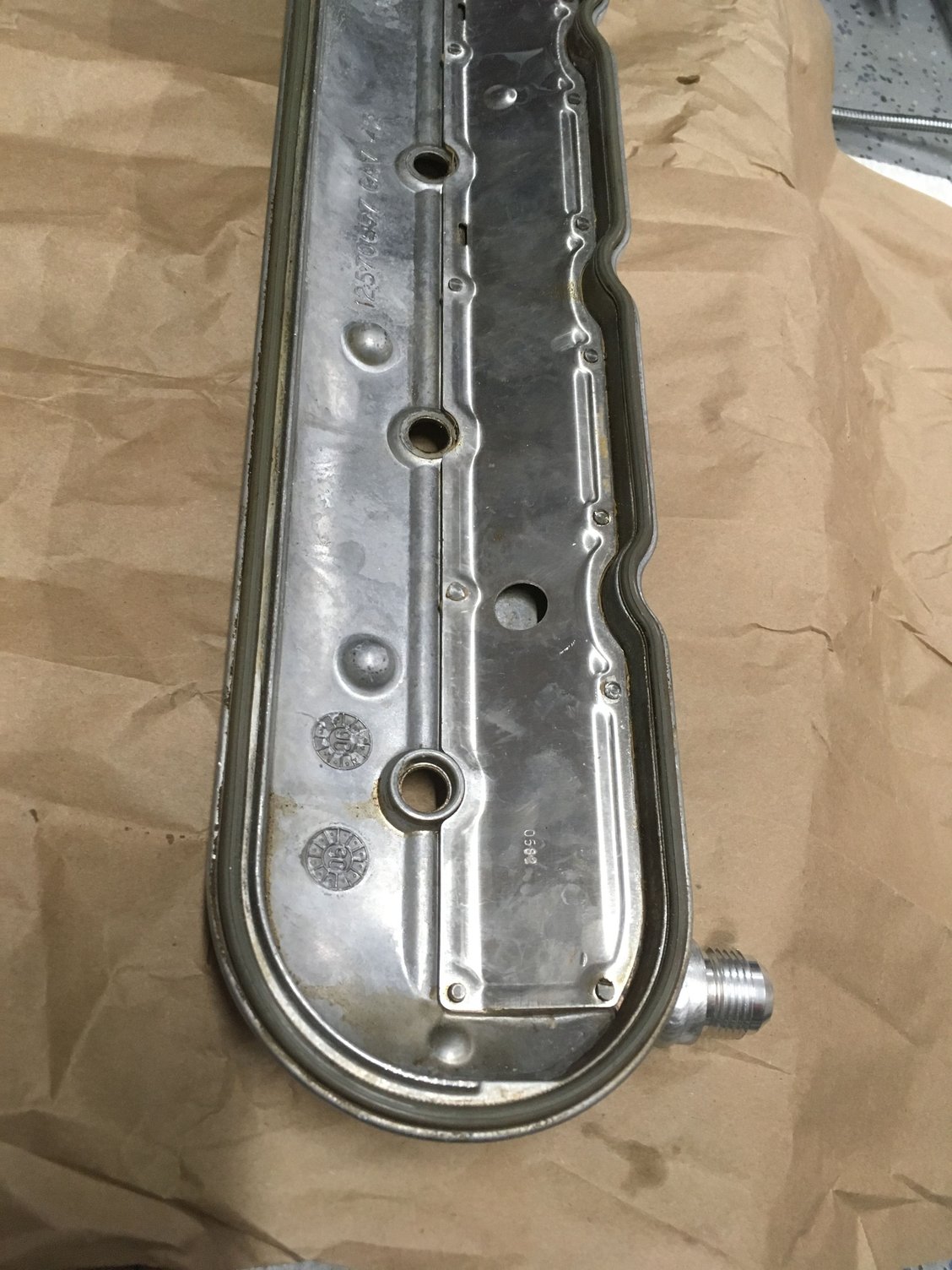

Second pic is a fabrication I did to get a 10AN on the passenger side, back of the VC. It's an aluminum tube, 3/4 OD, 1/2 ID. Drilled the cover, coped the tube, welded to cover and welded bung on. I did a ton of test fits to ensure the coils would still fit

If you go this route it’s advised you add baffling by the oil fill as if not it will suck more oil then you want.
