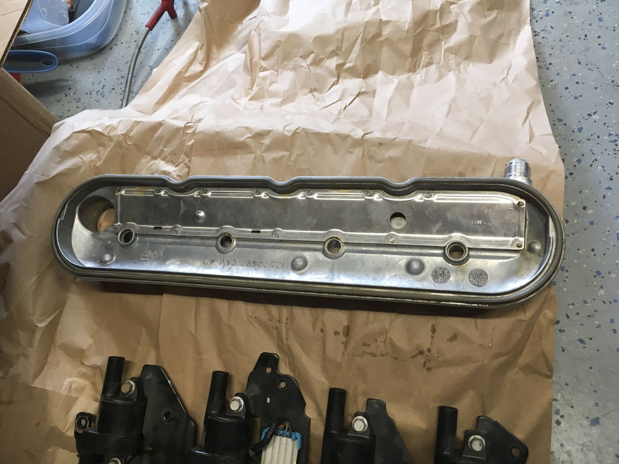

Factory baffle is still in place, not sure what you mean
factory fill has no baffle under it, did you put a port at that location?
Old Nov 29, 2019 | 11:48 AM
arthursc2's Avatar
Joined: Jan 2014
Posts: 4,341
Likes: 1,517

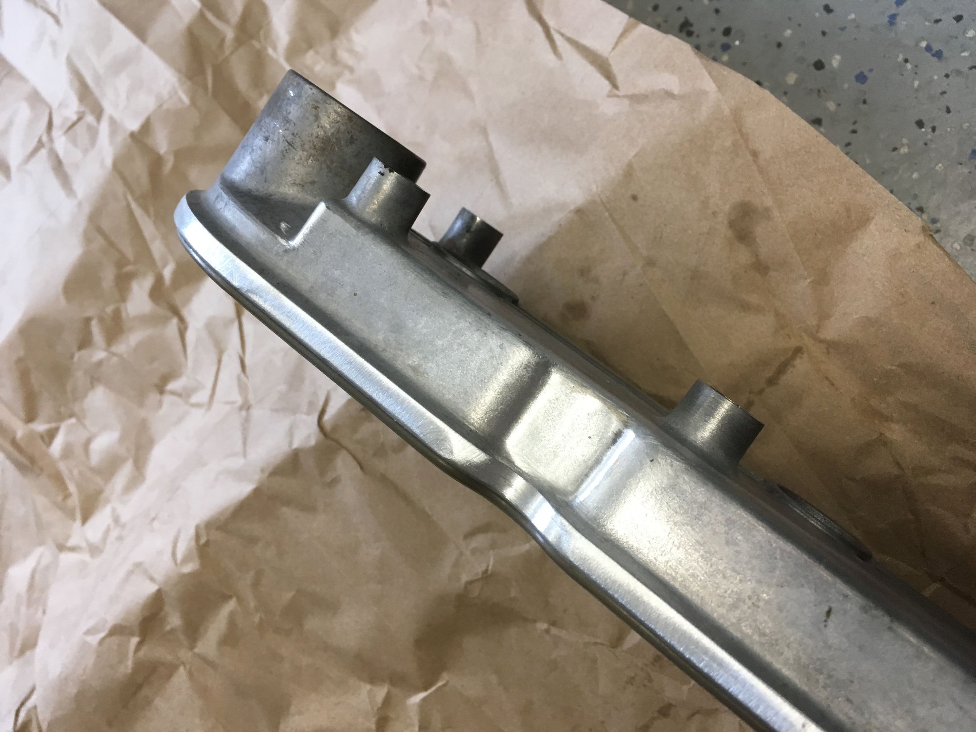

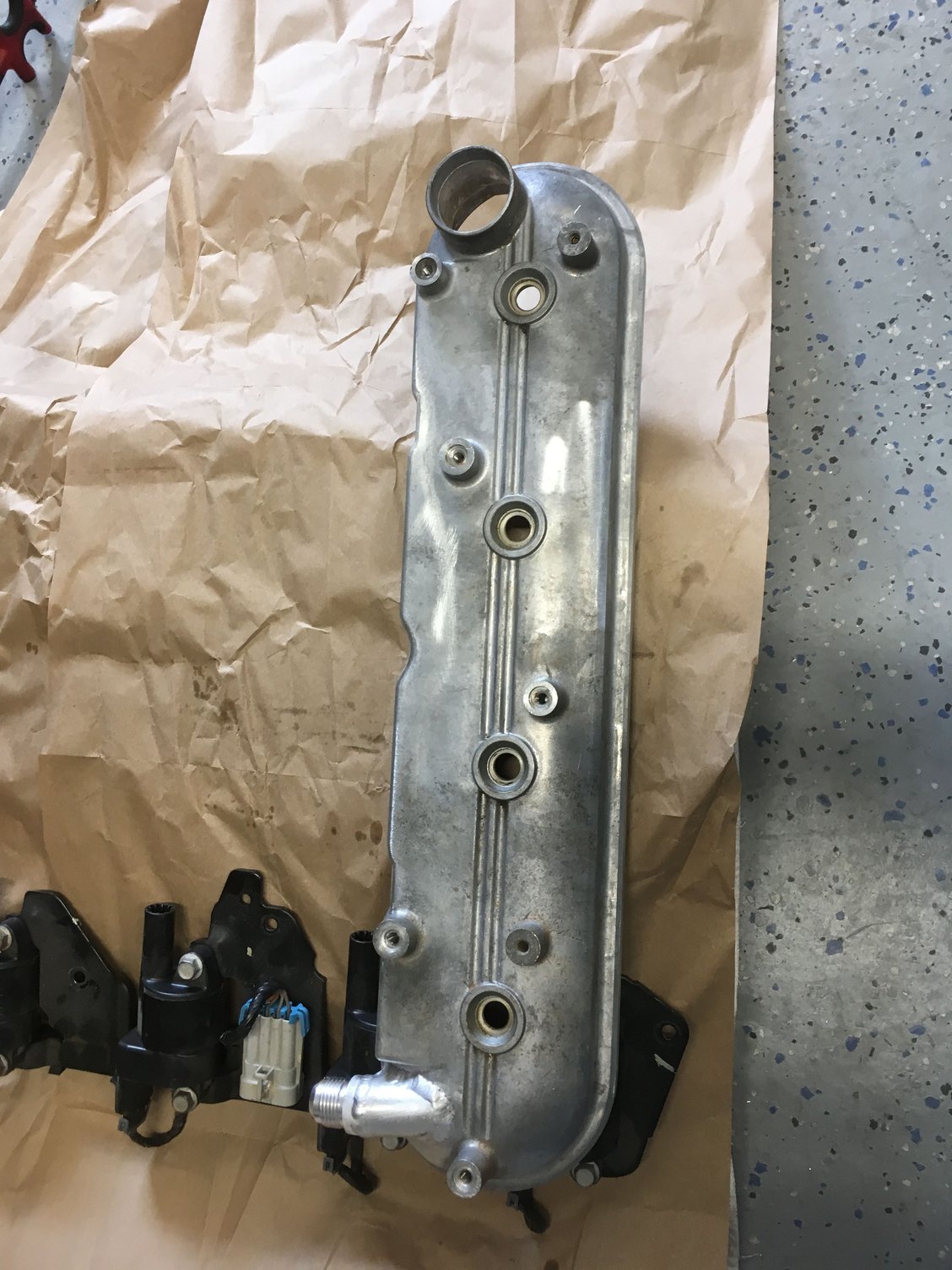

I did not. Both my vents are at the rear and the factory fill is still the factory fill.
I eliminated the breather tube in the upper passenger cover and I added a 10 to the rear of the cover, taking advantage of the factory baffle
Old Nov 29, 2019 | 11:55 AM
arthursc2's Avatar
Joined: Jan 2014
Posts: 4,341
Likes: 1,517
Factory fill still in place
OE 3/8" breather eliminated
100% factory baffled
10 fits under coils, hole drilled in cover for vent to be functional, factory baffles utilized
Old Nov 29, 2019 | 12:06 PM
03sierraslt's Avatar
Posts: 19,007
Likes: 221
From: Western PA
Gotcha.

My intent was to put the gen4 covers in an NBS
Now they are going in a C5. If there's gonna be issues, it's gonna be in the Corvette. I don't think there's fit issues on the truck cowl

your restriction is in the factory baffling if you are using a 10an and pulling through the factory hole which is the size of a dime or smaller

-10 only has an ID of .550 or so, so not much restriction if any at all

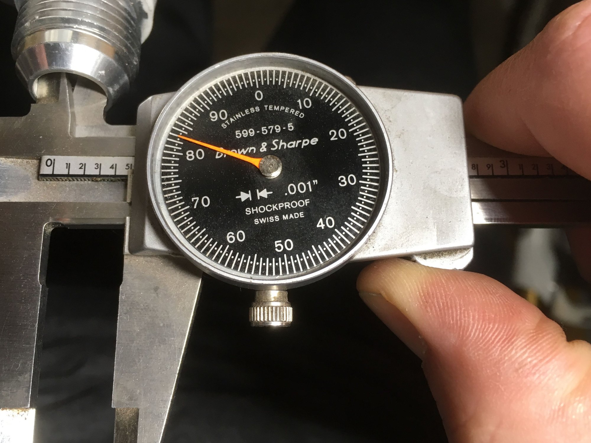

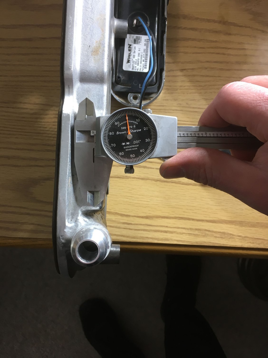

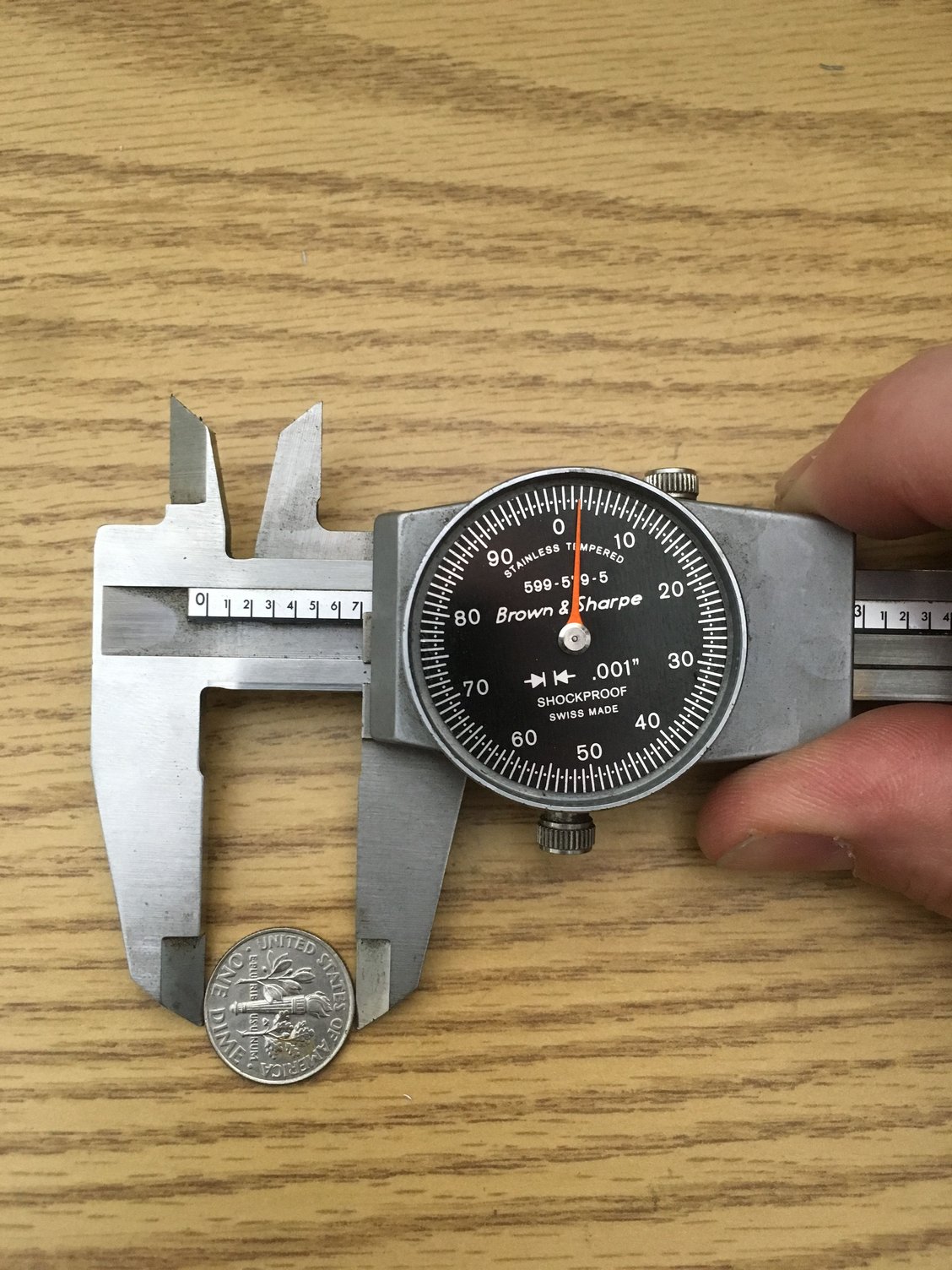

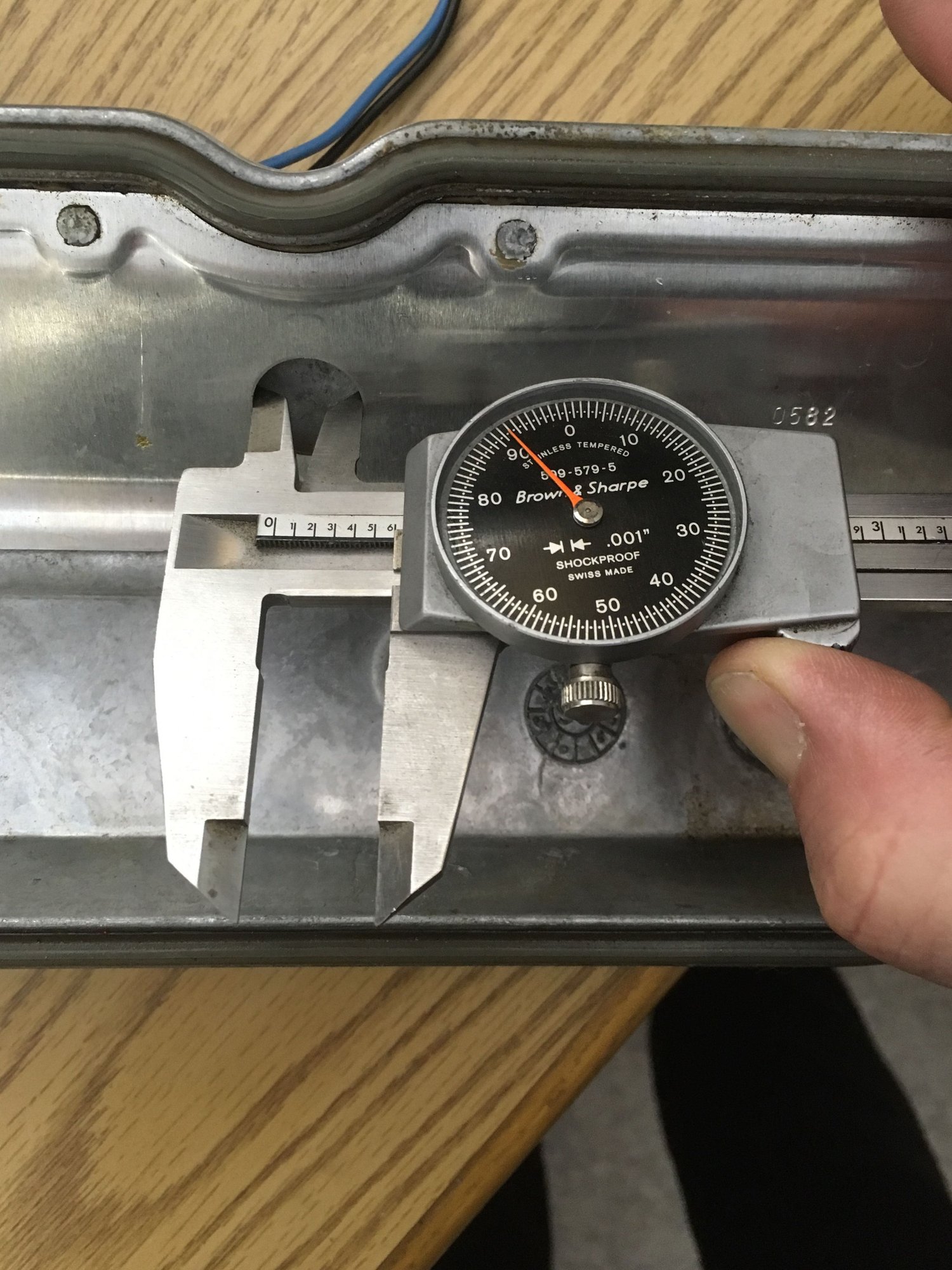

Calipers with no 0 error
-10AN with a .483 ID
Factory baffle with a .592 ID
Being the size of a dime would be an upgrade, actually. But the fact remains, the factory baffle will allow a -10 to operate sufficiently
Ya'll been sippin that haterade
