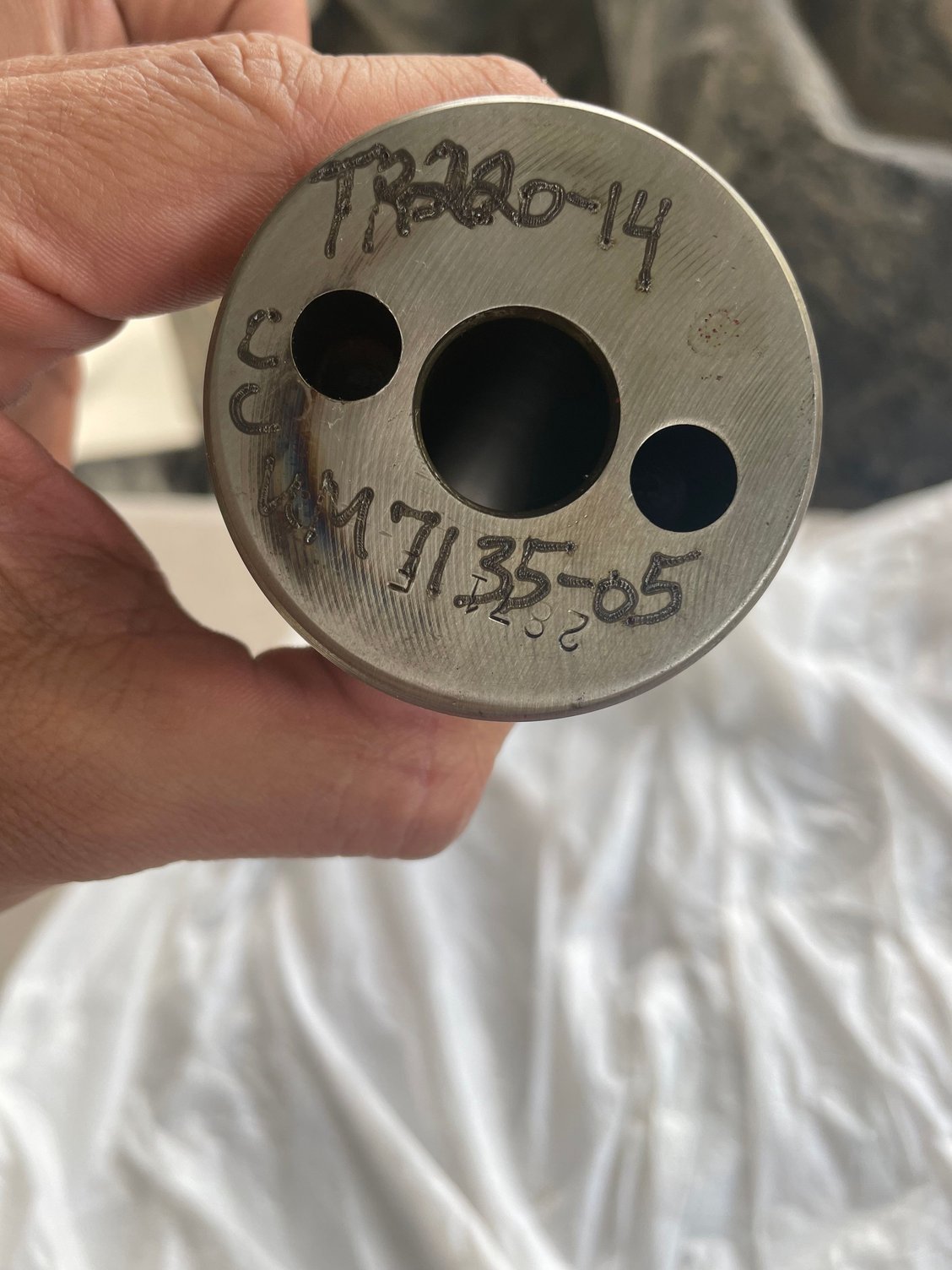

My truck recently broke down. I took it to the mechanic and told me that the cam and lifters needed to be replaced. My truck had a TR 220-14 but I want to replace it with something similar si ve Thunder Racing is no longer available. Here is the cam that it had.

Do you know the lift on that cam? I found an old for sale ad that listed 220/220, .552 lift, 114 LSA.
Texas speed has a similar cam but its .600 lift
https://www.texas-speed.com/p-8545-t...-camshaft.aspx
Or if you want to stay around ,550 lift, you could try there stage 3 low lift.
https://www.texas-speed.com/p-8556-t...-camshaft.aspx
Or you could have some one custom grind one for you.

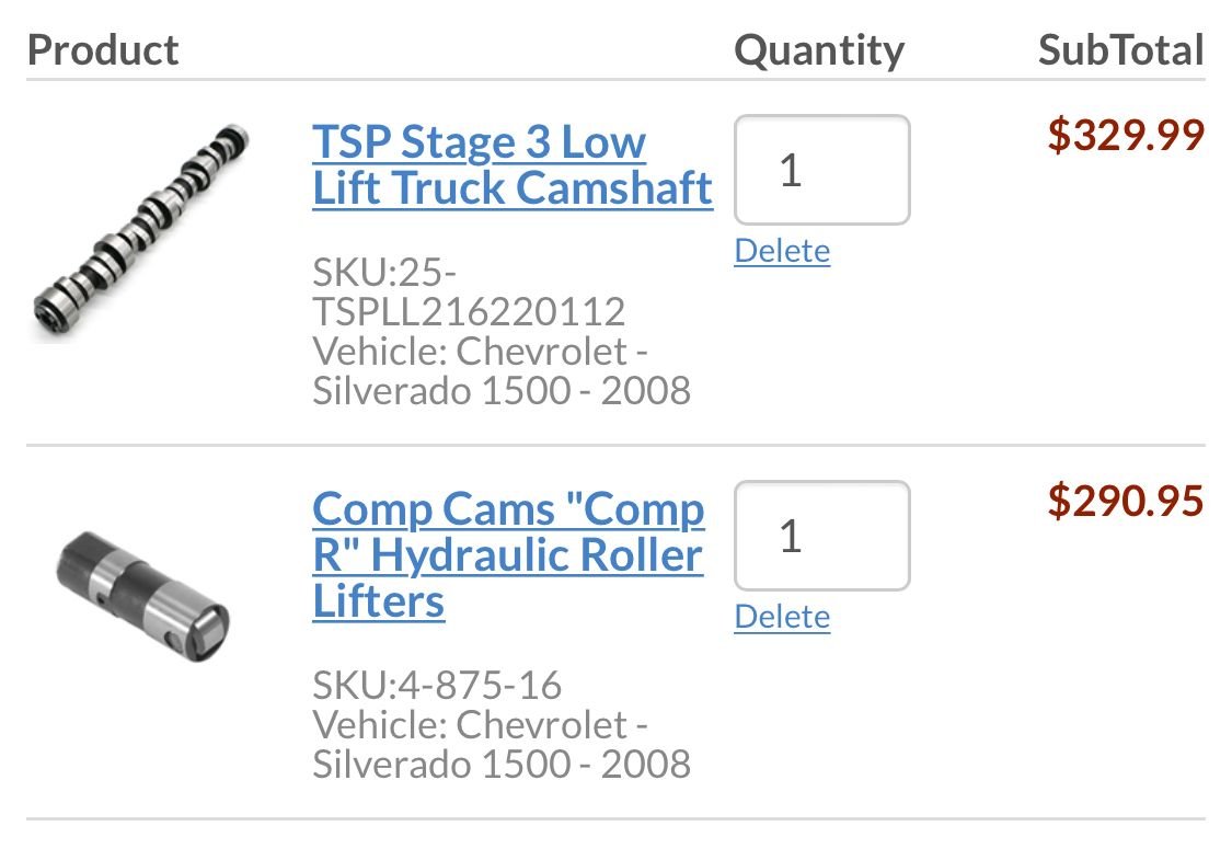

Btw my truck has a 3200 stall, I think I’ll go with the low lift since it’s my go to work truck (15 mile drive) what about the lifters. They have this on the website. Would I need to retune the truck?

If the cams are close in specs, you should be fine. I'd still retune to be safe. You're changing the airflow demands of the engine.

Even if the duration at 0.050" are the same, the rest of the lobe profiles can be different affecting the volumetric efficiency at different speeds and loads. Not to mention the intake and exhaust centerlines may be different; the ramps symmetrical or asymmetrical. Best to re-tune.
