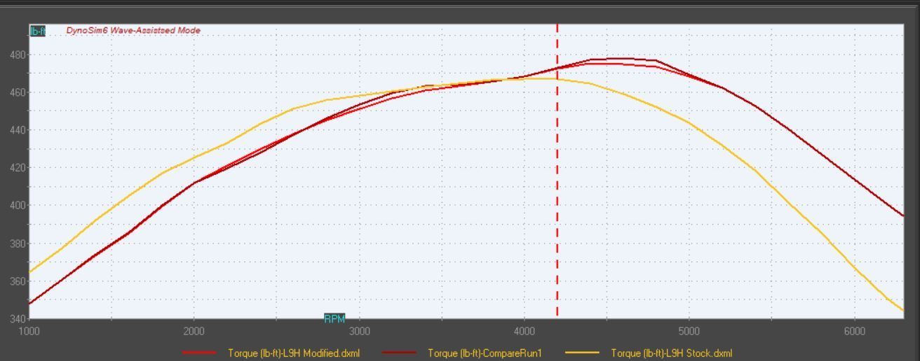

I'm not sure what we are looking at here, but it's obvious that the yellow graph is waaaay better for real life driving than the other two.
Yellow is stock cam, but I haven't verified in detail that I haven't changed anything on the stock cam sim versus the others. It appears the sacrifice we make to have both a smooth idle and more torque, which more torque requires it to be made at a higher rpm. This as opposed to a "stage 1/2 cam that would have a slightly higher duration but less LSA which would make for more overlap and would bring shaking and roughness below about 900 rpms.

Originally Posted by 68Formula
If you look up the CamMotion cams on SummitRacing they list both the advertised and .050" durations. From what I saw it was typically 55 (I did say "about" as it may not apply in all cases, but it does seem very consistent).
Here's the headflow https://ls1tech.com/forums/generatio...omparison.html
I got my flow numbers from here:
Taken from: https://www.hotrod.com/articles/ccrp...ylinder-heads/
Do the LS3 heads flow the exact same as the L92/L9H? The ones from my link are a good bit lower than the ones on LS1 tech forum. Of course its a loosing battle trying to compare head flow data. Another thing that is missing is I don't know the advertised duration or valve event timing of the stock cam, only the 0.050 numbers anyone have those?
I know the program I have curve fits a cam profile from "specs" you enter. It will also estimate the seat to seat (advertised) numbers by trying to curve fit it, but it seems it outputs a lot more aggressive cam than the true measured advertised numbers.
The graph dosen't change with the new numbers but I think it may change a little with the correct stock cam advertised numbers, I also graphed charge loss which I believe is both charge loss to the exhaust and reversion loss:
