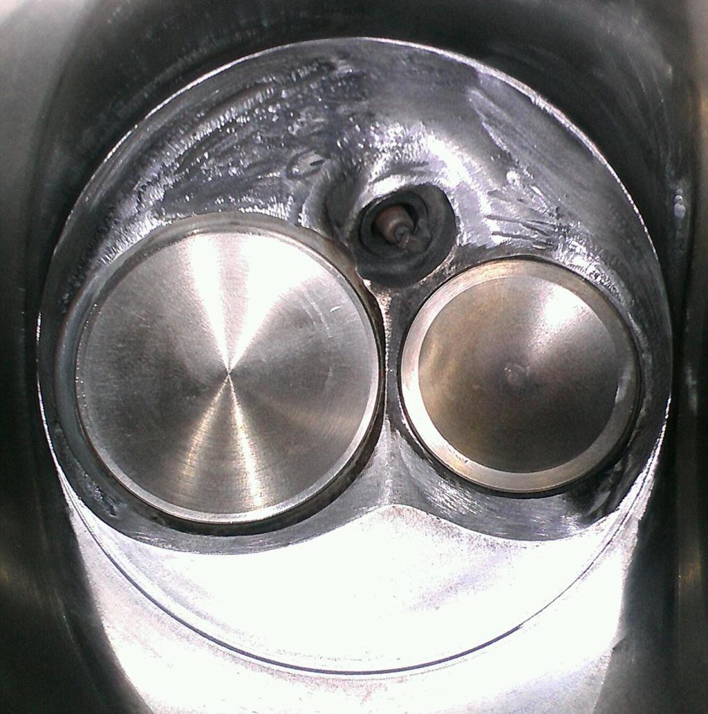

Well, I decided to see how the cylinder on a stock 6.0 bore matched my TSP PRC 2.5 truck heads. This is a pic inside the bore of a stock 6.0 cylinder looking at the bottom of the combustion chamber. Looks like I could remove quite a bit of material. Anybody done this? It also makes me think how close the intake valve was to the cylinder wall on my 5.3.

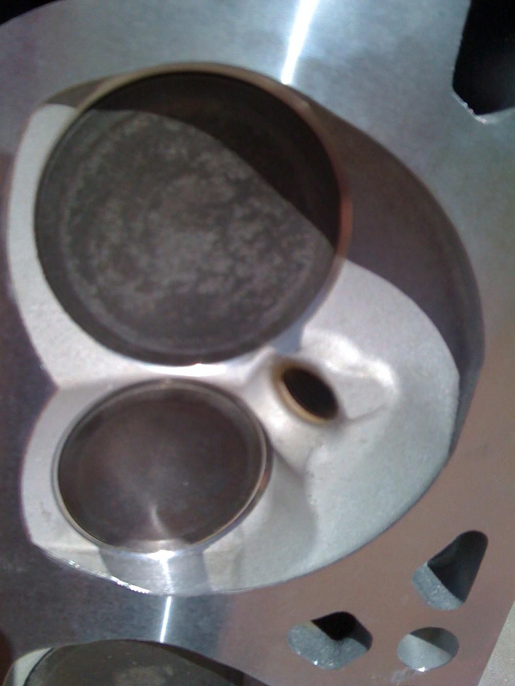

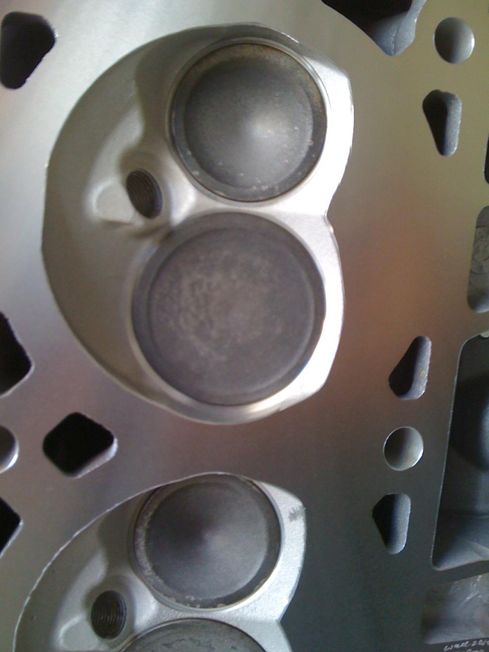

yep mine was part of the performance valve job i had done
Attached Thumbnails anyone unshroud their valves?-069.jpg   anyone unshroud their valves?-072.jpg

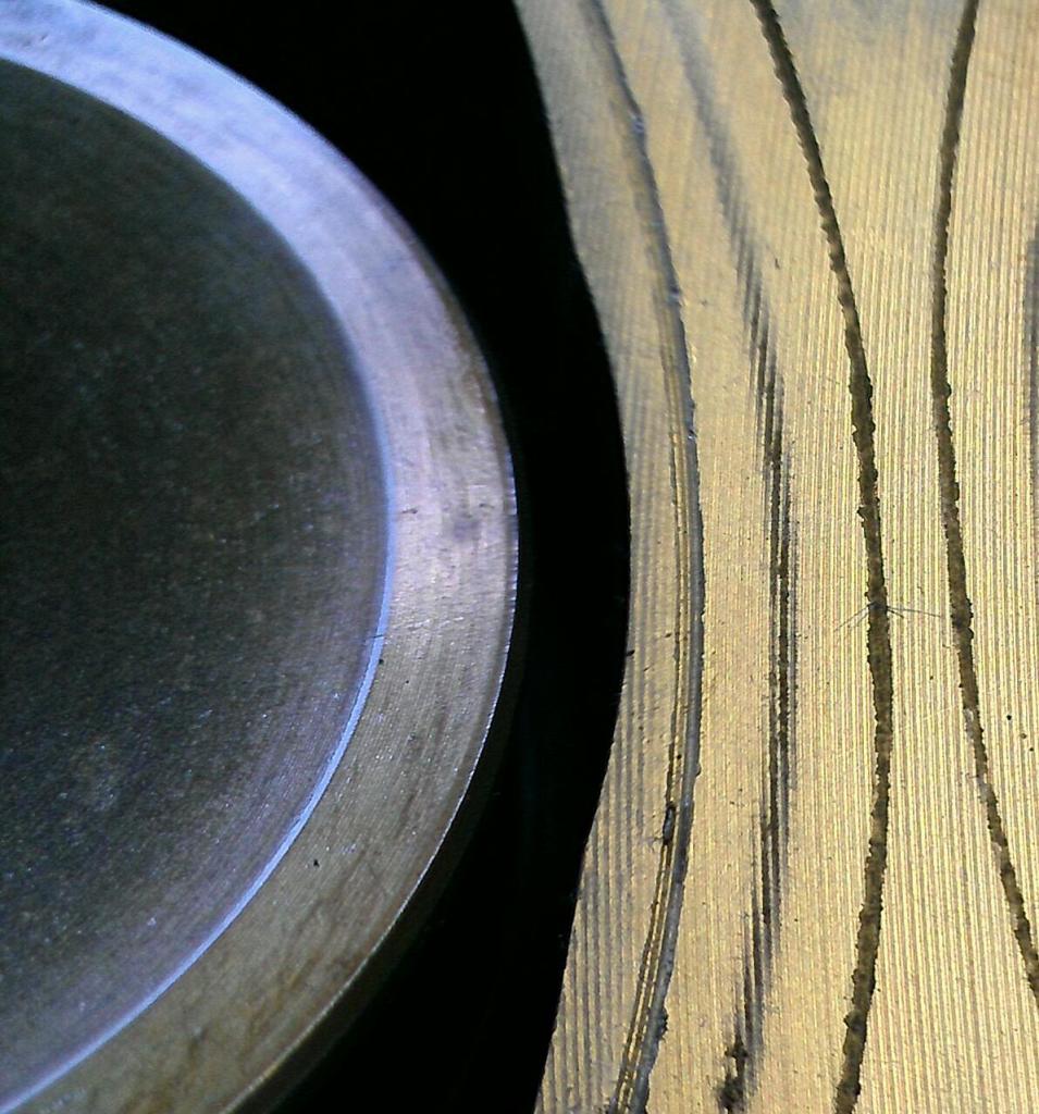

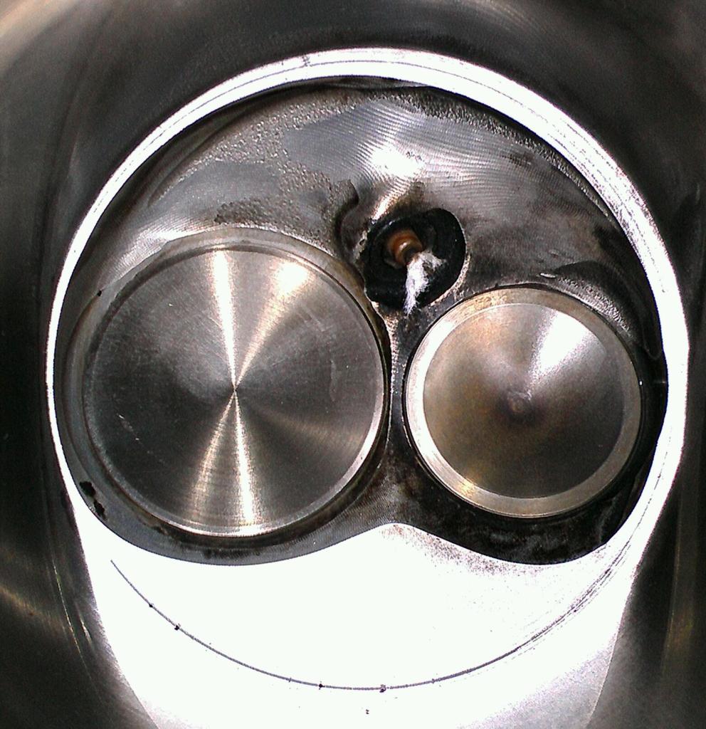

I will take a better pic tonight of the head off the block. I scribed the outline of the cylinder.
Old Jul 24, 2012 | 04:53 PM
Gadgetized's Avatar
Joined: Jan 2010
Posts: 3,095
From: Rochester, NY
From the side of the exhaust valve to the side of the CNC'd chamber it is .078". If I opened it up to the 4.030 bore it would be .138". The intake side would be .1575 if I opened it up to the 4.030 bore. I just think it could add a little more airflow. According to my math if I am doing it right, it would have only left .011 away from the stock 5.3 cylinder wall. I wonder if flowed on the stock 3.779 bore if the larger valve would even help.
