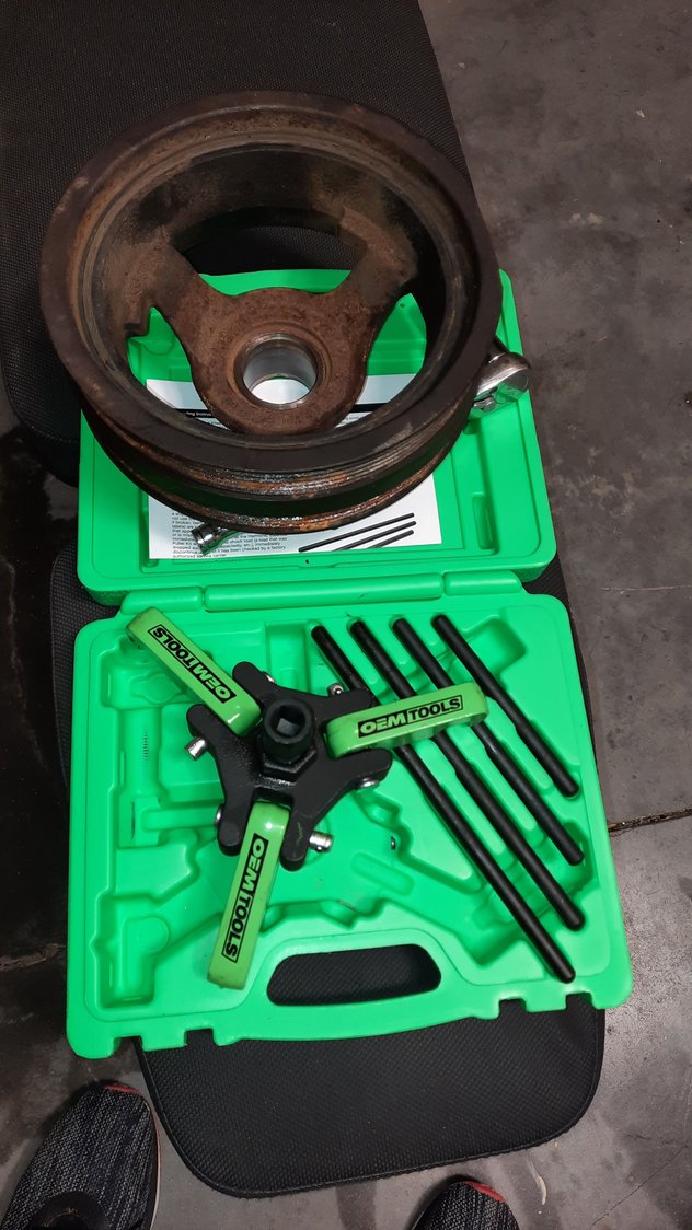

An actual harmonic balancer puller worked perfectly.

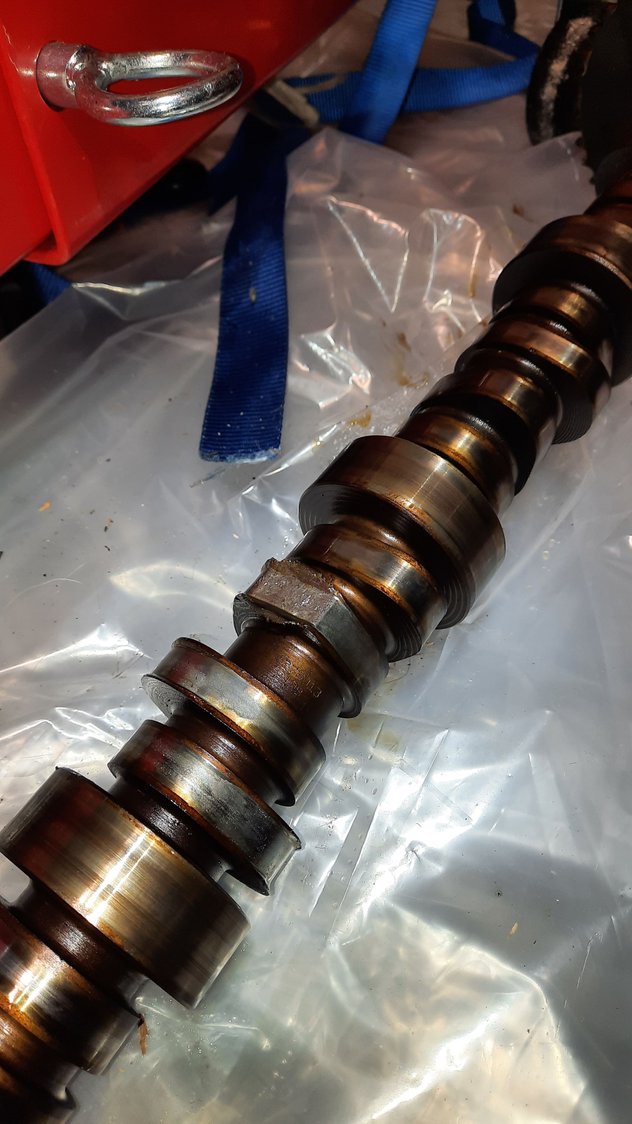

Cam damage. I assume this is from the lifter roller skating on the cam, this is evident on a few lobes. Good thing I wasn't planning on running a stock cam anyway.

I wondered how this tool would do, got it off Amazon. I like it and it worked great. Waiting on a mic set and dial bore gaige to come in the mail.

OEMTools is awesome. I have a harbor freight puller though lol
