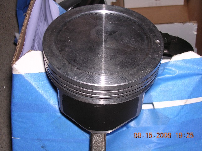

Going to up grade rod bolts for Insurance... whats an extra $75 at this point for some ARP bolts. Pistons I ended up with are basically a stock replacement type from silvolite but they have whats called an anti Garfell coating on them. I probally didn't spell it right but any way I think there better then a stock un coated piston... Mahle also makes stock replacement type pistons for these motors. I actually asked for those but the other is what came so I just went with it... Mahle I was told actually makes the Pistons for Gm for this aplication. I can try and get you pick if you can wait a few minutes. I got to dig them out....

Here I snaped a few pictures and resized them for the forum.
