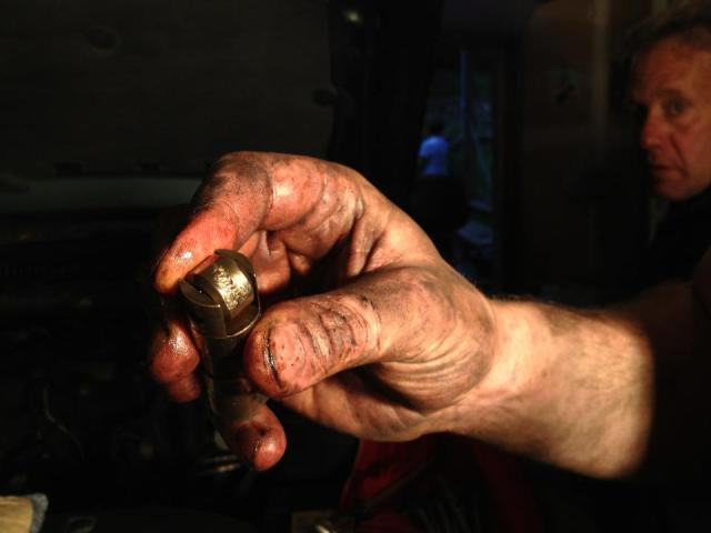

My Girlfriends 2004 1500 z71 with a 5.3 ate a lifter and it ruined the cam shaft too,

I have been doing a lot of studying the past few weeks because of my misfortunes. Your picture looks just like my lifter on my 06 avalanche z71. I would love to know what is causing this. I have a buddy in the salvage business that had a chevy truck with 26,400 miles that I was able to buy the motor for a 1K. I thought it was a great deal. I am intrested in rebuilding this motor and maybe install in a 89 YJ Jeep I have. I may even put it back in the avalanche and put that motor in the jeep. How did your cylinders look? Mine had no ridge at all and I can still see the buff pattern in the cylinder walls. It had just over 94K miles on it. Alway's changed oil regular and used Castrol 5w-30. I ordered a nice engine stand from Jegs that I should get tomorrow so I can finish tearing the old motor down.

I forgot to ask was that motor making an odd scrubbing noise? Like a chiping sorta? It drove me nuts trying to figure out what it was. I have a friend with a tahoe and his is making the same fuss. His has random misfires just like mine did.
