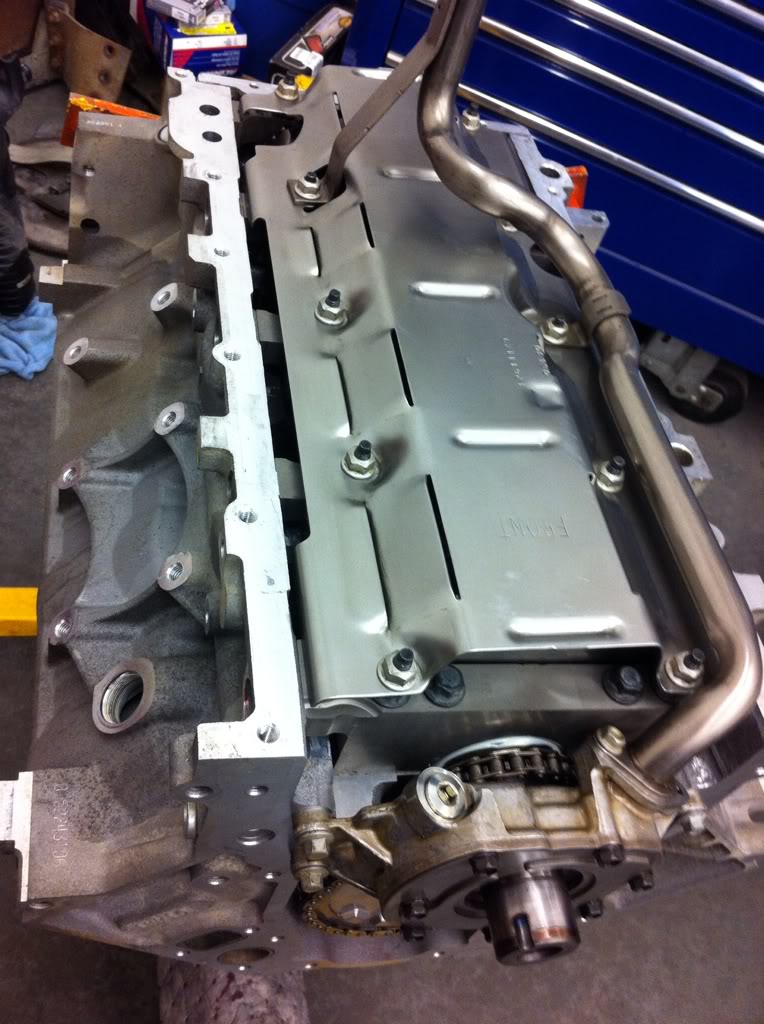

To give the OP the idea of what's in there.

Aklowrider, Perfect pic thanks. I guess the old statement a pic is worth a 1000 words, is true haha
