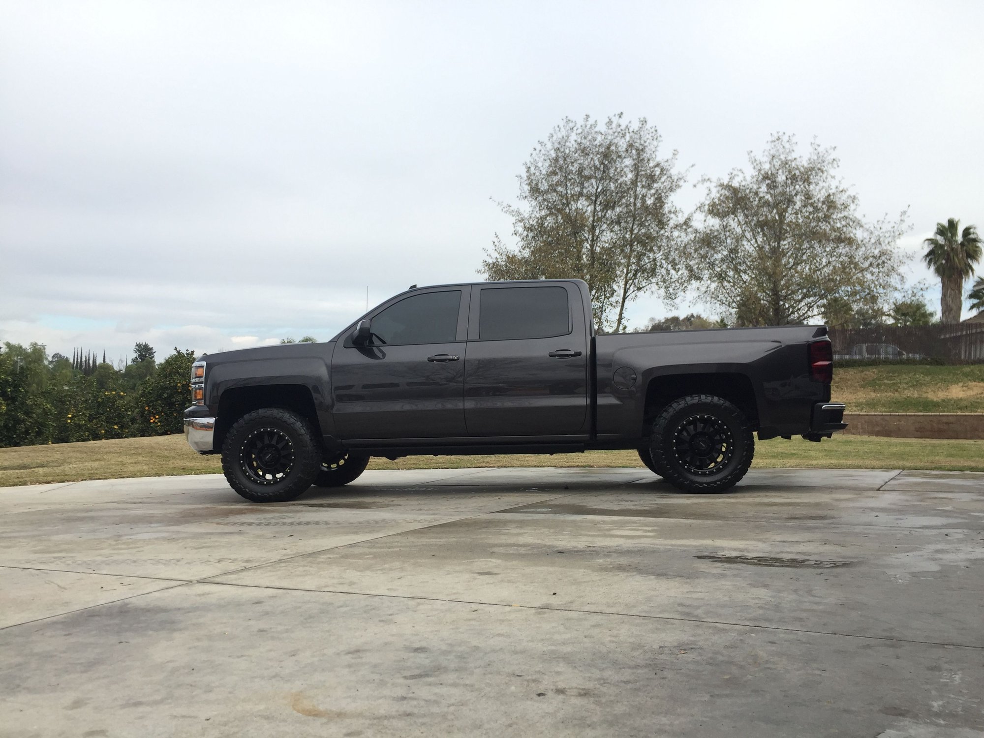

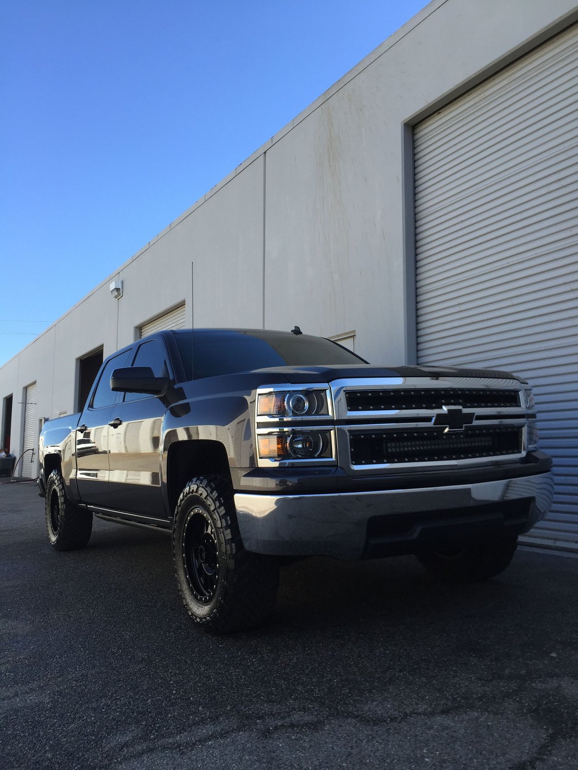

Hello, My Name is Andrew. Been on here a while, and figured i might as well post my thread about my truck and build since there isn't a TON of information on these DI Motors. I have a CCSB 2wd 5.3L
Current mods:

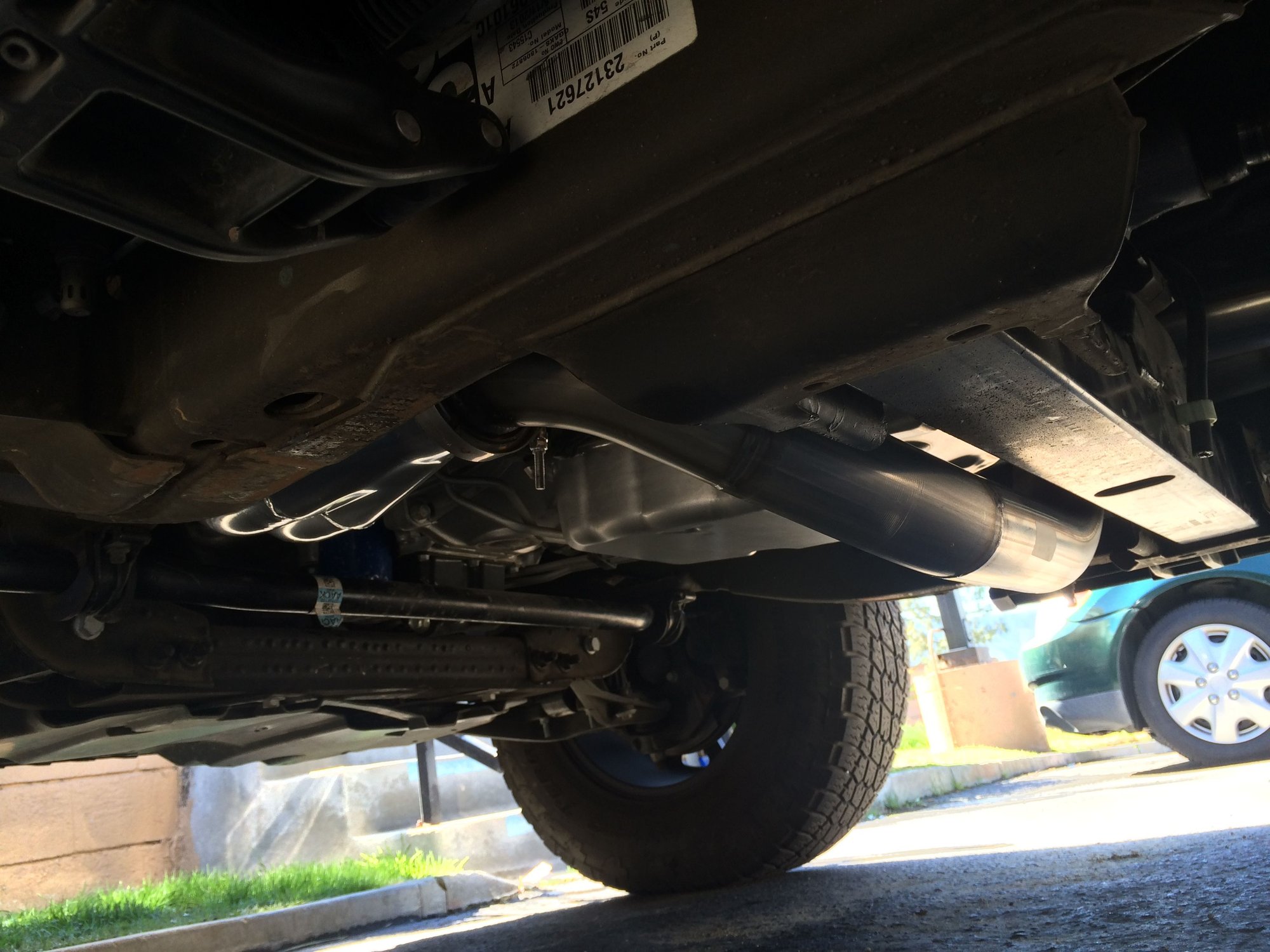

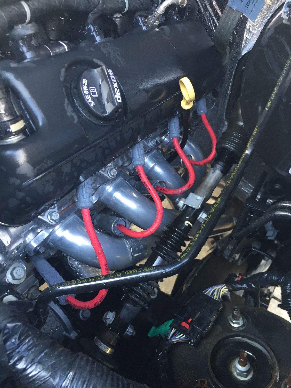

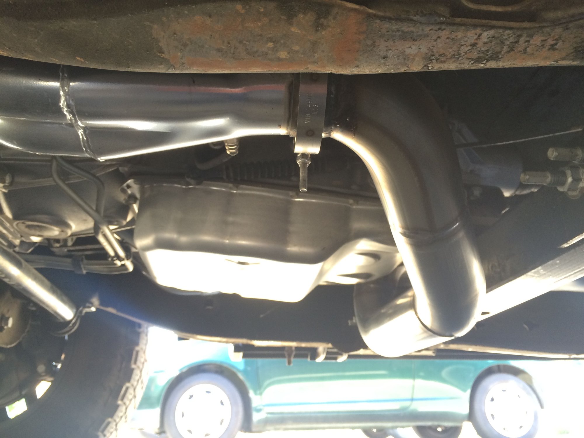

Long tube headers
Custom Y-pipe & cutback with Corsa sport muffler
AFE Stage 2 Momentum Intake
MSD Plug Wires
Elite E2 catch can
Brian Tooley 180F thermostat
Tuned By Ryne @Cunningham Motorsports Flex fuel 91oct & E85
Truck made 334/370 (91 oct) at the tires on a Mustang Dyno.
Truck picked up 22HP & 26TRQ with E85 on same Mustang Dyno!
Ill try and keep this update as much as i can. But I don't always have a ton of free time. But hopefully everyone will get some use or info out of this thread! If you have any questions or comments, feel free to ask.
Thanks
Andrew
