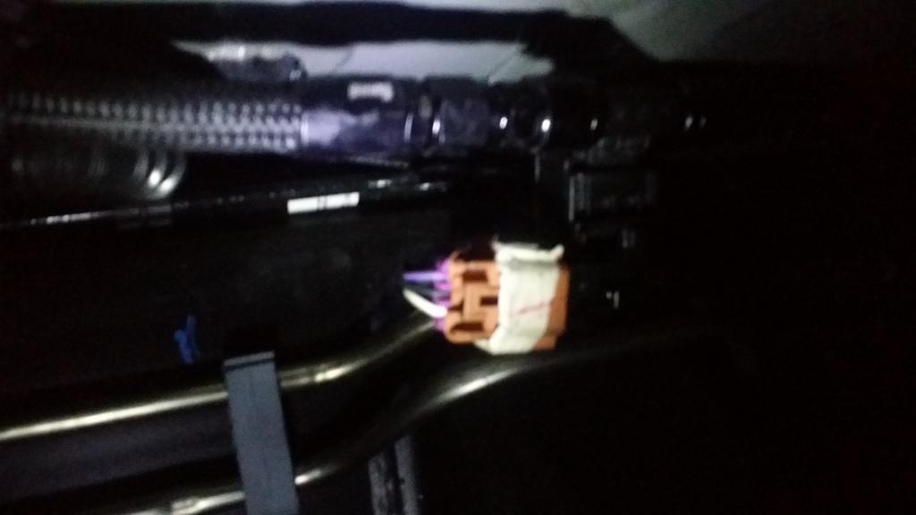

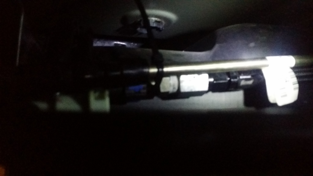

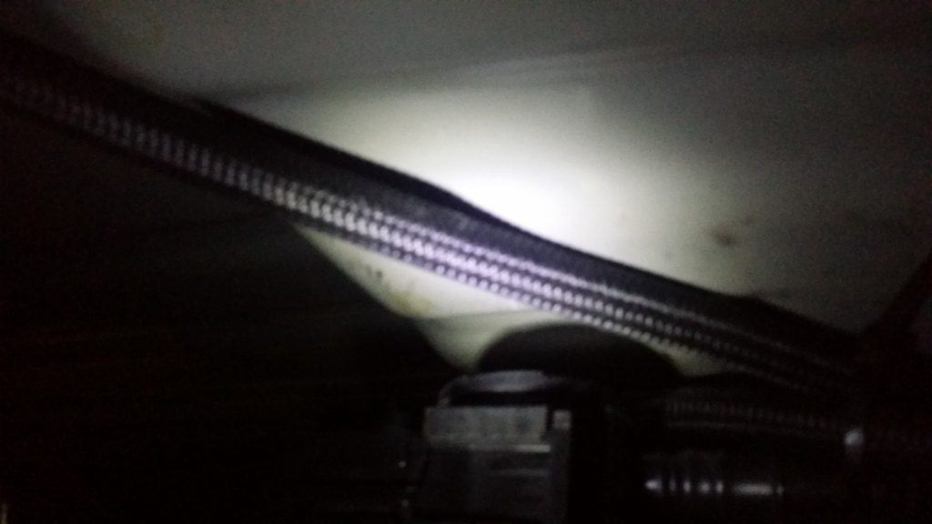

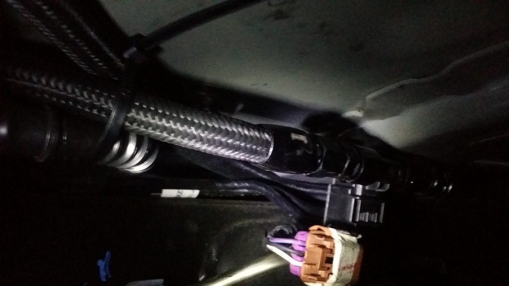

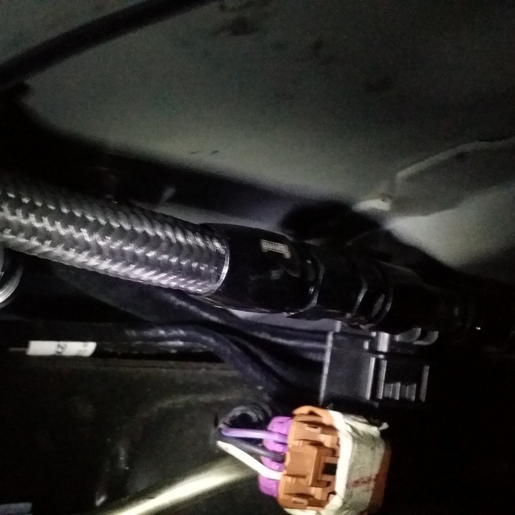

Well sorry pics don't have enough detail truck has been lowered hard to get pics*
Added all the hardware along with sensor 13577429, disconnected the fuel line(at factory clip) right over the reserve tank Which can be removed easily
then routed two half ft of 3/8 hose to sensor near plug and three ft hose to return fuel back to factory line*
All wiring is there and working just enable e85 in the tune*

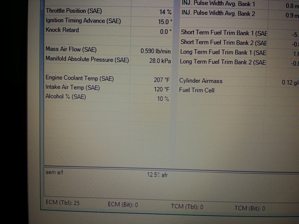

I added a alcohol % pid so with 93 octane gas It reads 10% alcohol
Next I'm only adding 5 gallons of e85 to see if the alcohol percentage goes up and then I will be running it till empty and just running e85 to see what the reading Gives there

So far mix 93 and e85 flex fuel alcohol % show what I thought it would be around after I empty out I'll refill just e85 and check it's %
Looks at pics see how the intake temp dropped 40° lower
I can feel power gains really can't wait to see how it is on full e85
