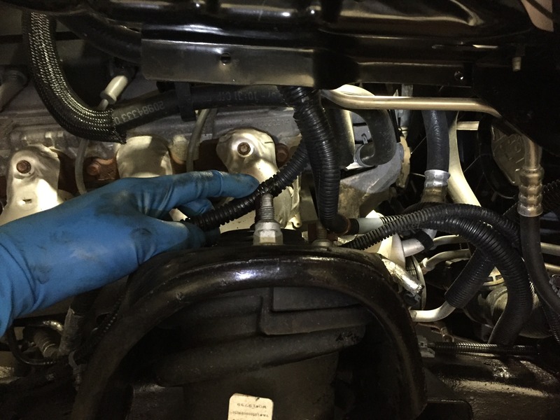

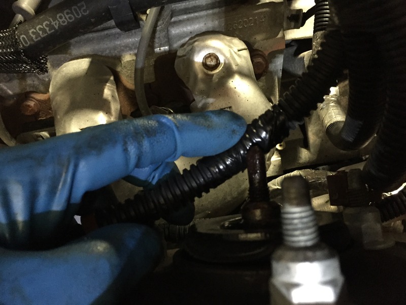

Wanted to pass this along. I found it today and thought it was really stupid. I have my wheel wells removed and am in the processes of undercoating mine, I found the starter wire in contact with the passenger side shock tower bolt. It wasn't touching the bare wire but it was already worn through the black plastic cover and into the red insulation of wire.
Check yours before you get a short. I'll try to get pictures tomorrow.

Old Jan 4, 2016 | 06:50 PM
03sierraslt's Avatar
Posts: 19,007
Likes: 221
From: Western PA
Old Jan 4, 2016 | 07:02 PM
Camaraderie's Avatar
Joined: Jan 2013
Posts: 85
Driver or passenger side ?
Old Jan 4, 2016 | 08:48 PM
Y2KLimited's Avatar
Joined: Jan 2003
Posts: 589
From: Queens, NY
starters are on the passenger side
Old Jan 4, 2016 | 08:54 PM
Posts: 19,007
Likes: 221
From: Western PA
1st post, says passenger side.

yeah good info for sure. Nothing ruins everyone's day like a Car Fire.
I believe mine has a clip right there that supports/restrains the wire, its actually pushed onto the strut bolt...brown colored plastic clip....maybe blue...
I'll pop my hood and see if I can spot it...I'll snap a pic if I can.
Old Jan 6, 2016 | 06:04 PM
Jordan927's Avatar
Joined: Nov 2009
Posts: 419
From: Victoria BC Canada
That's the best shot I could get...but it looks like its braced the aftermost brown clip. Do you have this one on your truck? Or is it just tied looser?
Top of pic = Aft of truck
Old Jan 6, 2016 | 06:19 PM
Posts: 19,007
Likes: 221
From: Western PA
Mine has that but mine was resting on the shock bolt.
