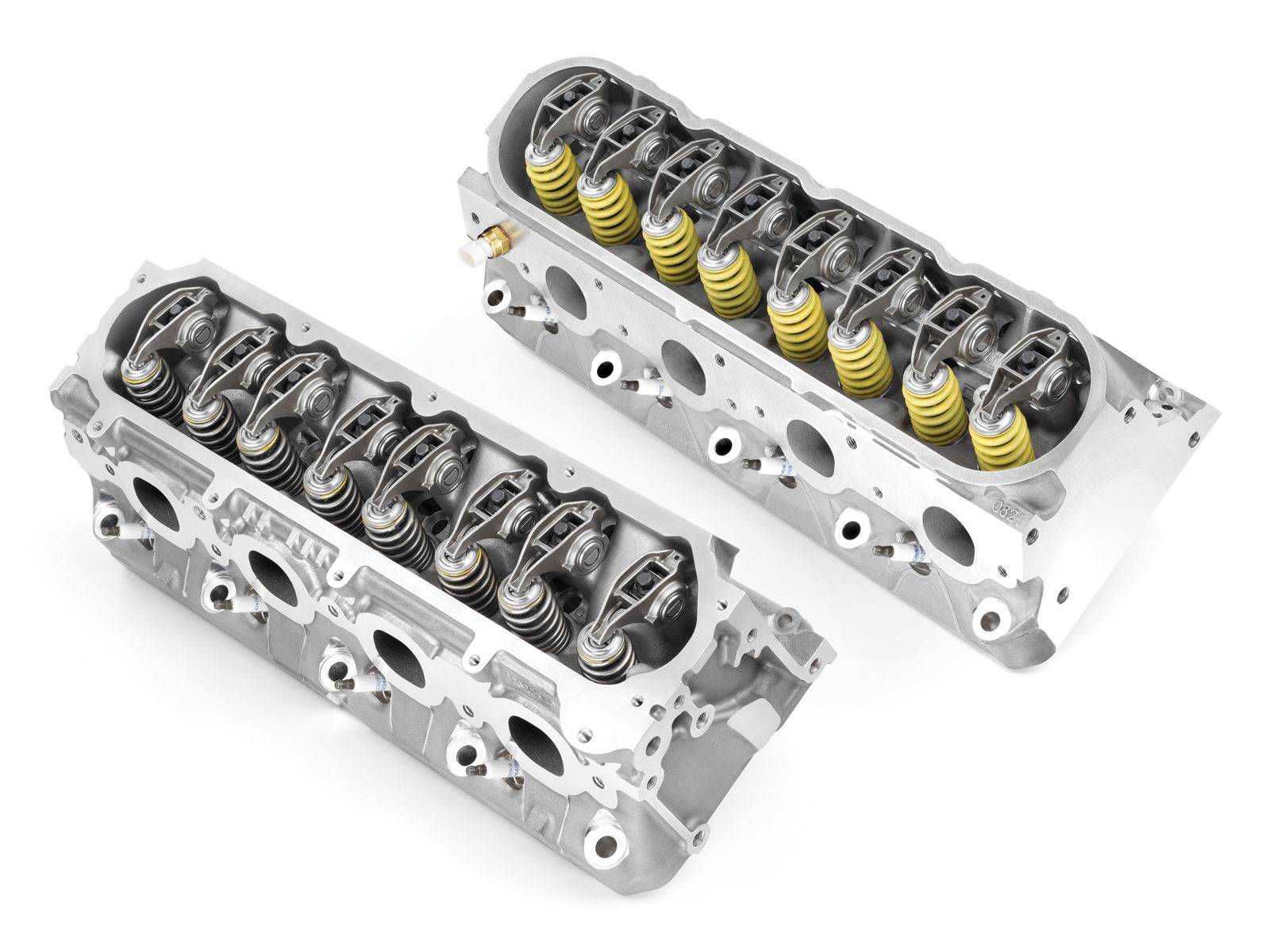

Sorry this was on the LT1,not sure if all the LT engines are the same
Intake valves are 12.5-degree angle from vertical & 12 degrees on the exhaust
Attached Thumbnails LT engine rocker arm setup-gm-gen-v-lt1-engine-gen-v-vs-gen-iv-valves-top.jpg
