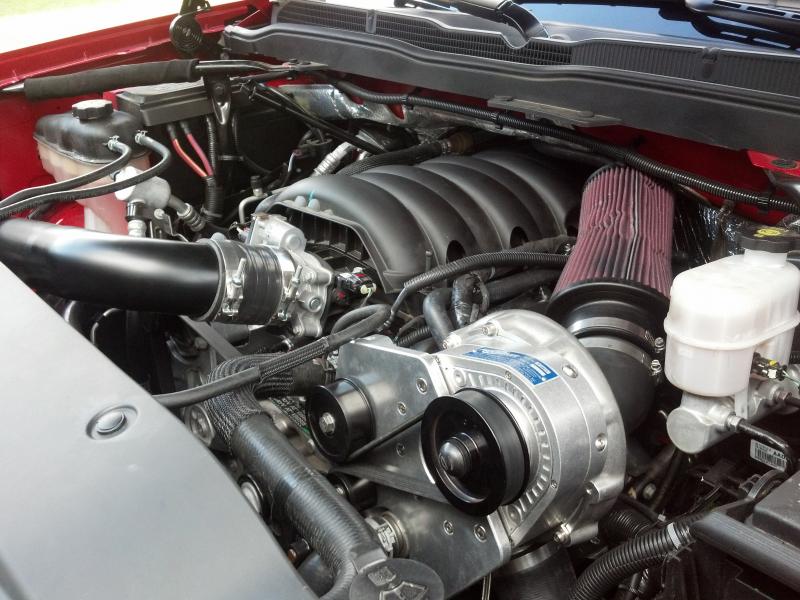

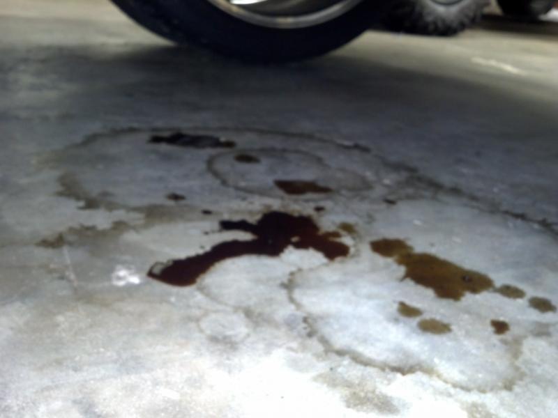

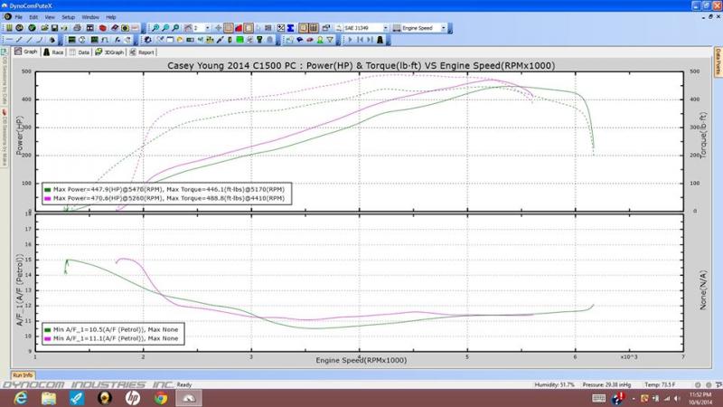

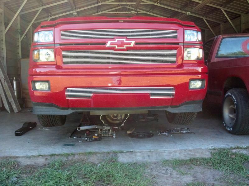

Well i finally got my ceramic coated pacesetter long tube headers and my P1SC procharger on and tuned. And on the way home from the tuner I got in it pretty good and blew out my rear main seal because of a kinked pcv hose...... Anyways... I pulled the trans and put a new one in and finally got to enjoy it some. It put down 470rwhp on 6psi through my 24" chrome rims with 295/35/24s on a safe tune. Not bad for a stock truck on heavy *** rollers.
And on to the pics!

The dyno sheet. Nice torque curve.

FML!

Not what you wanna be doing after a blower install.

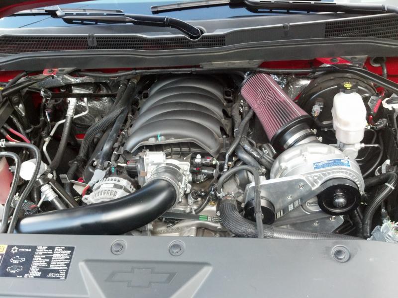

The meat and potatoes!

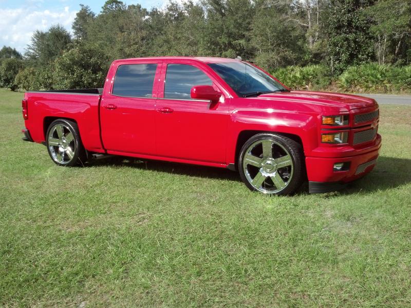

And the truck.... On shine of course!

Awesome numbers for 6psi, what AFR was it tuned to? Having a hard time seeing graph. Just curious with the direct injection.
Old Oct 21, 2014 | 10:46 AM
kc'skustom95's Avatar
Joined: Apr 2008
Posts: 132
From: Folkston,Ga
It stays at about 11.3 the whole run. He put timing in it until it lost power without any detonation! You can get very aggressive on the tune with these new direct injected motors.
