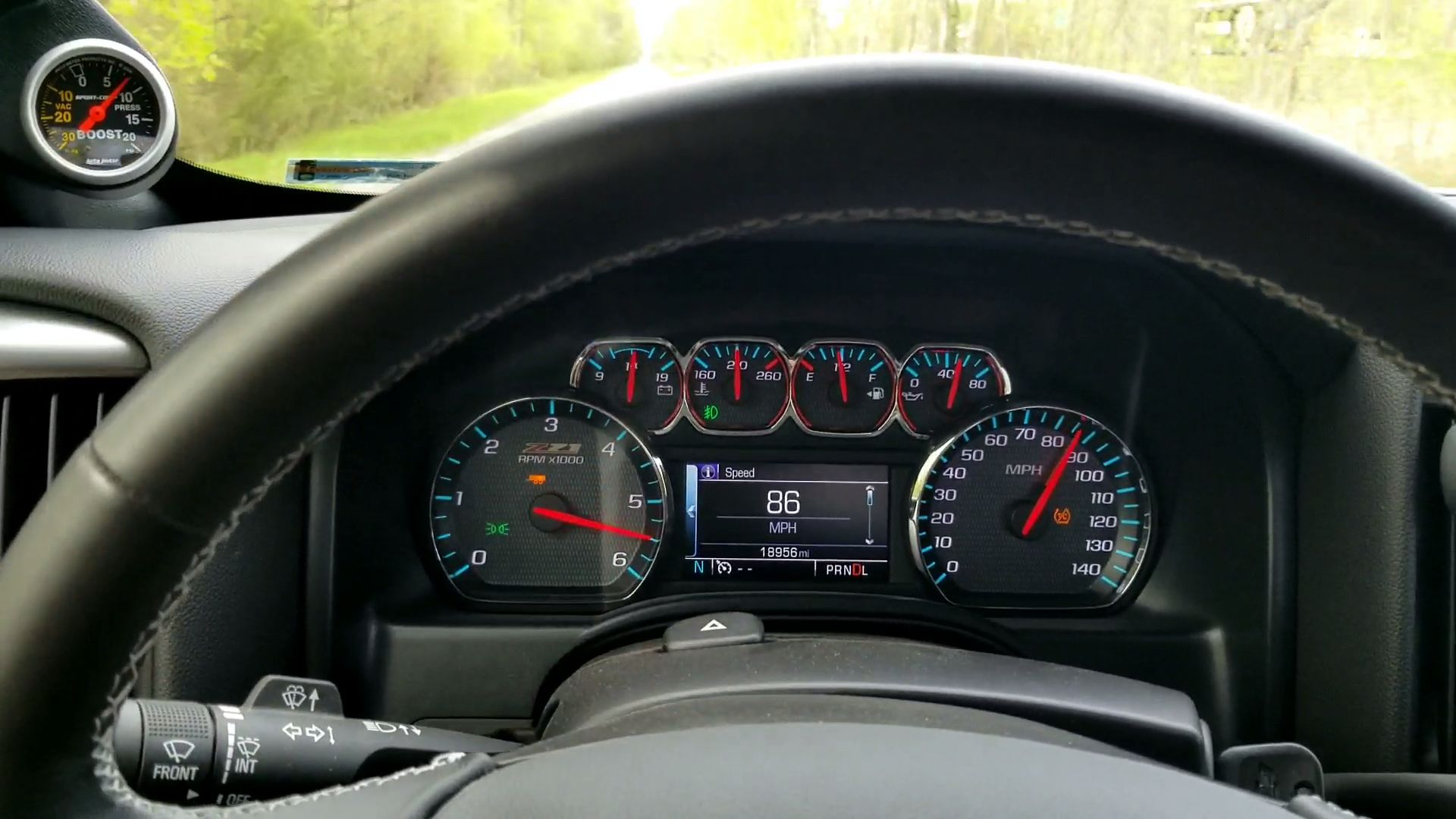

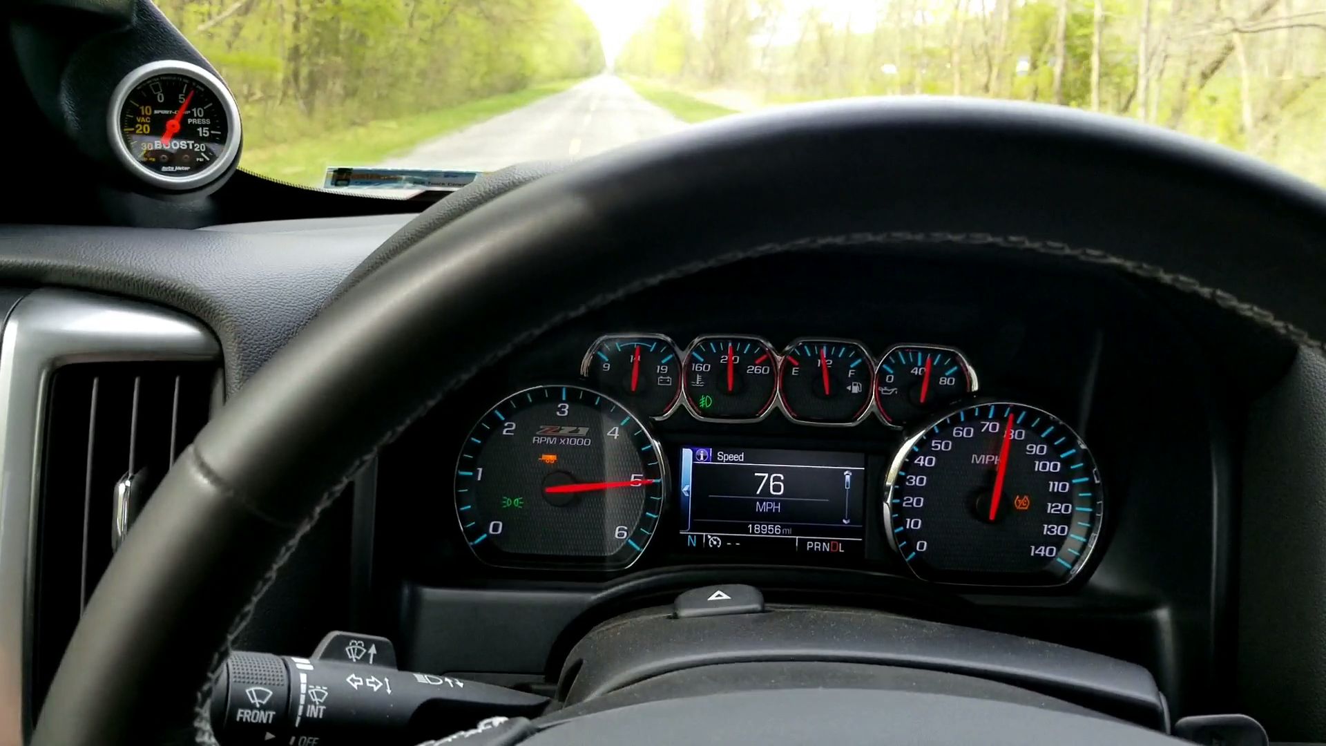

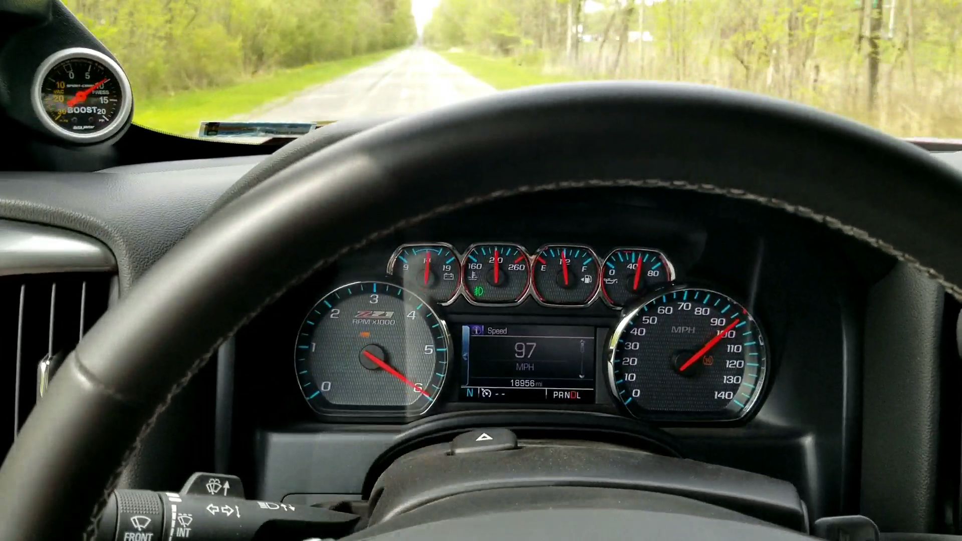

Yeah should be good. I really need to get headers to open things up. Here is my boost vs RPM taken via vid cap.

Hey buddy am i seeing it right ,you are not at full boost until max rpm?

Pro-chargers need the rpm to make boost, so it will be at it's highest value right before it shifts into the next gear or redline.
For sure is different but kinda cool. Not always do you need the 10psi so just rolling through the gears at medium throttle can be 1-4psi for an extra bump.
You are. The surge system on the ProCharger kit for the GM trucks is designed to stay open till 3500rpm. Anything under 3500rpm the truck sees 0 boost. At 3500 rpm it starts at 5psi and as you saw in the pictures will go up to 10psi by 6,000 rpm. My shift points are set to 6300 rpm so I am at 10psi for only 300rpm. I had the converter installed prior to getting the supercharger. Being it was a 3200 stall that is why I went with a centrifugal supercharger instead of a Whipple or Maggie. One thing to keep in mind I did get the tuner kit from ProCharger and when I ordered it I told them I had a 3200 stall and I wanted a max of 10psi and what my shift points were. I am not sure if you got an off the shelf complete kit for the GM trucks if the surge systems still stays open till 3500 or mine is setup from ProCharger that way because I told them the truck had a 3200 stall.
