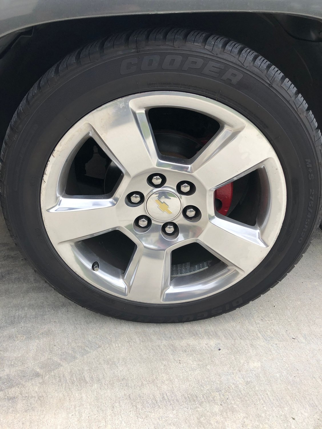

Well. Tried one with the face milled off. Still hit near the inside radius.

My bad. Didn’t mean to ignore ya. Just had another kid. I’m in Bradenton, FL. North of Sarasota, south of Tampa. Yeah, plethora of wheels around but with the kid and pending deployment comin up, I can tell ya I just won’t have the time to chase wheels. I’ll take photos and do what I can as in have the spindle mock up available for dudes who wanna test for before buying locally. And of course document and photograph what I can.

Found another that will NOT fit without a spacer. 2015 GMC Denali

And from the youtube video with the red caliper shown on the preview by "RedRum Rx7" (
) shows what appears to be this wheel requiring a 1/4" spacer to fit

Originally Posted by S-smith29
Hey I’m not good on all the lingo of what wheels are called what just wondering if these wheels will clear the 4 piston caliper and bigger rotor upgrade? I think it’s the 2021 Escalade swap I believe? Any help would be appreciated.
So, the snowflake wheels, the 22" ones at least in this video, do NOT fit. Not sure if there was anything different about the offset of the 20" ones you have but with the information we have, looks like you'll need a spacer.

I can say without a doubt these wheels will NOT work, even with 1/2" worth of spacers.
