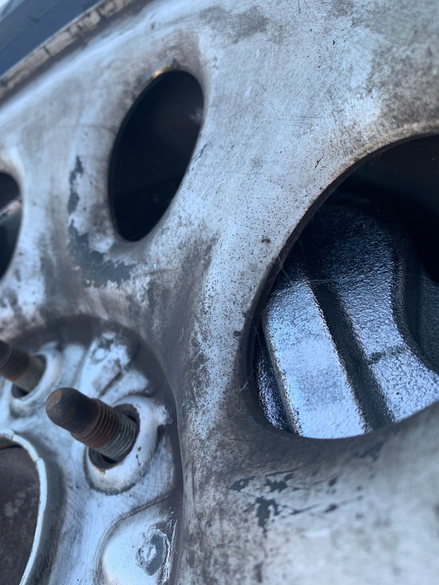

I know of a guy who ground the **** outta that area to fit on a set of aftermarket wheels. Seemed to work fine for him.

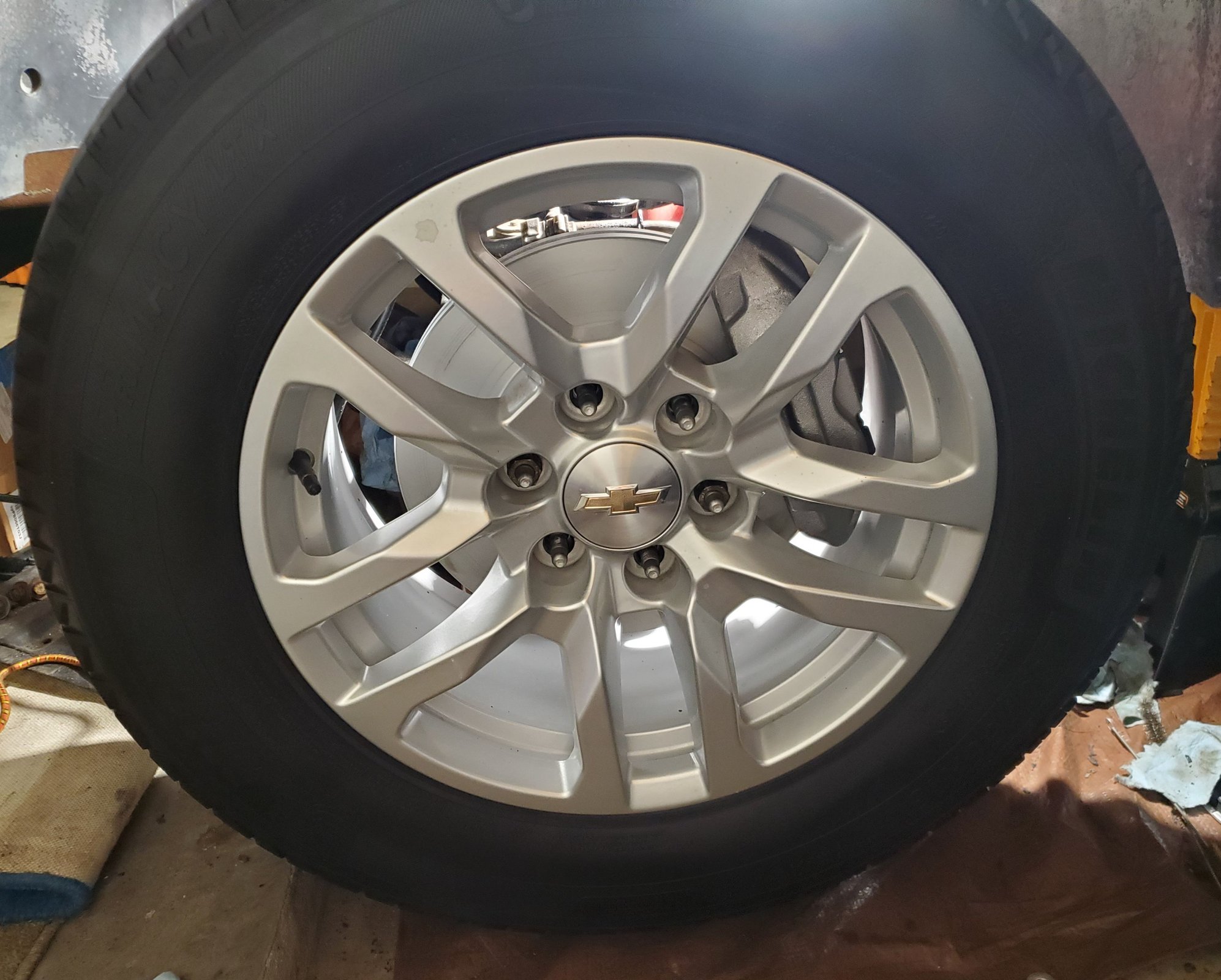

Originally Posted by ZBrink
I can confirm that this style of 18" OEM wheel does NOT fit over the four piston calipers on GMT800 trucks without modification. The wheel hits the bottom of the caliper in a weird spot. I think you would need at least a 10mm (3/8) or a 12mm (1/2) spacer which would then require longer wheel studs, etc. I'll admit, I was super disappointed because this wheel looks really good on the GMT800 and doesn't look "out of style".
I just picked up 3 of these at PnP hoping they would. I would expect some people are going to have trouble differentiating the two. Both are 18 x 8.5. Both are RPO code PZX wheels. The first ones came on 2014-2018 K2XX. They may also be listed as PZX Classics, or 18" Double spokes. PN 37420001
These second ones that here are PN 77970001. These next ones were on the T1XX 2019-2021 model
Looks like they just did a slight modification to make em fit over those calipers.

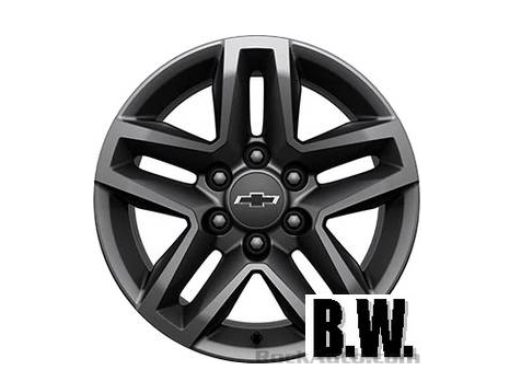

There is also this: 18 x8.5 that came on the 2019 -2021 T1XX (Might be denali) RPO Code RD1. That PROBABLY SHOULD FIT.

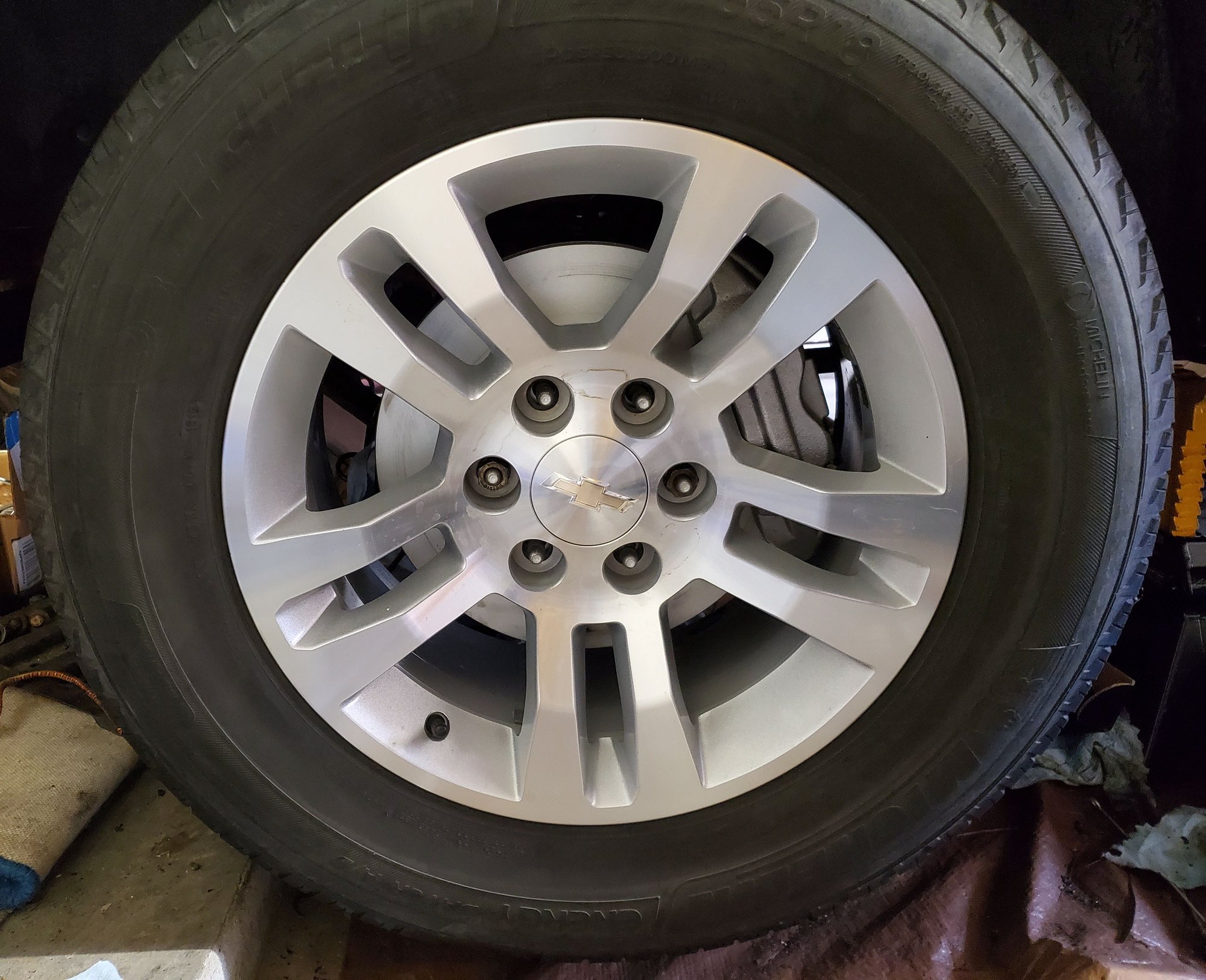

I can confirm these 18" GMC AT4 wheels do fit GMT800 trucks without modification. Here they are on my 2000 GMC. They are GM part #23376220 or 23377014.

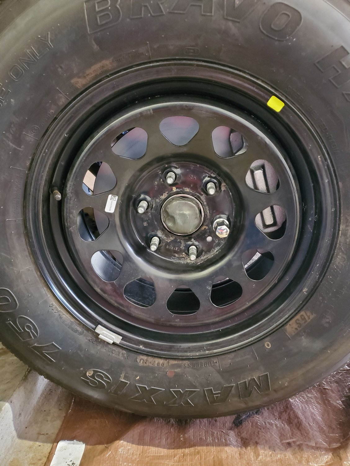

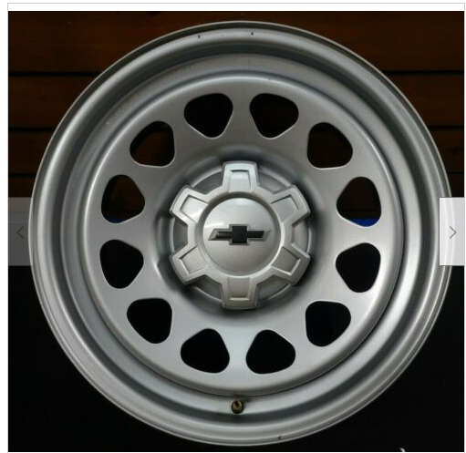

From: Fairfax, VA
I can confirm these 17" GM steel wheels do fit GMT800 trucks without modification. Here they are on my 2000 GMC. They are GM part 84440191 (black) and 84440192 (silver). They are issued by GM as spares on 2019+ full-size trucks/SUVs.

99-13 ish spare tires do NOT fit without a spacer. The next batch I get in I’ll mill down the face but I stuck em on a bare 2003 spindle I had.
