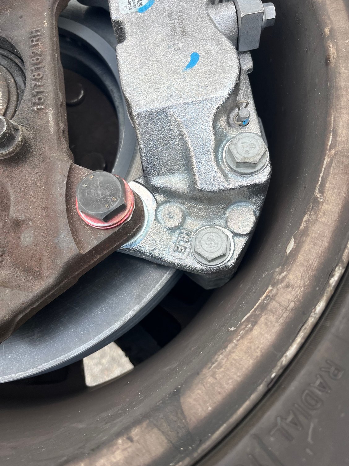

Looking for anyone who might know. Got a guy with interchange "5299" (GM PN 9596050 )wheels, 07-14 5 spoke with the indent. They look like they have more clearance around the hub from what I see but anyone have experience?

Post 84 and this post are the same. Just showing it does NOT fit inside the wheel itself.

These will need a .250" spacer to clear OR just grind the corners down a little bit.

Originally Posted by Fresh_Mutz
New member here. Happened upon this posting and collecting parts for this upgrade. Anyone try these wheels? Mine are 20x8.5, 31 offset from oewheels.
Found an answer on this. They will NOT clear without a 1/2" spacer.
