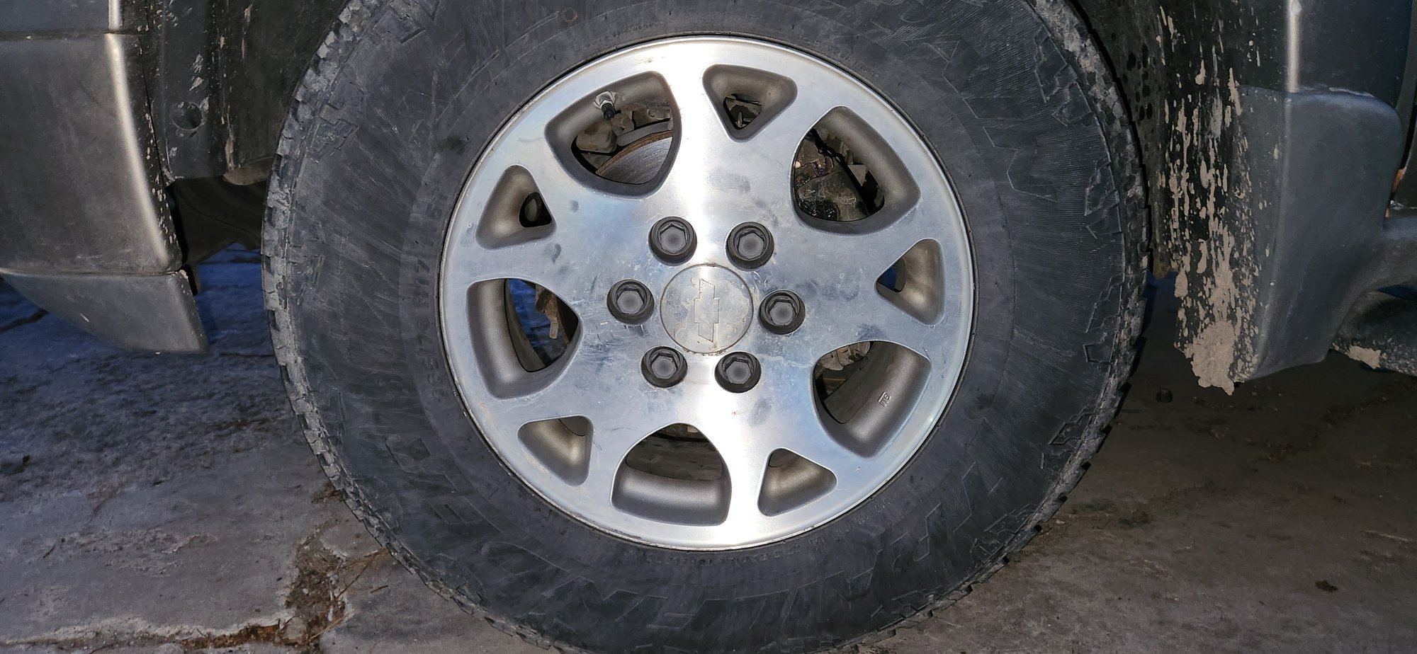

Here to confirm the Z71 package Suburban/Tahoe wheels do not fit. Pretty bummed about it. Hoping to find something to replace them since brakes and tires are on the way out.
Yeah, we can speak to most certainty that nearly all of the 99-06 wheels do NOT fit except a set of Escalades I think.

Sad to say the 17" steelies don't fit. Mighty close though, probably would with some grinding or spacers.

You can definitely see a difference in those 2 steelies. The new ones have a pretty clear offset from the hub face to spokes while the old ones didnt.
