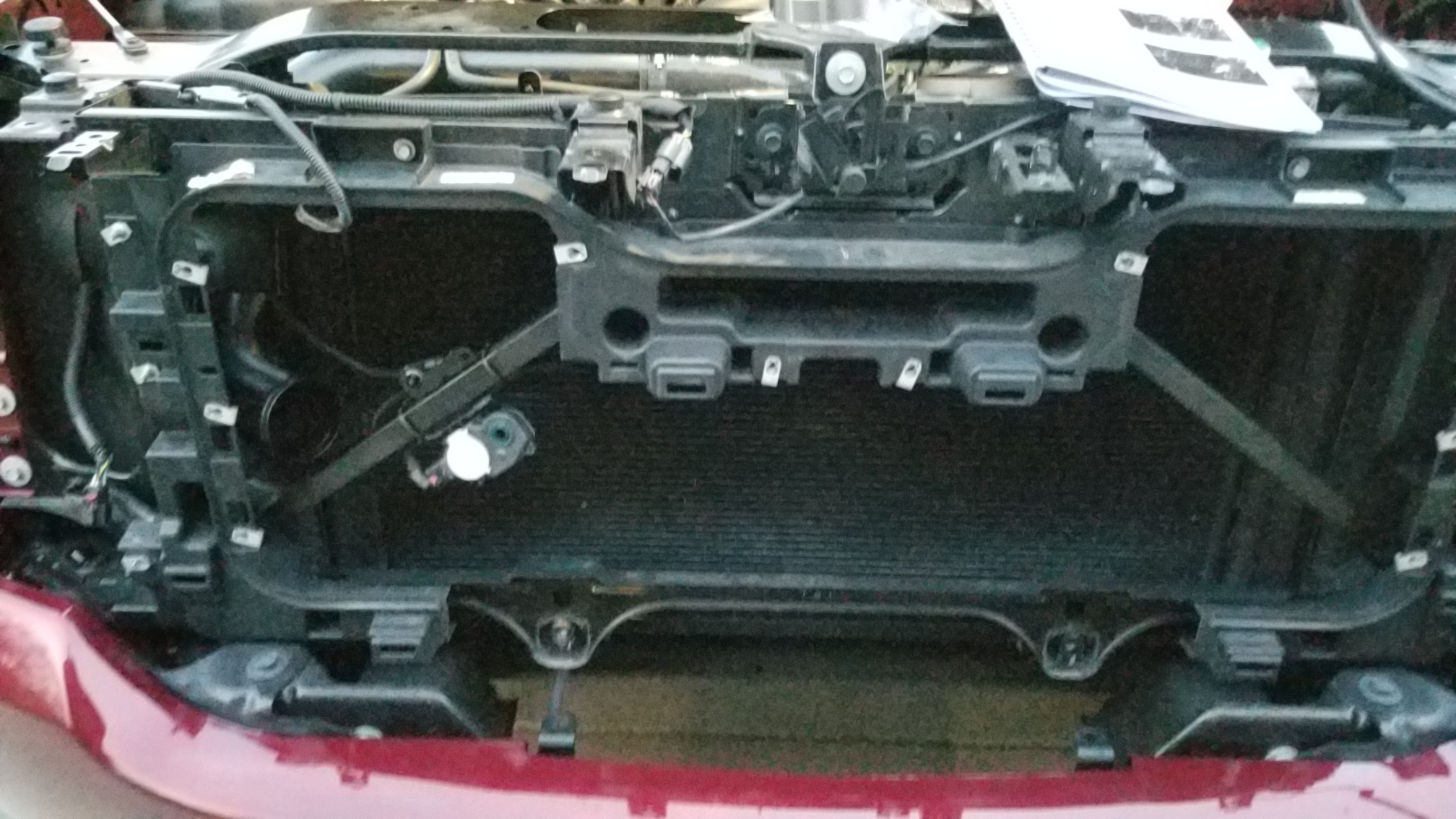

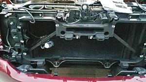

What did you do to remove the active grill shutters? Did you remove the whole thing and put the motor back in with stops to keep the CEL off?
I just put a 180 thermostat in the other week in my truck and rarely see any temps over 195 on the hottest days.

I will post the picture of how ProCharger has you mount the motor. The only way to not get a CEL is to have the trouble code disabled in the tune. Good to know about the thermostat. What brand did you go with and do you have a part number?

I got my thermostat from Speed Engineering. 30 bucks plus shipping. Ill have to look into the grill shutters more, dont know if mine is closing or not at this point.

Awesome thanks. I know they close if the coolant is under a certain temp and close when you are over 60mph from what I read.

I need to get rid of mine then. Im having troubles keeping my IAT's under 85-90 degrees lately. During a pull I dont see them going over 110 so its not like Im running way hot i just want to get them as low as possible ya know. Sorry to get thread off topic.

No biggie. I did notice my coolant temp under normal driving with them removed went down.
