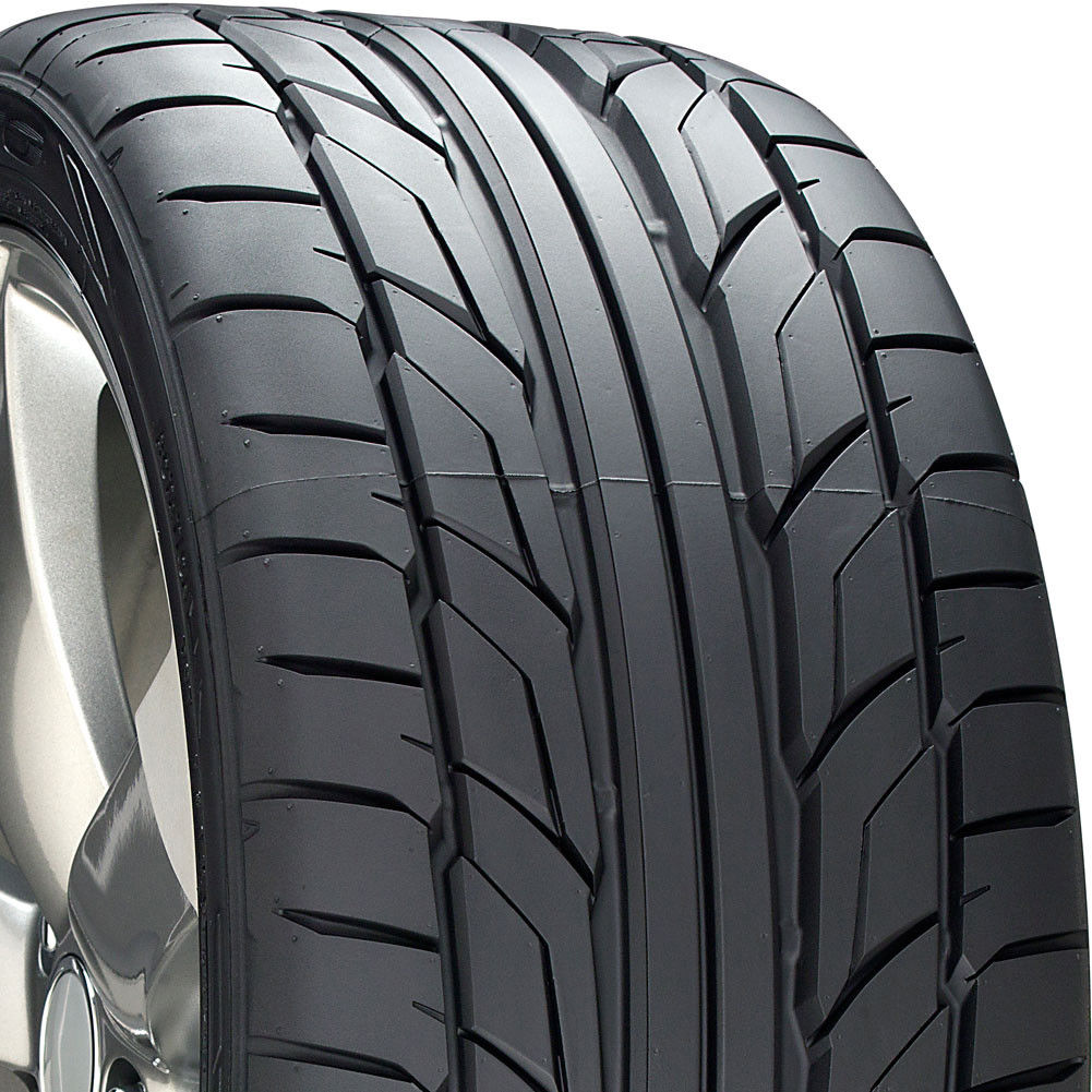

check out the Nitto 555-G2 tires, rated for 168mph
I just ordered a pair for the rear of my truck,
Discount Tires Direct, free shipping
Attached Thumbnails 17 Silverado 5.3 ProCharger 0-134 video-nittos-555-g2.jpg

That's a nice truck. Might have to go with those tires for that half mile drag event next year.
