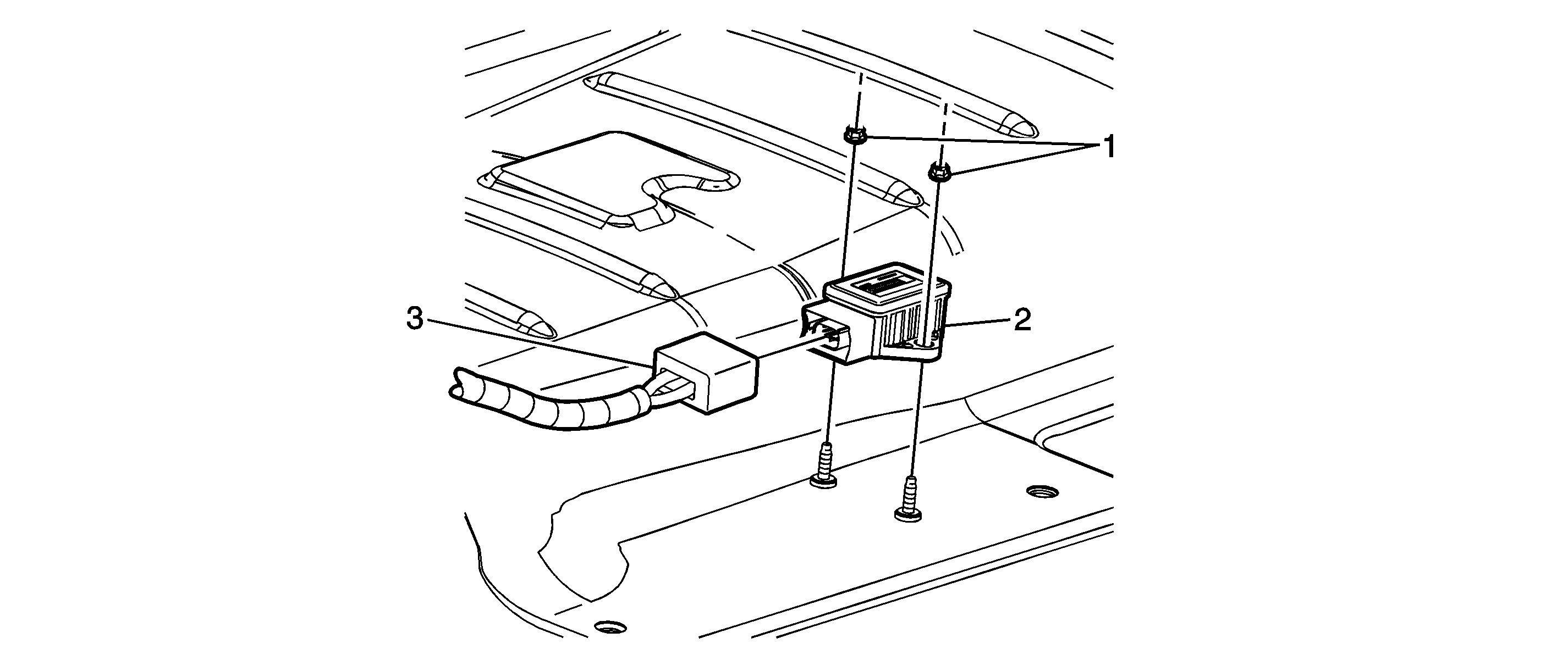

it is under the passenger side bucket, looks like this. try unplugging and see if ya get an abs light with your service stabilitrak dic message. if the abs light is not on then you have abs but no stabiltrak.

So I did a little reading in GM Service Information and found that if you open the 5v reference from the Steering Wheel Position Sensor it will give you a EBCM DTC - C0710 Sym 17 and also keep ABS but allow the EBCM to Disable VSES.
