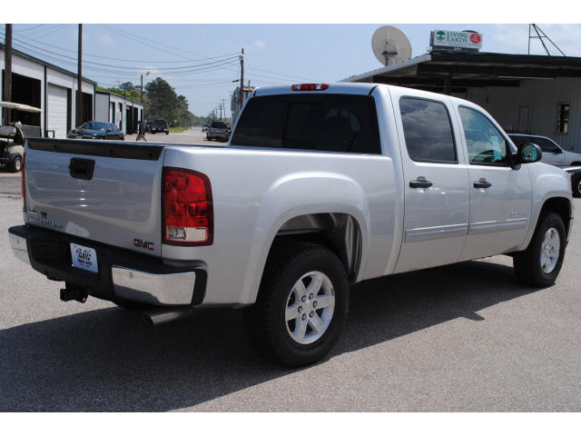

a 6.2 truck will have the tailpipe out the back under the bumper, rather than turned out behind the wheel. you may see that in a picture.

Originally Posted by Allgonoshow
a 6.2 truck will have the tailpipe out the back under the bumper, that than turned out behind the wheel. you may see that in a picture.
And to futher elaborate on that, here is a picture attached below.
