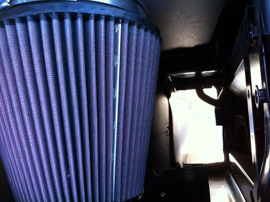

I pulled out my CAI and the original airbox tray. Cut off everything off the tray except 2" where i could still bolt down my CAI. I also pulled out the plastic piece that connects the fenderwell and front bumper and cut out the whole center and left enough to where the fender well will still securely mount with out flapping around! can really feel the fresh air while cruising down the road.
1st picture is looking down past the filter.
2nd is looking up from the ground.

I like it ... what kind of filter is that? Unless the pic color is off it doesn't look like a K&N?

It is a K&N. Part of my CAI, it's a picture taken with my Iphone and it was funny lighting. I should have taken pictures for a walk through, but i'd very simple anyone can do it. I just used a 8mm, flat head, sawzall. it was highly recommended when i got my dyno tune. Just taking the top lid off my CAI netted 5-7hp across almost the whole rpm range!
