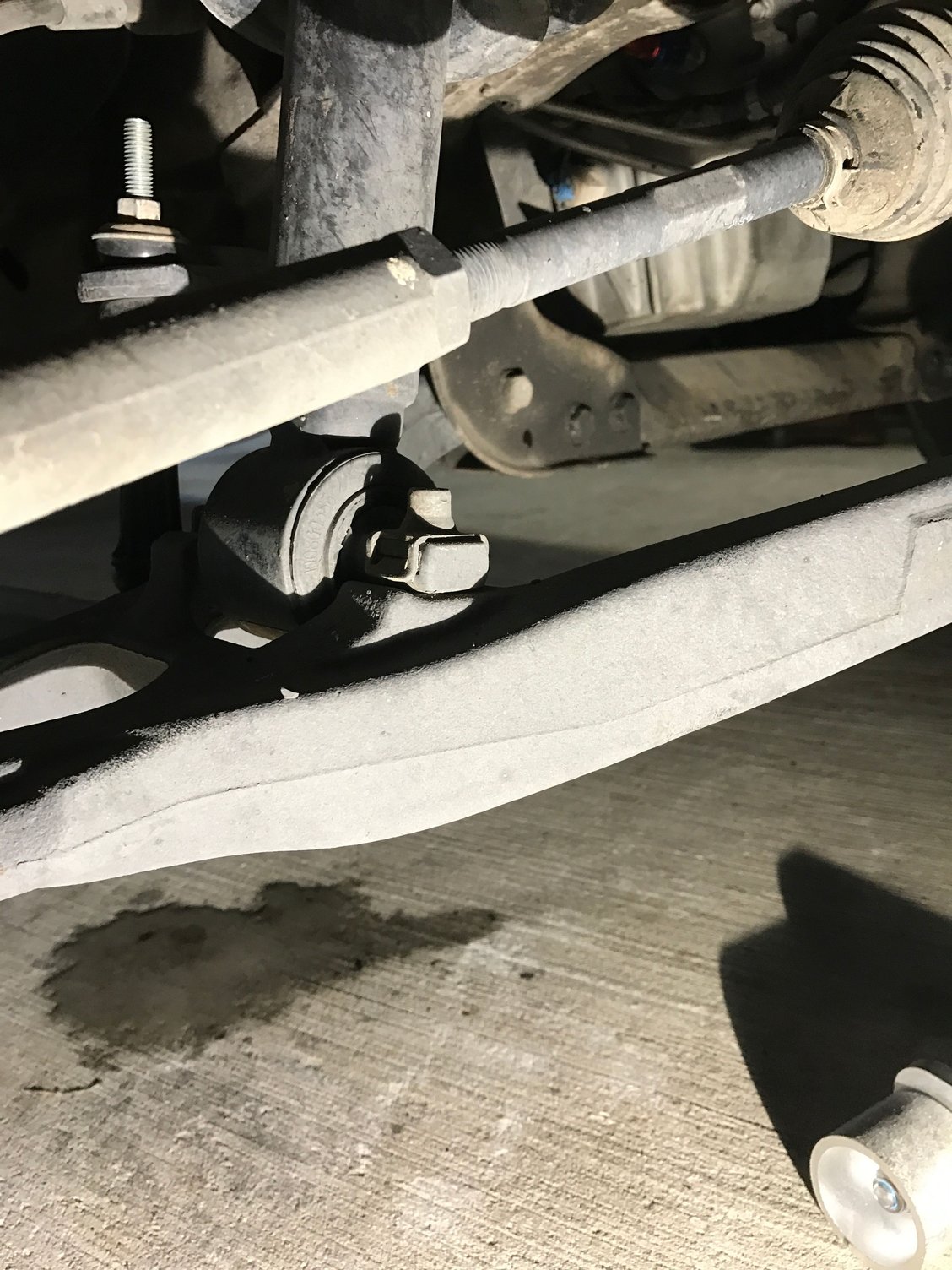

Couldn't bring myself to pay a ton if money for how little I wanted to lower my truck. I decided to cine up with a way to do it cheaply. Front struts flipped to under the a-arms and 2" shack with removed blocks in the rear. Spent $14 on grade 8 bolts, nuts and washers for the front and about $60 for the shackles and spacers for the u bolts.

Post some pics of that front end setup. I'd be interested to see it!

I did did the same thing. First pic is before second is after.

I also had to get a camber kit from rough country to get the alignment correct. I didn’t have enough adjustment left. That was probably the most difficult part due to grinding the upper control arm holes.
