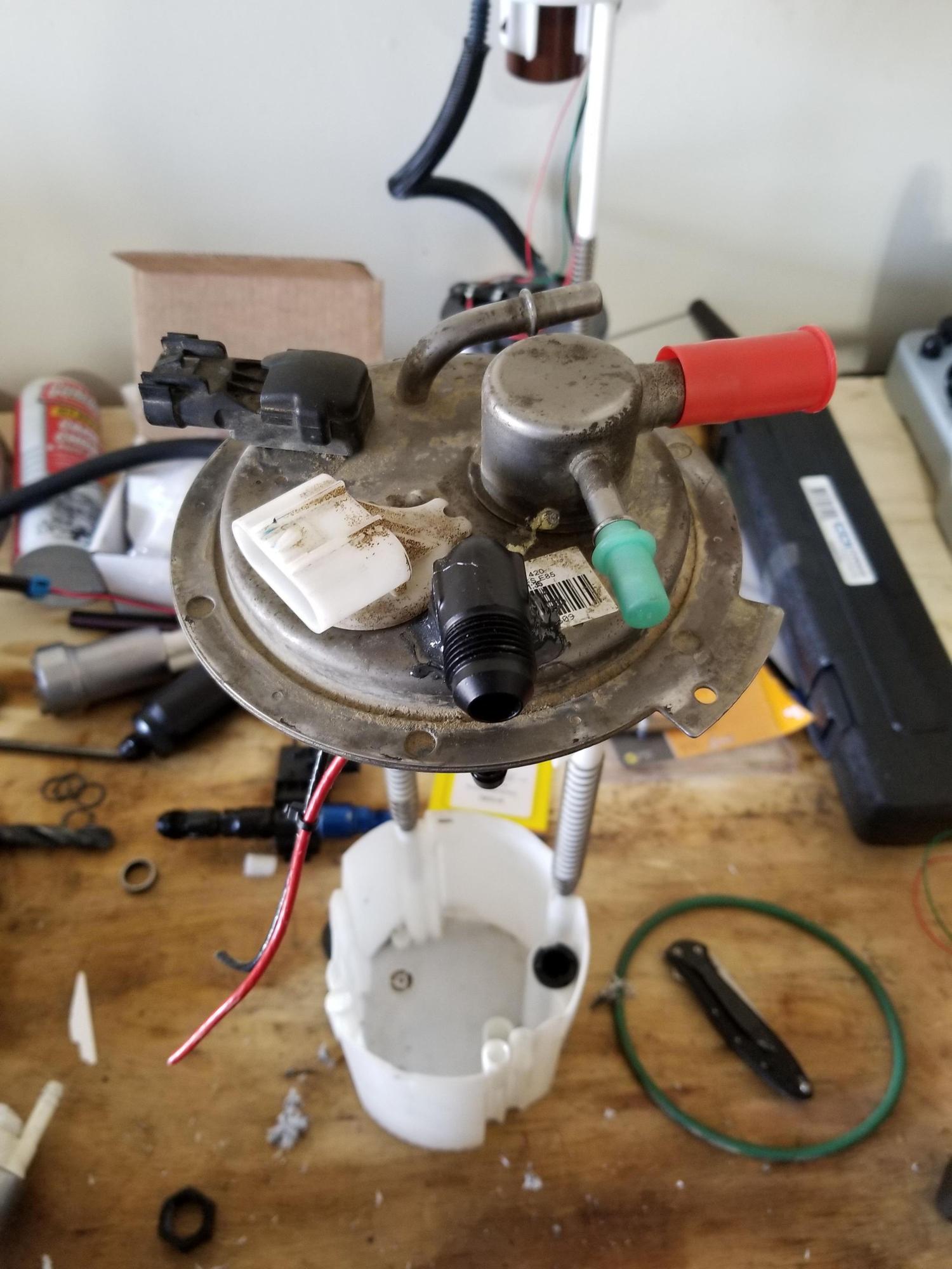

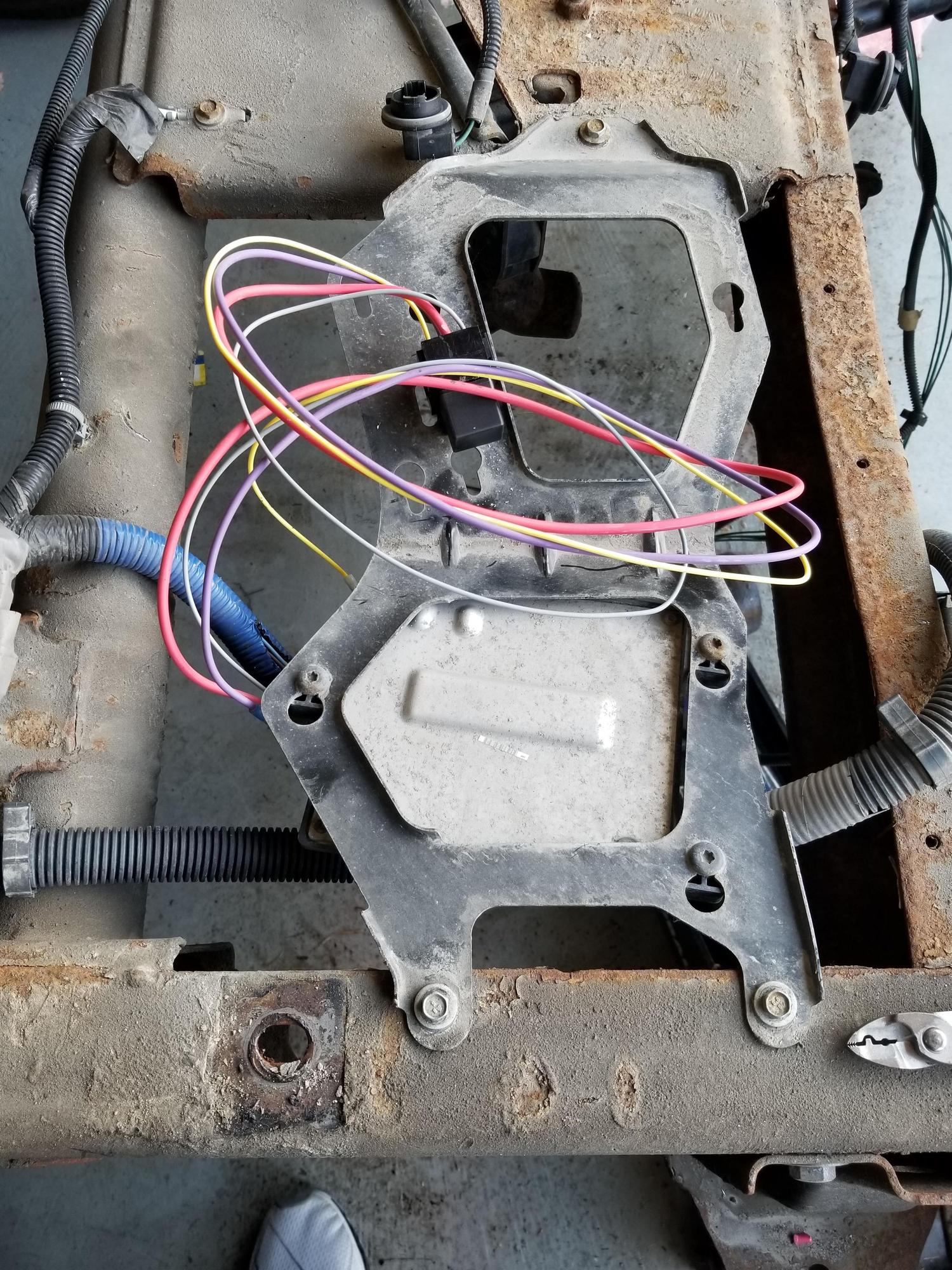

I got the fuel bucket gutted and the pumps mounted in the fuel bucket. I also got the wiring all done. I followed three6GMC thread and it seemed straight forward hopefully i did it correctly lol.

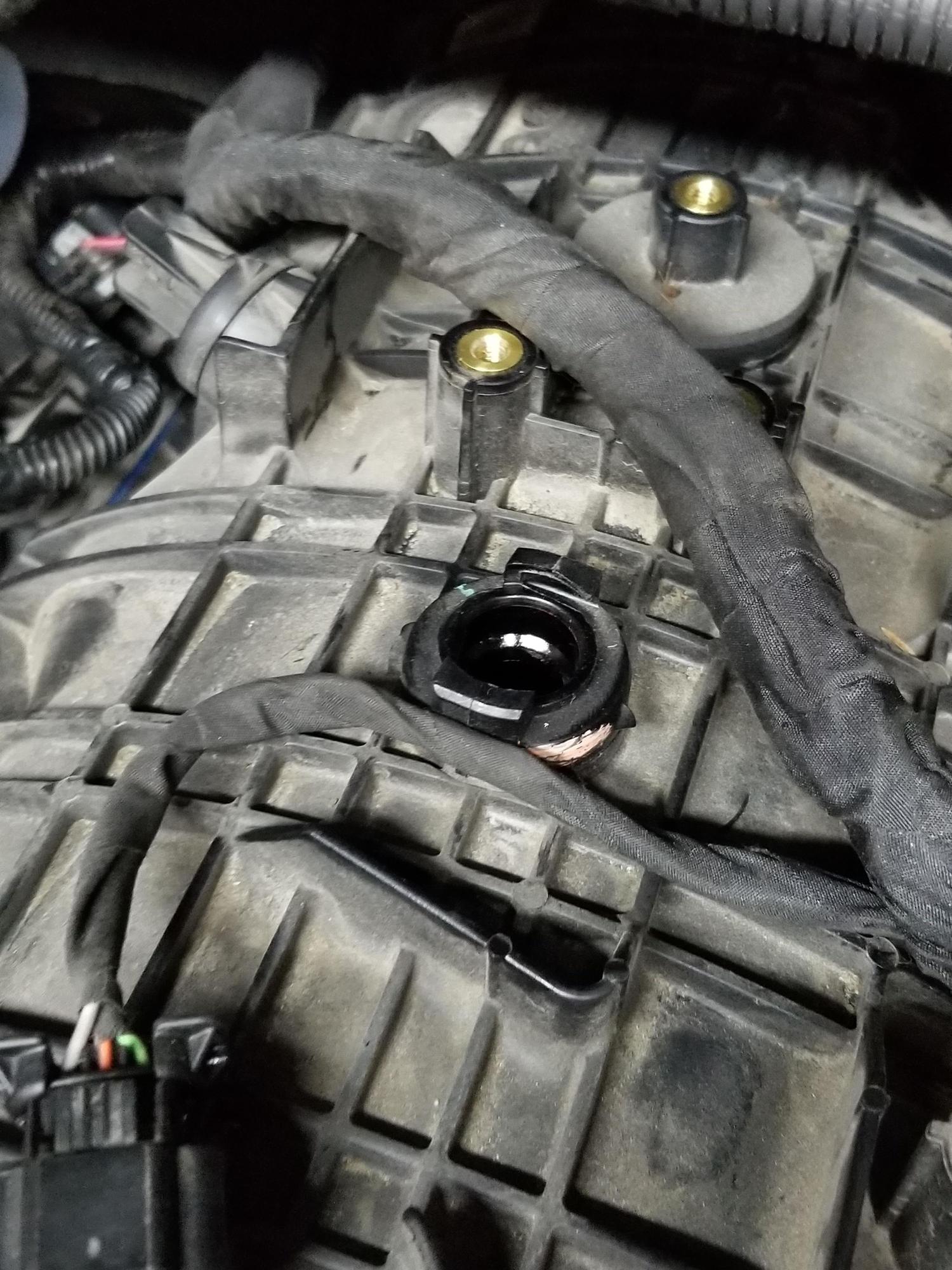

I started getting the motor back togther and pretty much everything is back together. Having some problems with two items. IM running a pcv catch can so what do i do with this big whoel in the top of the intake?

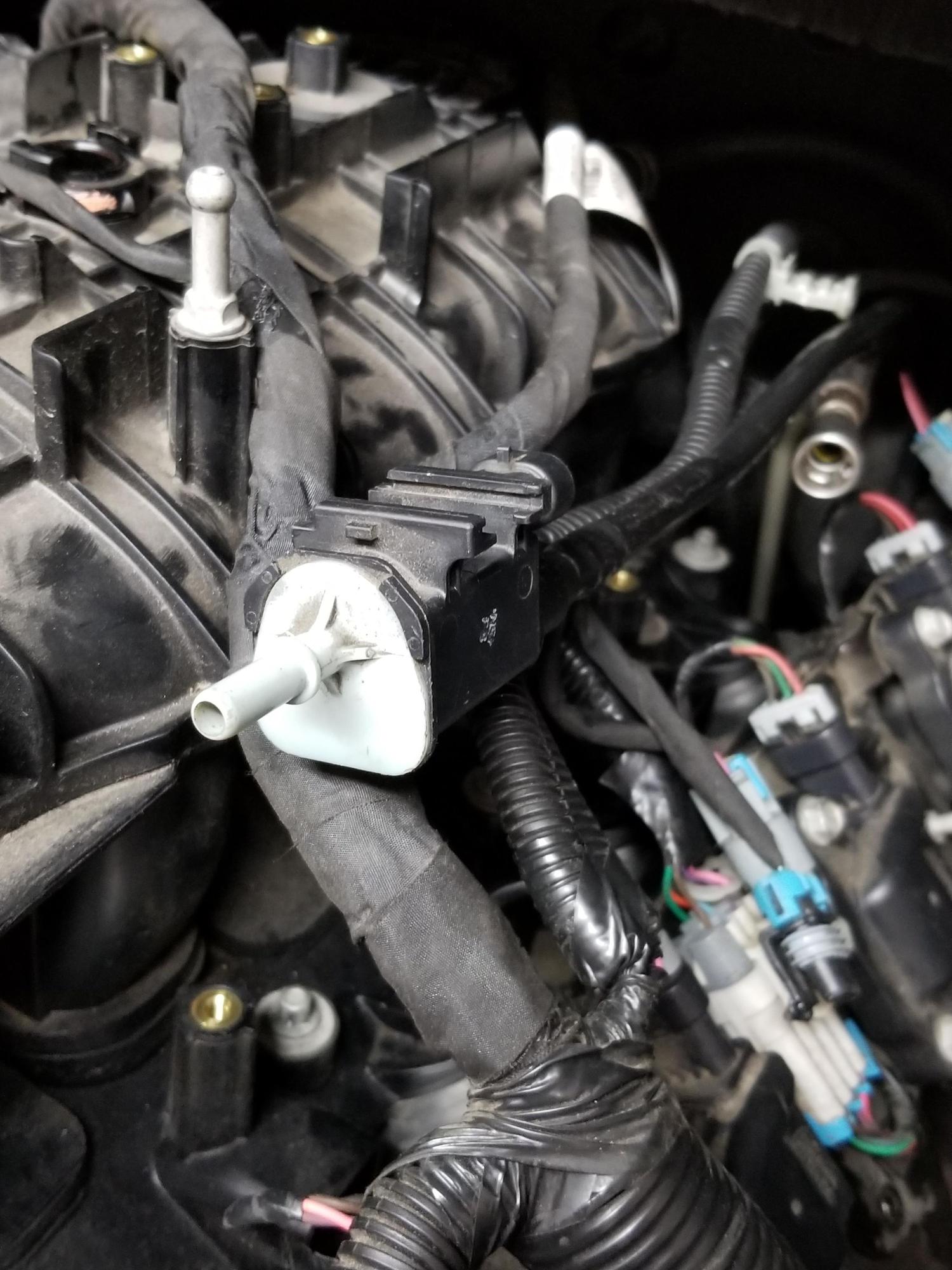

Also i have no idea where this went?
Anyone help me out?

Take the line that you removed from the top and cut the plastic tube with the elbow on it. Then you can cap it.
The second pic has a second line that runs over to right behind the throttle body. You'll see the nipple right there.

Thank you that's what I assumed but rather make sure.
