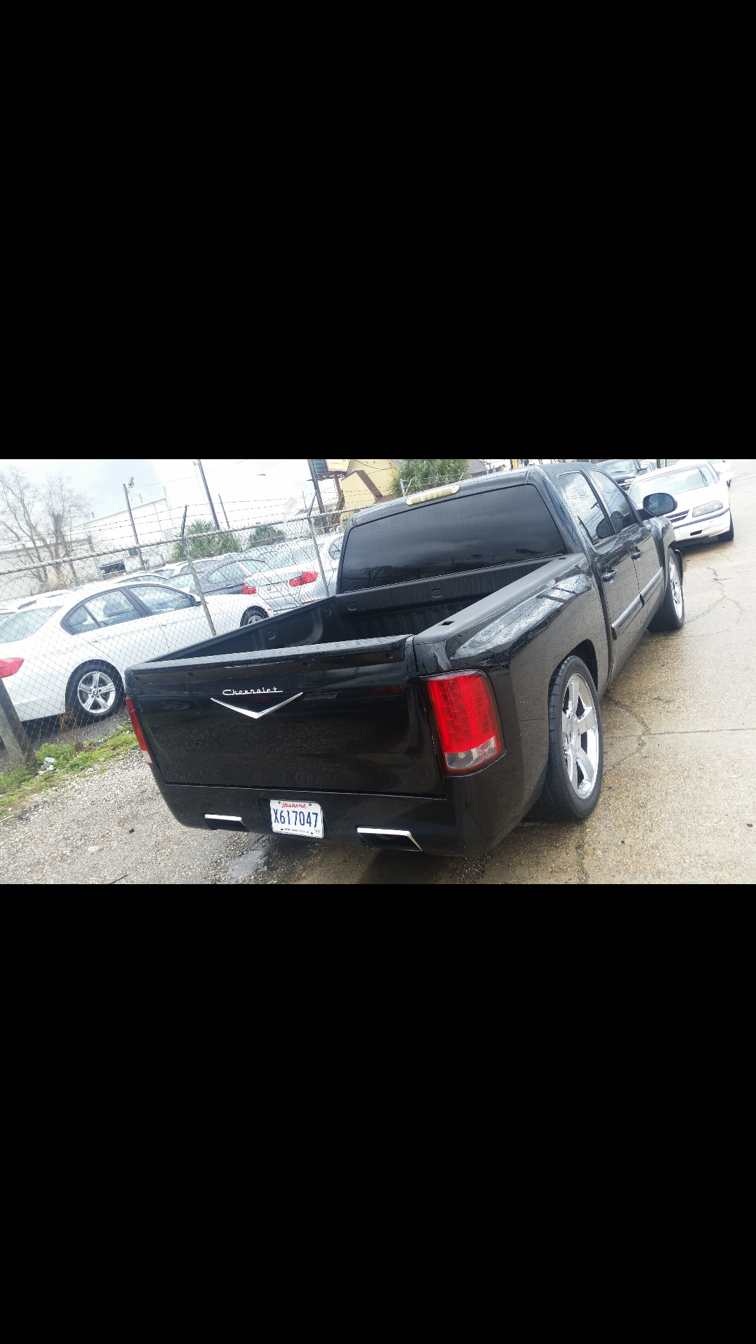

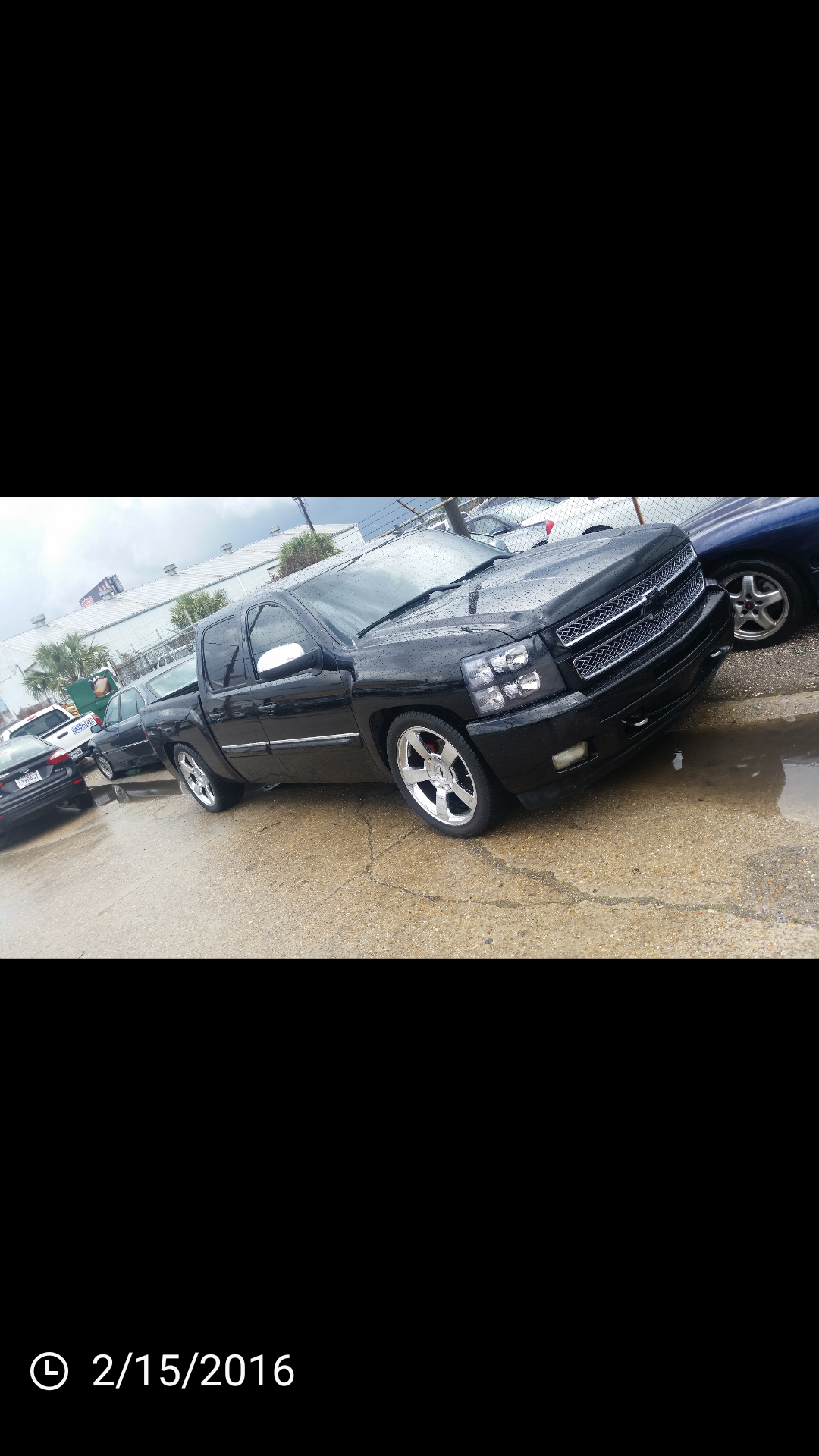

Does anyone have pics and maybe what parts are needed for this swap I think this will be my next mod. My truck below

Pick which year hood/grille you'd want 07-10 or 11-13 . The only adjusting you need to do is on the hood to even the gaps by the fenders, pretty straight forward. My truck has the 11+ hood and grille

Your going to need the hood, grille, hood louvers, emblems,bow tie, and the hood trim peice that finishes the grille.there are also 2 small nuts that's hold the hood grille trim peice on but they're aren't really necessary.
