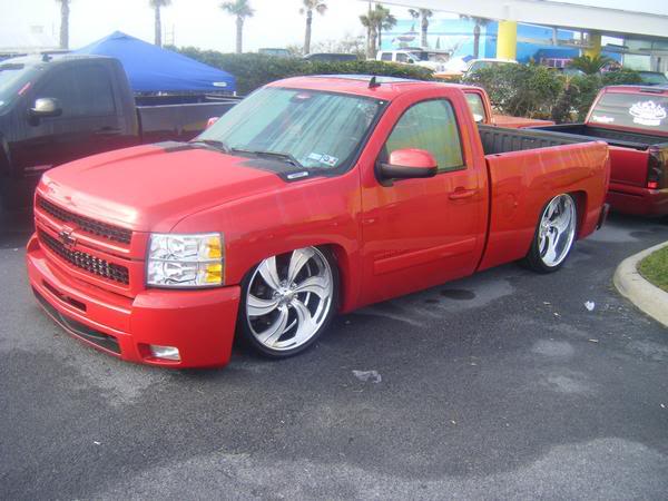

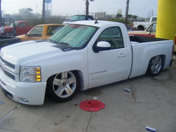

I think that's about it, no kit, all swaps are OEM. there are tons of pics out there.

**** both those trucks are sexy.

I gotta have this!!! but I wonder if I can keep my 1500 bumper center(without hole). Love the pics, keep em commin.

I haven't been a fan of the hd front until now... that red one looks sexy as hell
