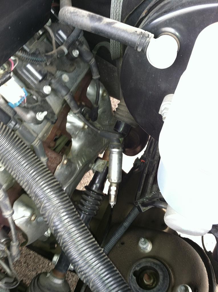

Yeah completely understand the noise now!
This is what i found when i went to get a sound clip, guess i gotta find a spark plug wrench at work?
Got to work before it got light.

So the noise u heard was the engine running w the plug not in the head ?

Hopefully thats all i heard!

Who was working on your truck before? Wow haha. Lucky find on it being a plug not a lifter. You need a spark plug SOCKET not a wrench. It'll make life easier. Also don't over tighten the plug!

Did it blow the threads out of the head or did it just slowly find its way out?
