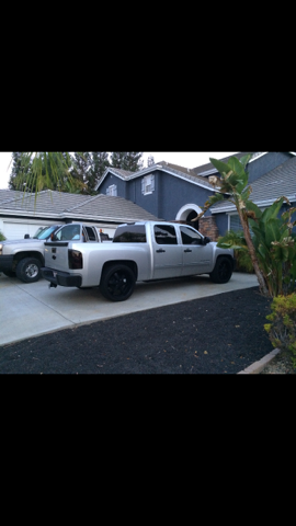

I have a 2012 crew cab silverado 2×4 drop belltech, with belltech street performer shocks which are terrible shocks. I'm also looking to hear more about your monroe fitting and the relocaters you used?

https://www.performancetrucks.net/fo...1&d=1439701496
