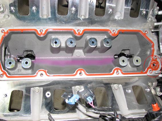

Old Jun 9, 2008 | 08:07 PM
  #30
Wide Open's Avatar
Joined: Jan 2004
Posts: 700
From: Ohio
What I meant was the E38 ECM has the fields to control the AFM option. The 6.2L block has the oil passages to support AFM. I believe the only reason AFM wasn't initially made available on the 6.2L/6L80E vehicles is because of the odd harmonic produced with the converter locked and in AFM mode.
You will need to transfer over your AFM lifters, the control solenoid and splice in the AFM wiring pieces. Here is a picture of the lifter valley of a 6.2L.
