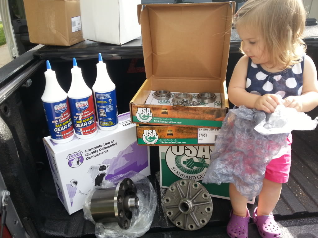

I bought a barely used 2011 4wd 5.3 6l80 truck in 2012. My first mod was swapping to 4.11 after a few months of owning. I now have a cam, converter, headers and a few other minor things, but the gears made the most in-town impact that made a huge driveability impact, if that's a word. Just better all around in town. And Hwy for that matter. I gained about .5mpg both in town and Hwy going from 3.08 to 4.11. I'd do it again, first thing. All daily driving this truck in town other than 5-6 Hwy trips a year. Don't hesitate on going 4.10/4.11 with the 5.3, especially on a heavy truck. I also have stock 20s and factory ride height, minus the rear lift blocks. And yes, this thread was a factor in my decision. This heavy truck jumps off the line, but I've never raced it.

Thanks KC_kid! I was hoping to hear from someone that actually made the swap. Speculation is fine but real world experience is much more valuable (IMO). Looks like you've got a great helper too.
