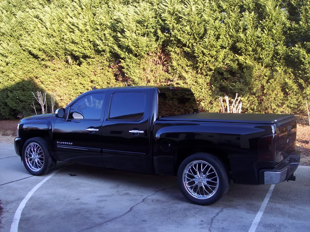

yea the lower gear makes it easier for the engine to move the weight, allowing it to have enought power to pull you truck around in V4 mode. at a point around 70mph the truck is just too heavy to move and it needs V8 mode. 24inch rims wont be too easy to turn, my 22s made is worse than the factory 20s.
Very nice which tonneau cover is that?
its a trifold. tonneaucovers.com i think has them.

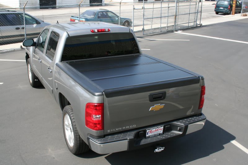

rjwz28's Avatar
Man Motor club
Joined: Jun 2007
Posts: 2,623
From: Sunniest city on Earth
I ordered this one, it should be arriving today. We've got a vacation coming up and it will be nice to be able to lock up our stuff in the bed. I won't be able to install it until I get back in town from my business trip.
Old Jun 6, 2011 | 11:33 AM
  #78
NKPPhil's Avatar
Joined: Jan 2011
Posts: 1,074
I ordered this one,
Is that a Fold-A-Cover?
Old Jun 7, 2011 | 10:47 AM
  #79
rjwz28's Avatar
Man Motor club
Joined: Jun 2007
Posts: 2,623
BakFlip G2 (hardtop tri-fold, 300-pound weight-bearing rating)
