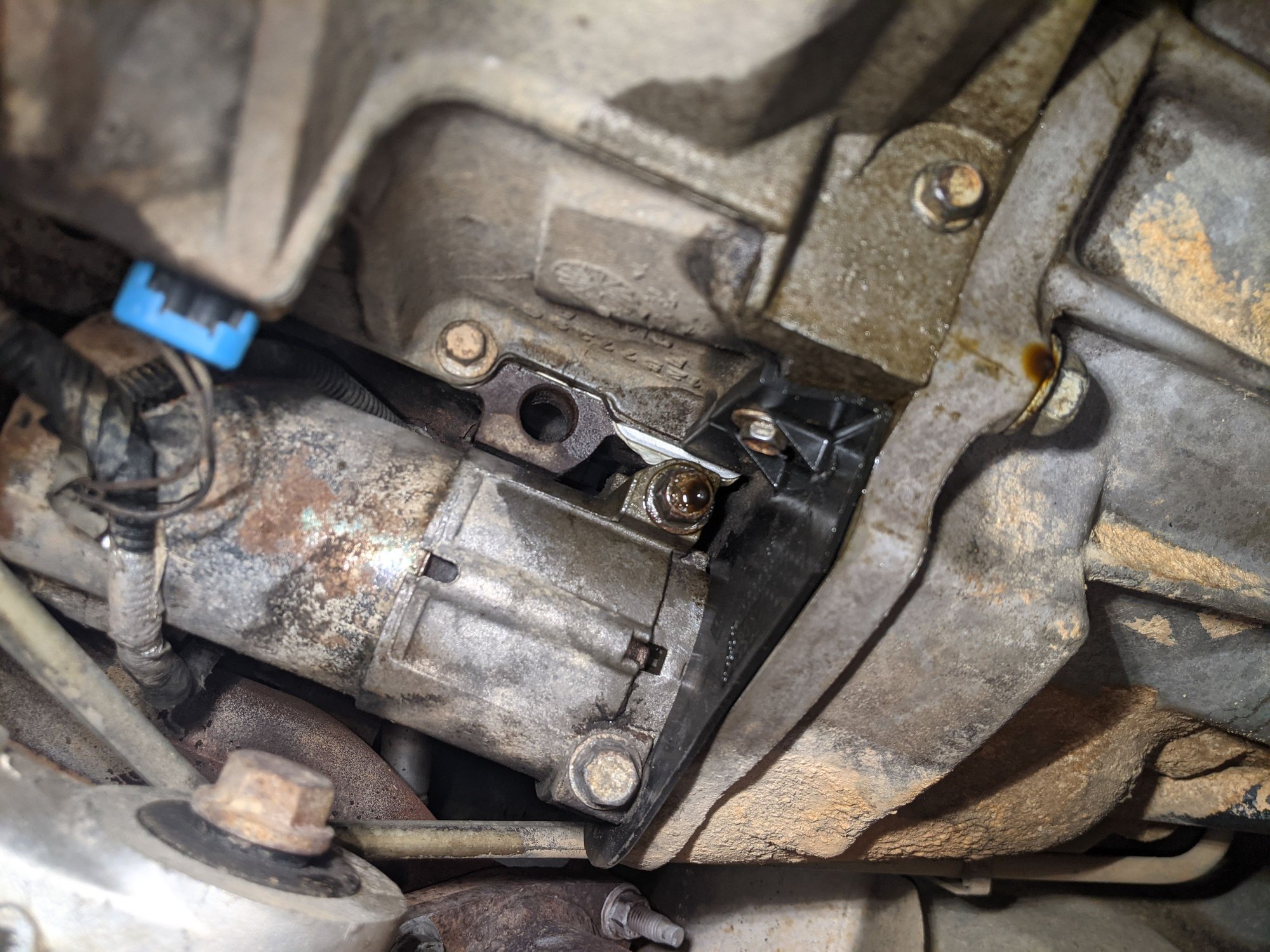

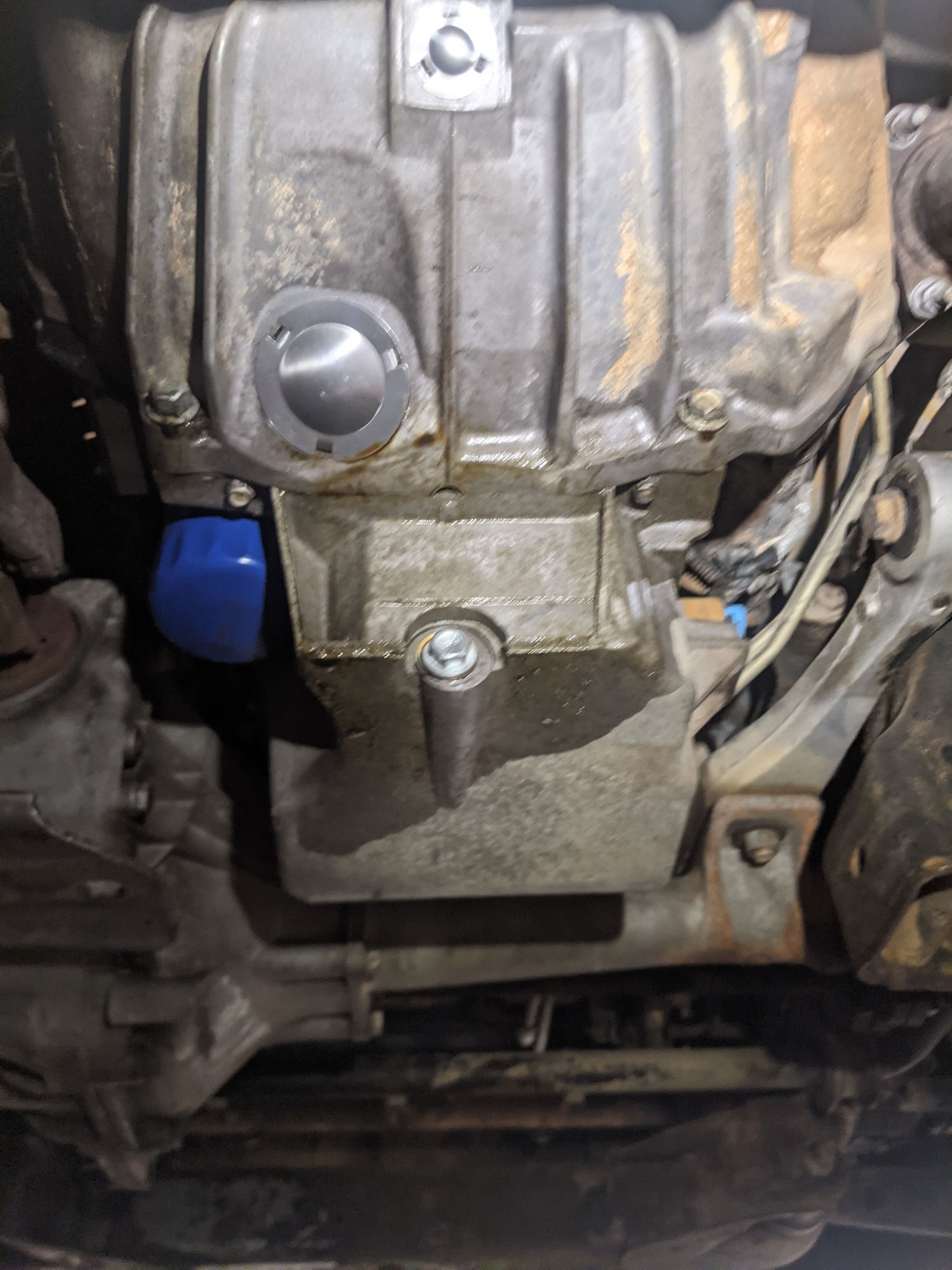

So I hope I am not annoying anyone, but I still have a little motivation left in me to try to fix this thing. So another couple weeks and the oil pan gasket I would say is sealed, I don't see any spots around the oil pan seam or the bolts except at the very end at the bellhousing. The same lines still have there oil on them too. I am also getting trans fluid (I can tell its red by wiping some of it on a paper towel) looks like coming from the smaller bellhousing inspection cover hole.

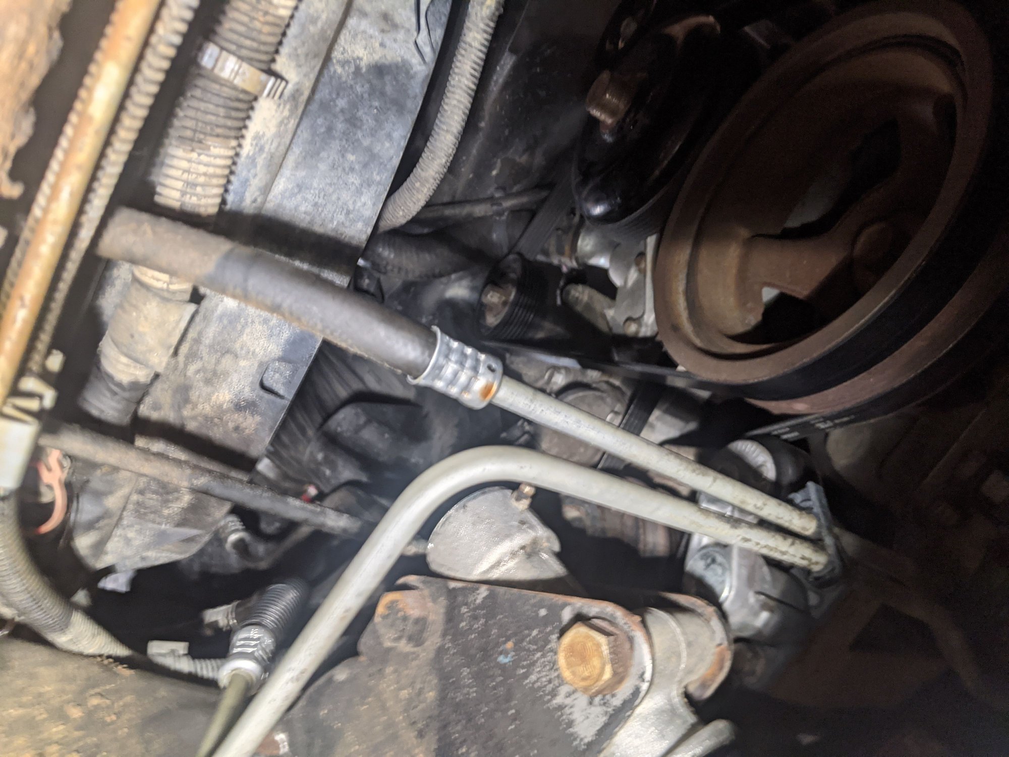

The biggest pita is if the lines are leaking and I do try to replace them, its going to make a huge mess. I invested in some of those bent piece of metal things with a wing nut and a rubber nipple thing that you are supposed to be able to put in lines and seal them up when you take them off. The rubber cracked and they all broke haha
I think maybe I should pull the intake manifold again and look for leaks on top, maybe by this time the dye will show up on top and I can find it if there is one. Also maybe I need to invest in a higher quality dye set? I just have the cheap parts store set.
