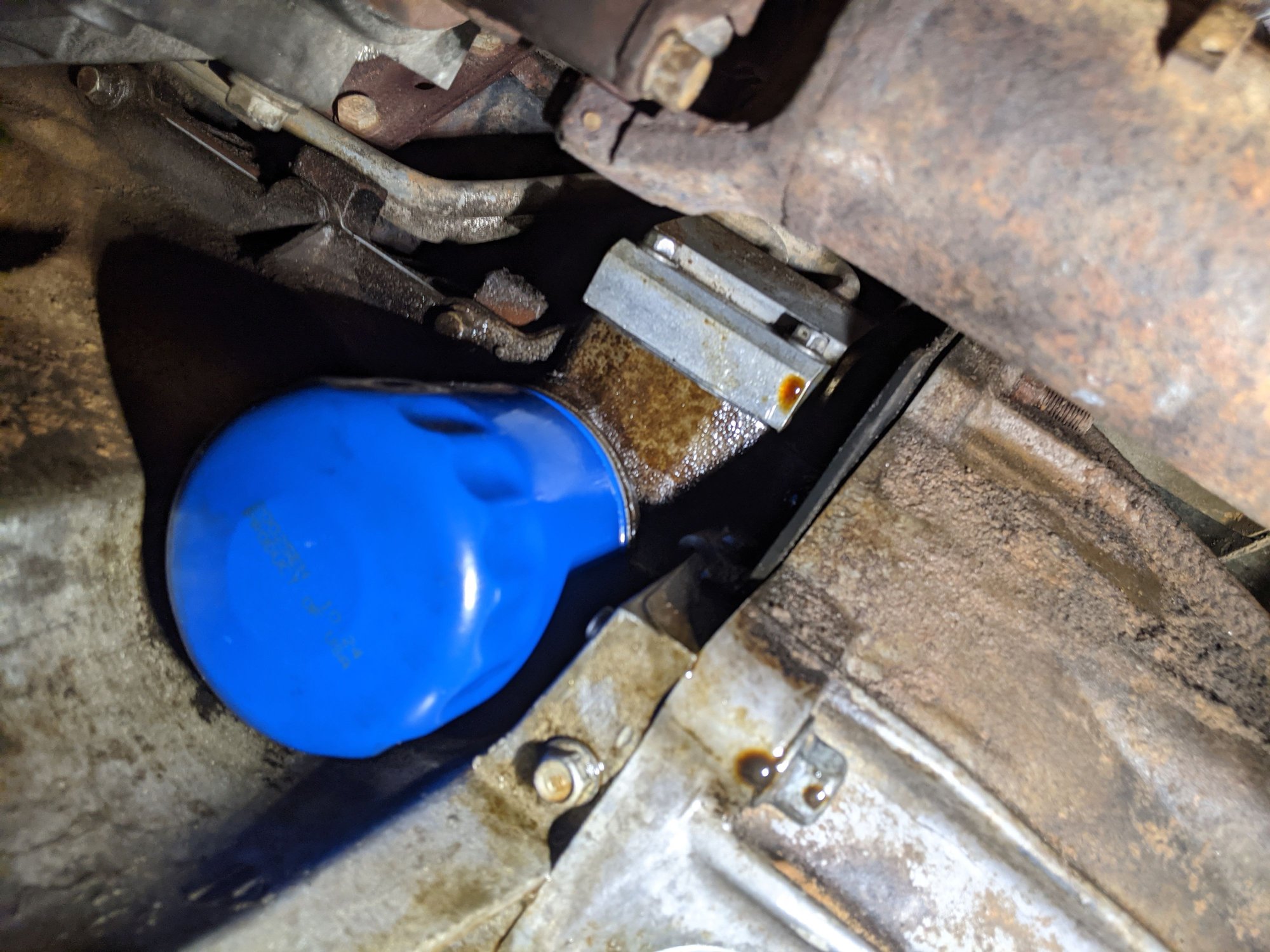

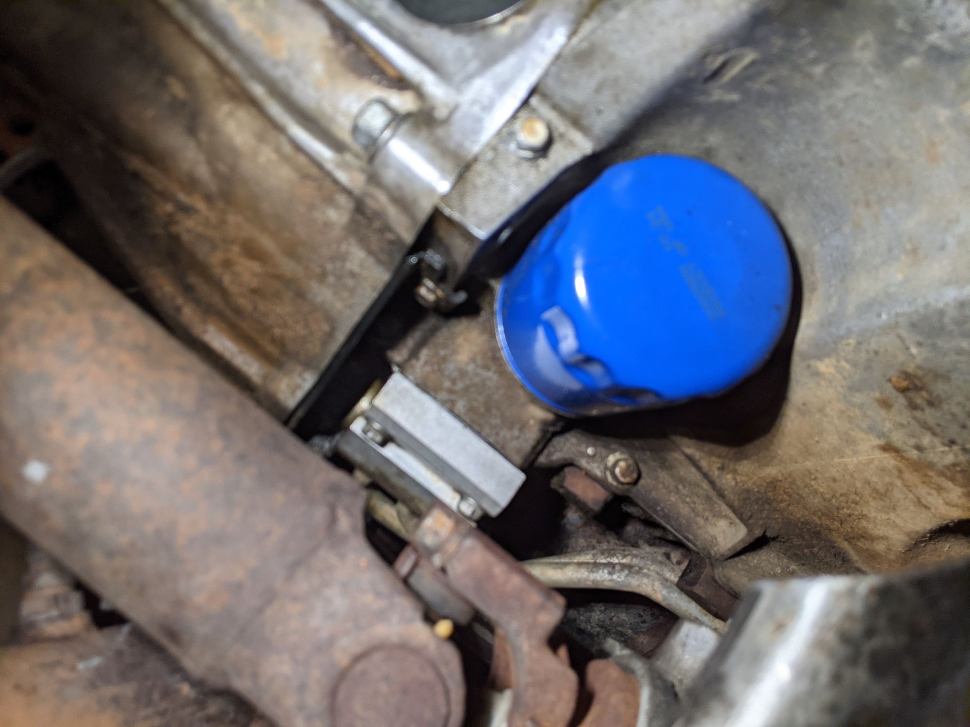

So over a week now I've been running it and honestly I think the leak is worse now with more drops on the driveway. In addition to that, I have been trying to vaccum bleed the power steering system and either I split to much or either I created a new power steering leak since its all over the place now.
However I am still determined. I think I should try to get a better more quality dye and UV light kit? I guess I should start replacing hoses now? Oil cooler hose? It just dosen't make sense how there is drips on the bottom of the hoses if the hoses aren't leaking?
Tomorrow, I am going to give it another cleaning with a pressure washer and engine degreaser so I can start new again and try to pinpoint any leaks.

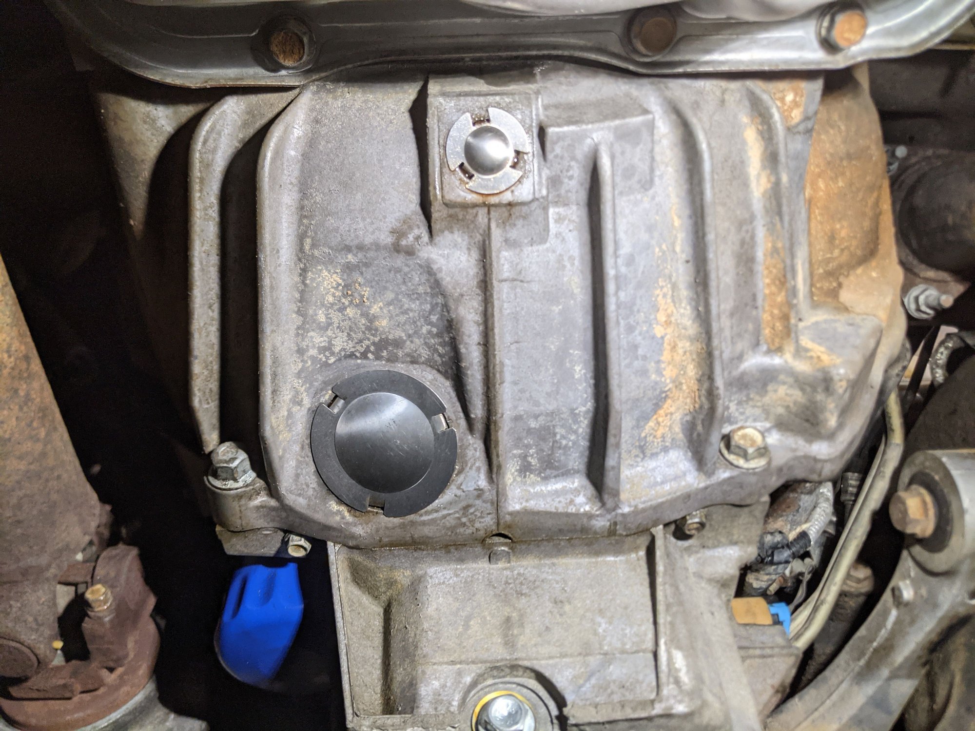

So things might be looking better maybe. I cleaned every off again with degreaser. My transmission looked like it was also leaking, but then I realized the pan bolts were kind of loose from when I changed the fluid, so I tightened them up but I am not sure if it stopped it, it kind of looks like red trans fluid near the smaller bellhousing cover.

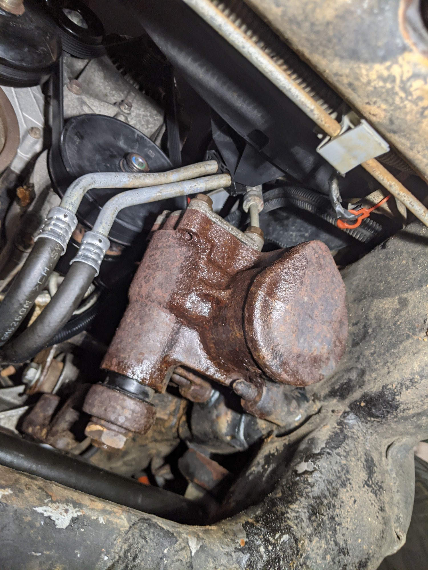

So looking at the last picture of the steering box, it looks like it might be leaking now, or maybe its always leaked I could just never tell? Also it still baffles me that all the trans, oil cooler lines, and hoses all get drips of oil on them that collect at the lowest point, but then if you try to run your finger up to see if there is oil higher on the line it is always dry?
Anyway it may look like my steering box is leaking, I was thinking it was my power steering pump leaking, I've also been trying to vaccum bleed the power steering system to gid rid of the wine, it kind of seems to work and then comes back in a few minuets. The wine isn't too bad but its a lot worse than it was with my last pump, which was a reman pump, and this one is also a reman pump. I should probably just break down and buy a brand new ac delco pump, or at least try to find a original factory one at a junkyard to pull off i'm sure a original factory one on a wrecked car is still better than a cheap aftermarket.
I think the steering boxes are known to leak at the tops?

When you pull the plastic covers at the bellhousing, the flexplate is dry as well both sides.
