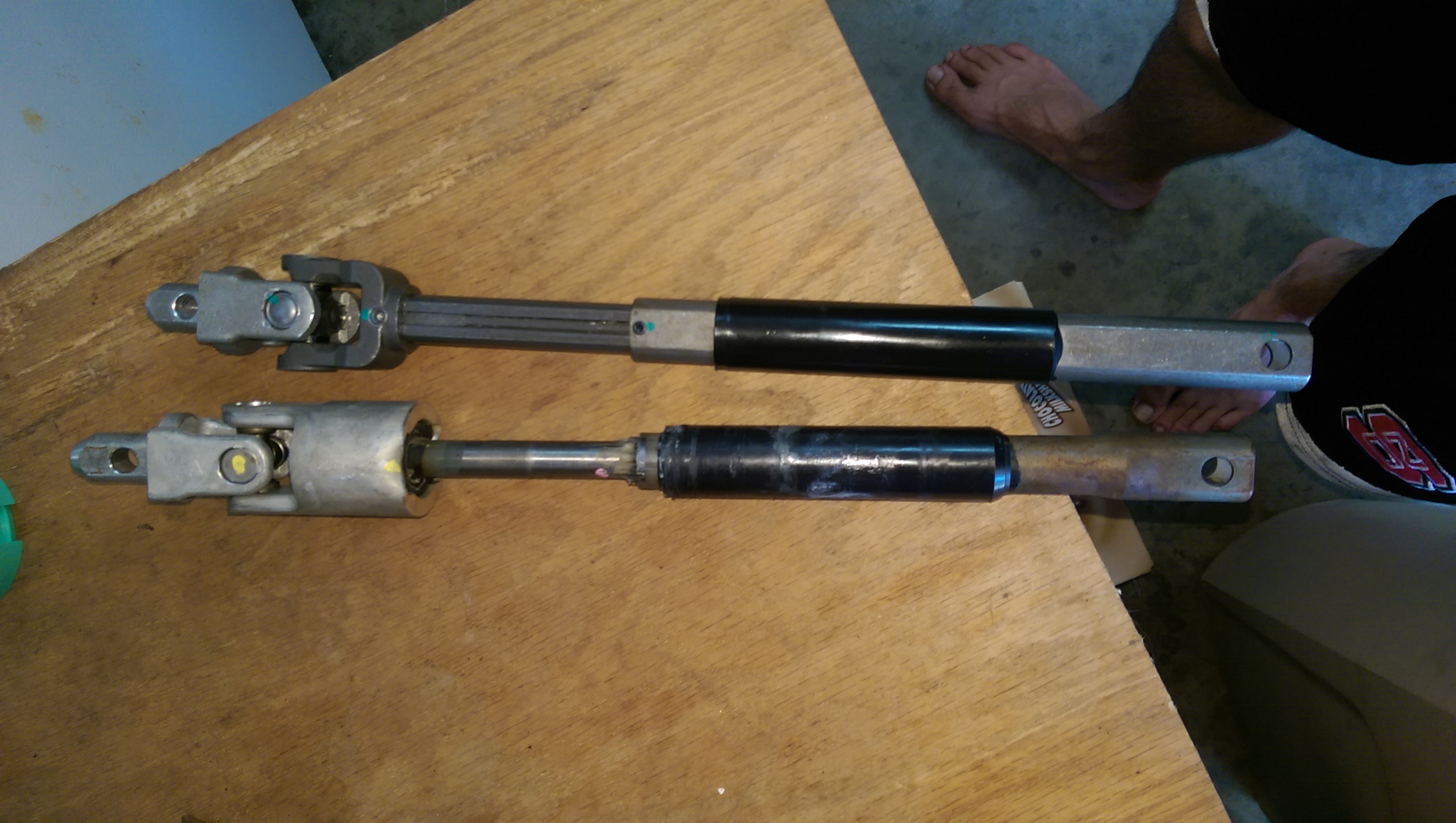

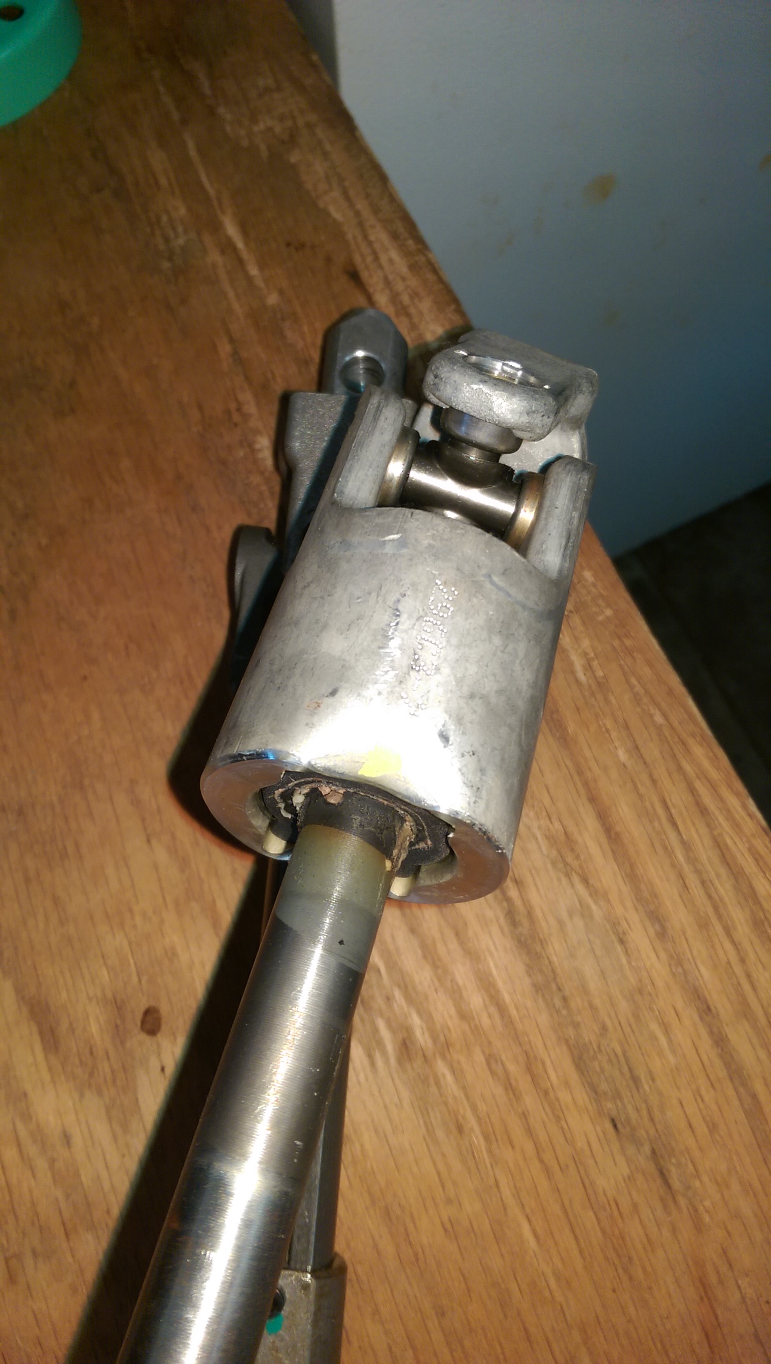

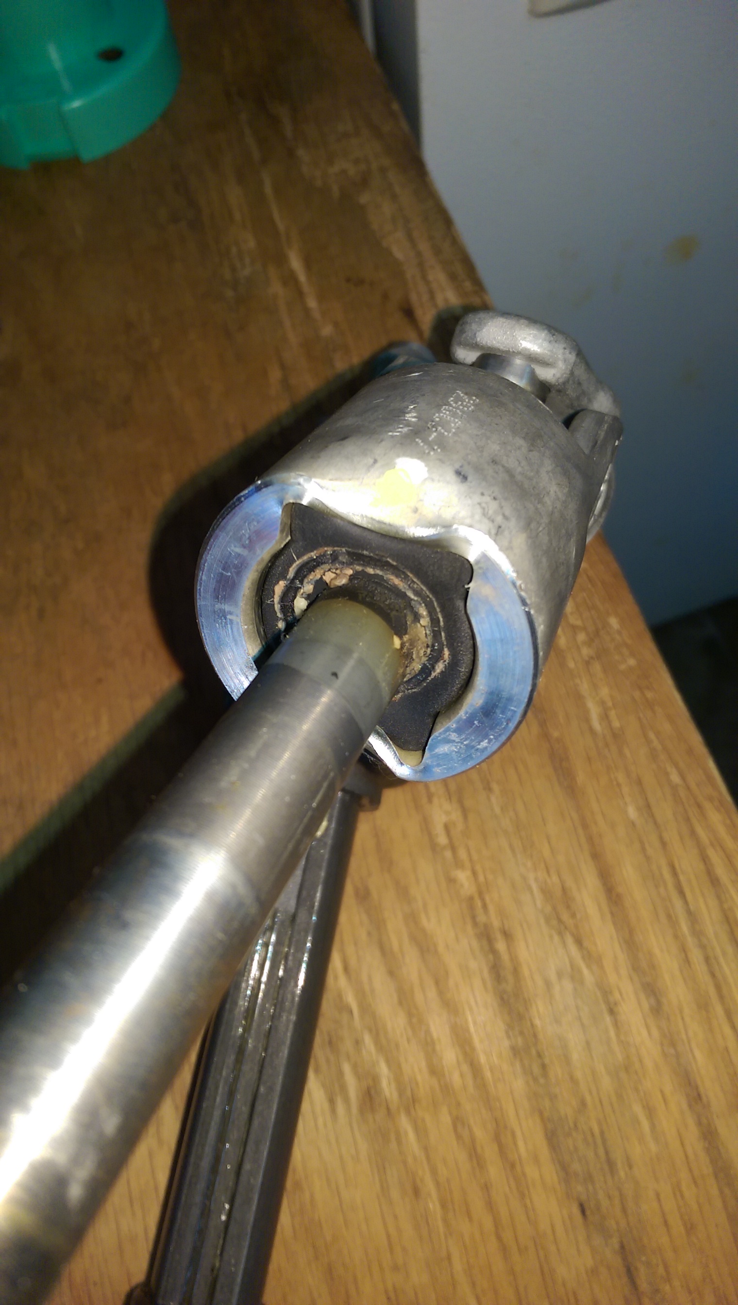

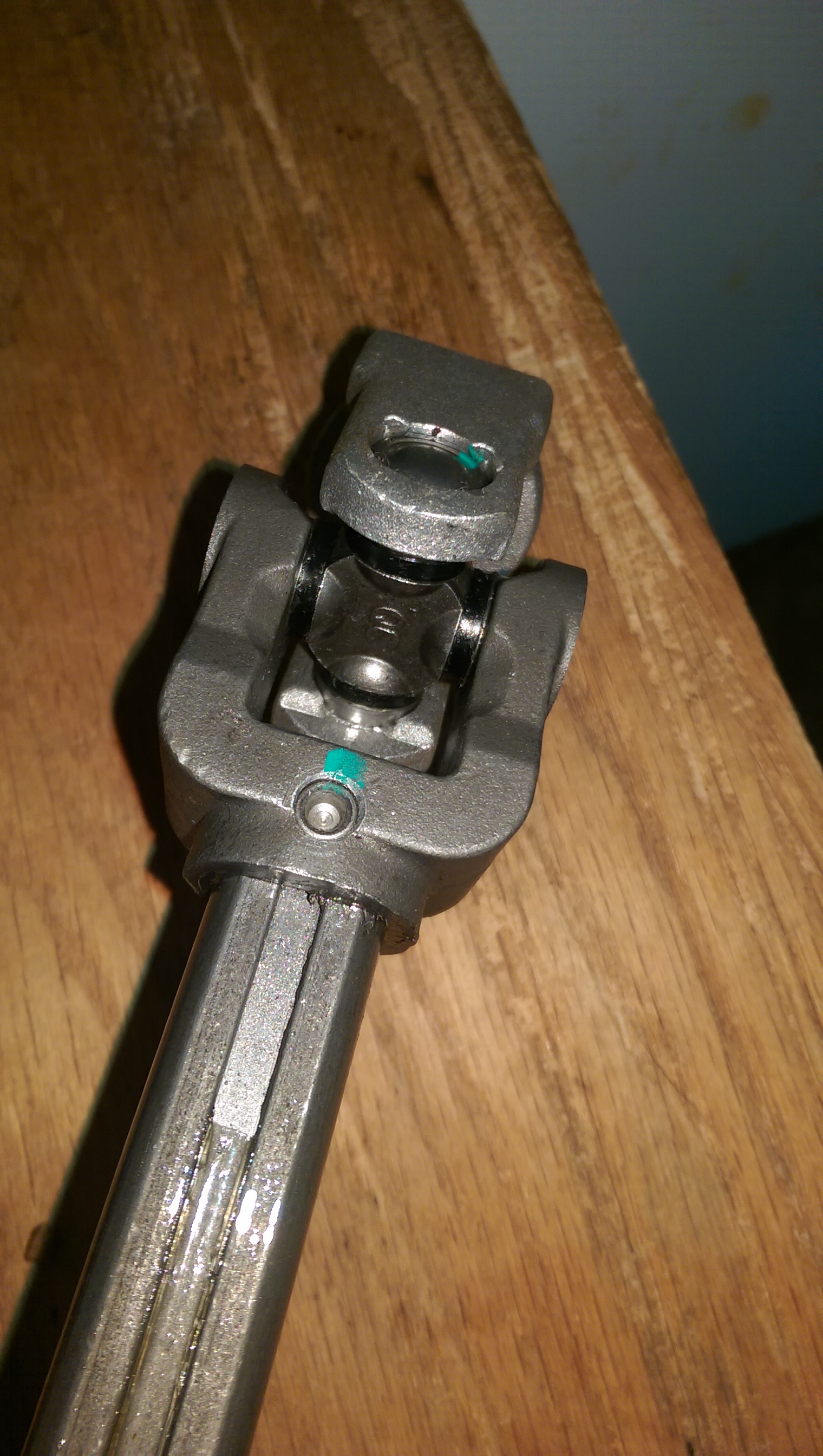

Here's some pictures I took to show the differences in the upgraded parts

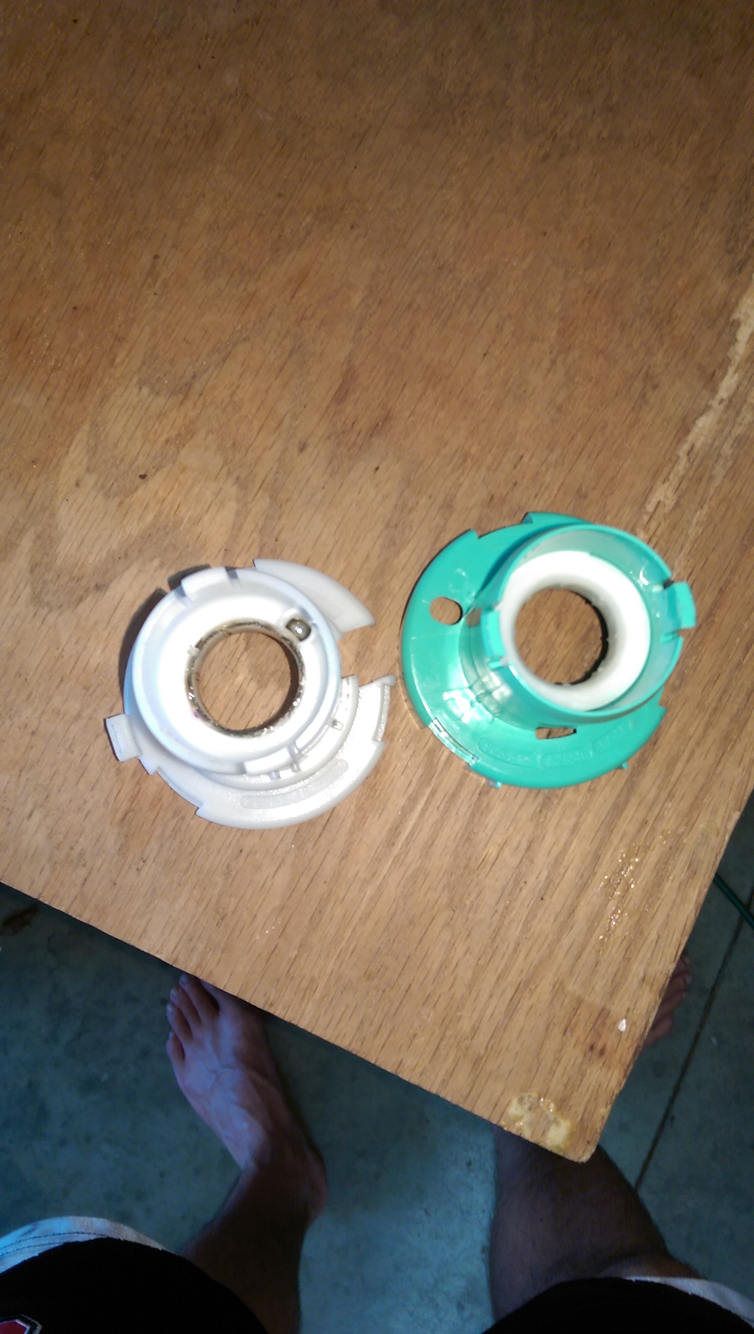

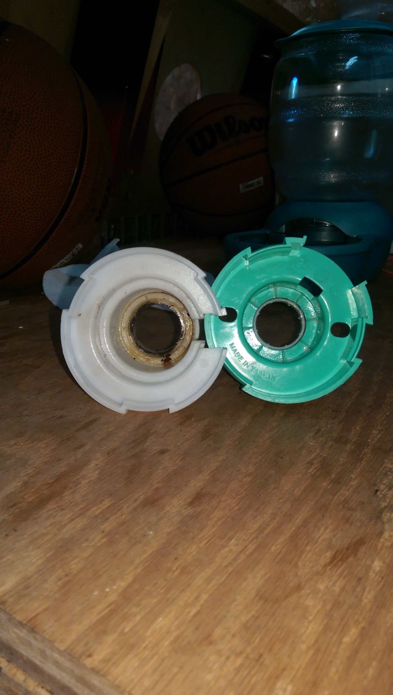

Bearings...
Definitely quite the upgrade.
Are those the gm upgrade or the dorman ones?

Dorman, figured GM couldn't make it right the first time so might as well try aftermarket.
I need to replace both in my 03 so I might put in GM parts to see how they hold up I'll keep you posted.
