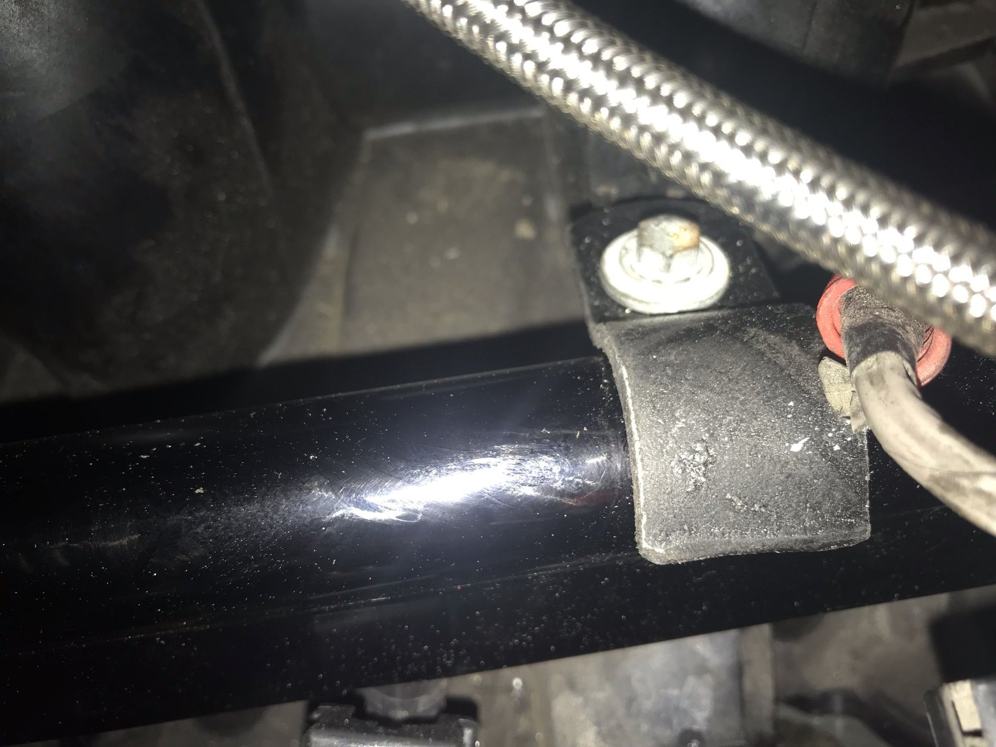

Long shot here but does anyone know of a stock-configured billet fuel rail kit that would work without/with minimal modifications for a NBS/NNBS/TBSS truck intake with ls3-height fuel injectors? Trying to get as close to a bolt-on kit as possible. Thanks!

The ebay rails worked with my Deka 80lbs. Just needed a tiny spacer. Not sure how ls3 injectors compare height wise.

I'm using deka 210lb CNGs but they're the ls3-style so shorter a bit than the truck injectors. I currently have "Hats" so they can fit in stock rail but I need to plumb in a FPR.

I use holley fuel rails an 210 injectors I had to make a bracket to hold down the fuel rails but they work great

Any pics or dimensions of the brackets by chance?

Made them fairly easy there now painted black this pic was in the process of making them
