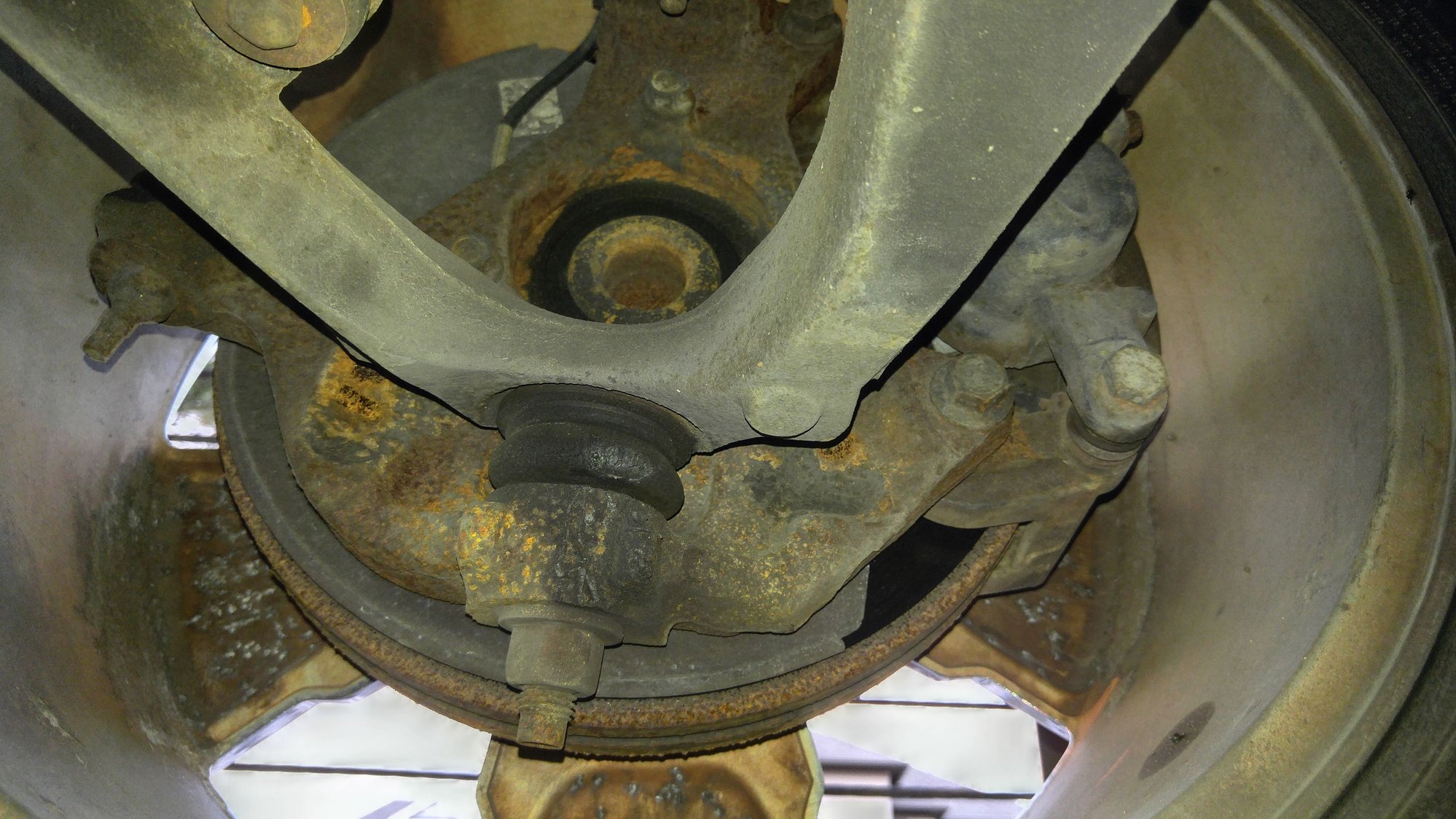

2005 GMC Sierra 1500 VHO 6.0L, I think this is the left front wheel
2005 GMC Sierra 1500 VHO 6.0L, I think this is the right front wheel
2005 GMC Sierra 1500 VHO 6.0L,left front brake

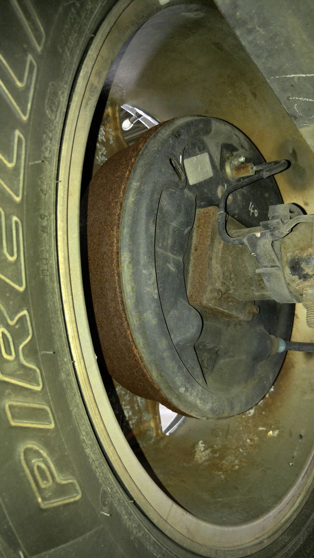

2005 GMC Sierra 1500 VHO 6.0L, I think this is the right rear drum
2005 GMC Sierra 1500 VHO 6.0L, I think this is the right rear brake drum
2005 GMC Sierra 1500 VHO 6.0L, I think this is the left rear drum brake and wheel

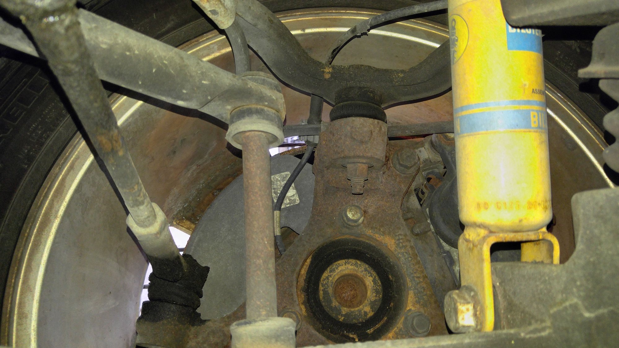

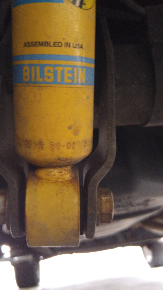

2005 GMC Sierra 1500 VHO 6.0L, shock absorber and ?
Old Jun 12, 2017 | 07:06 PM
  #57
Sierra2K5B4V's Avatar
Joined: Feb 2017
Posts: 97

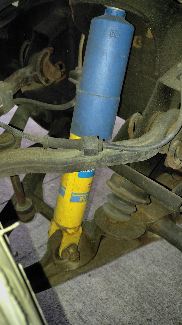

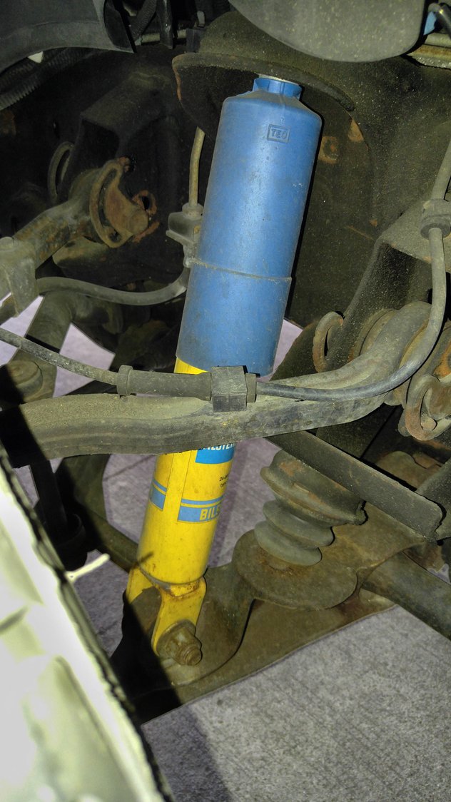

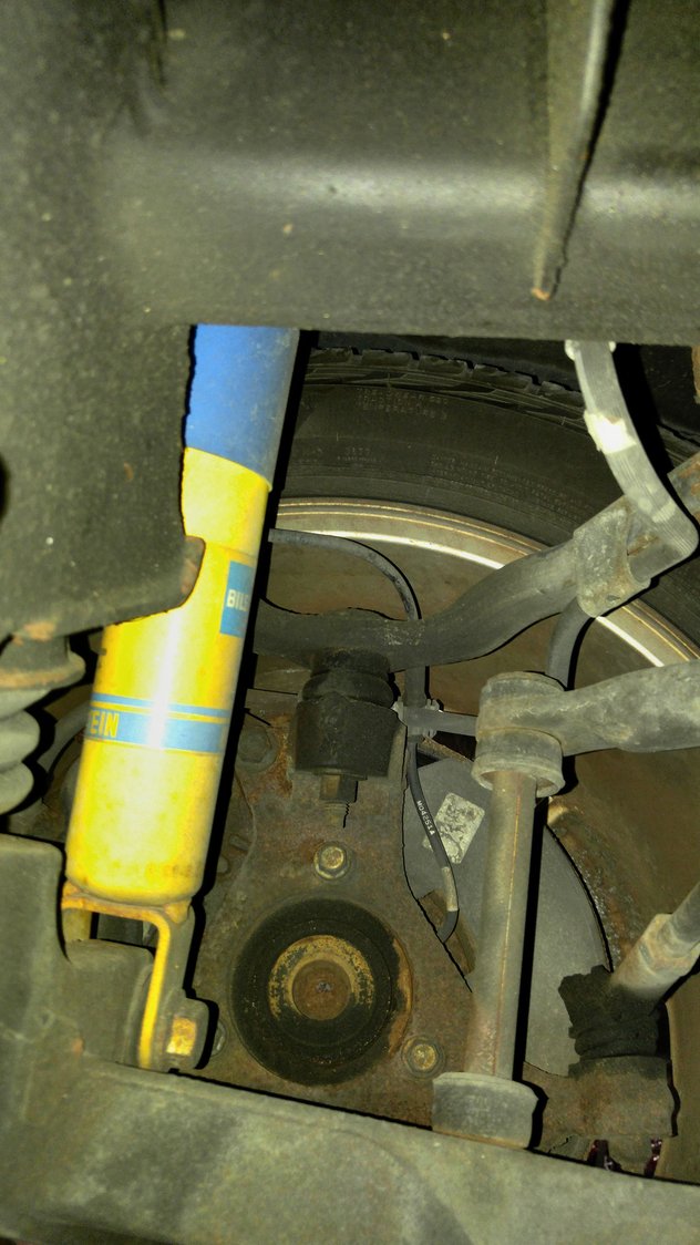

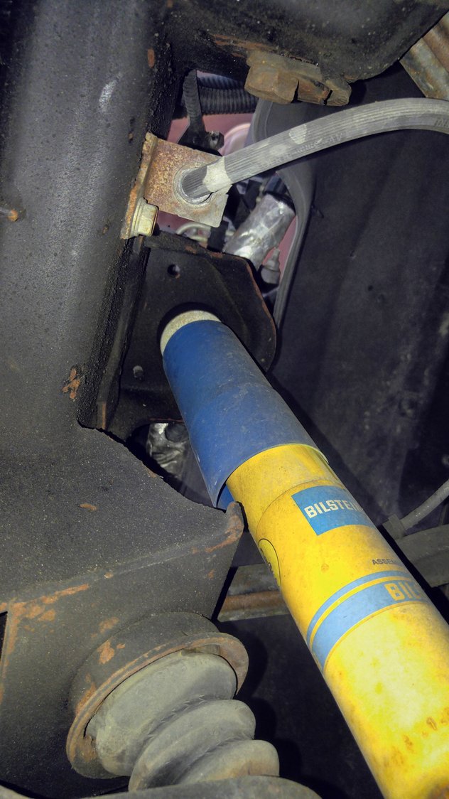

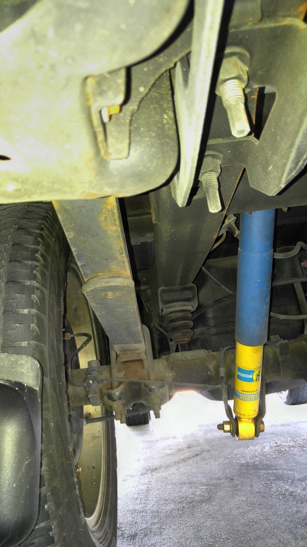

2005 GMC Sierra 1500 VHO 6.0L, left rear tire, leaf spring, jounce bumper, shock absorber and ?
Old Jun 13, 2017 | 08:02 AM
  #58
1Bear's Avatar
Joined: Aug 2006
Posts: 1,410
Likes: 8
From: Jones Creek, Texas

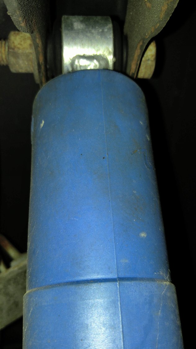

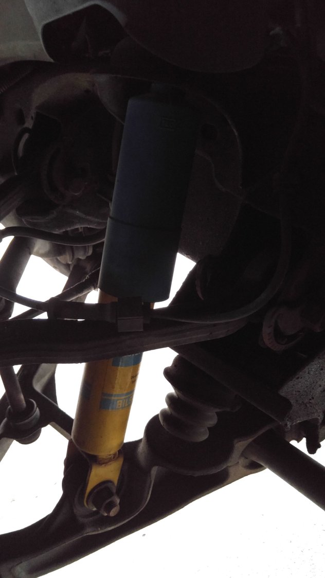

Actually, your truck is real clean underneath, minus a few little seeps here and there. All the rust you have looks like very minor surface corrosion that wouldn’t concern me in the least from what I can see.
Yes, your jounce bumpers are pretty much shot from the weather. You can pick up some new ones and in the meantime until you decide whether or not you are going to raise the truck back up, you can un-bolt the extension brackets and bolt the bumpers straight to the frame rails. The bolt holes are already there underneath the brackets to do this, so you won’t have to modify anything. That will give you quite a bit more space between the bumpers and the rear axle, which will keep your truck from bottoming out so early.

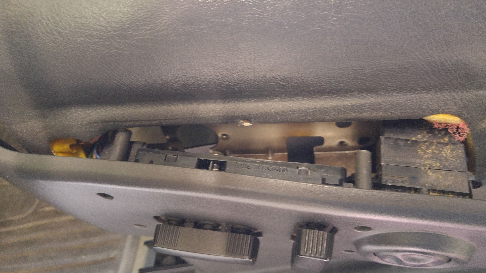

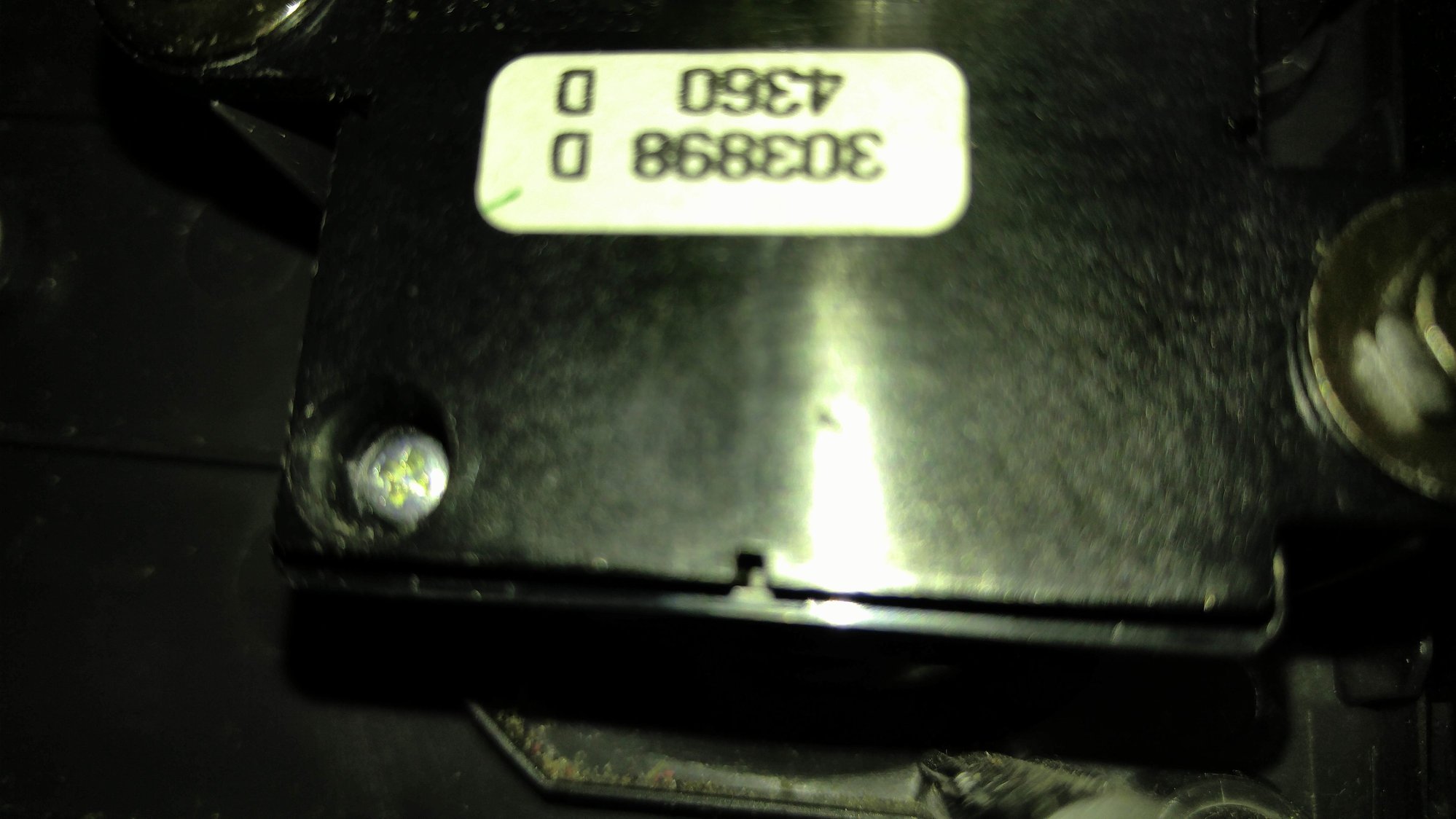

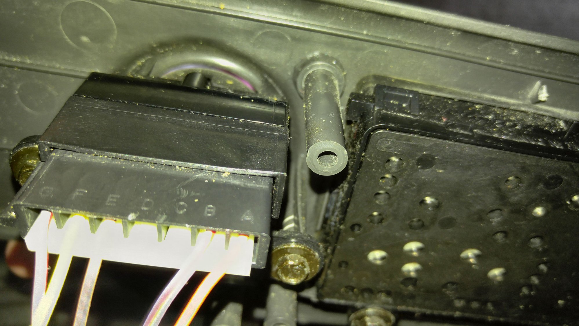

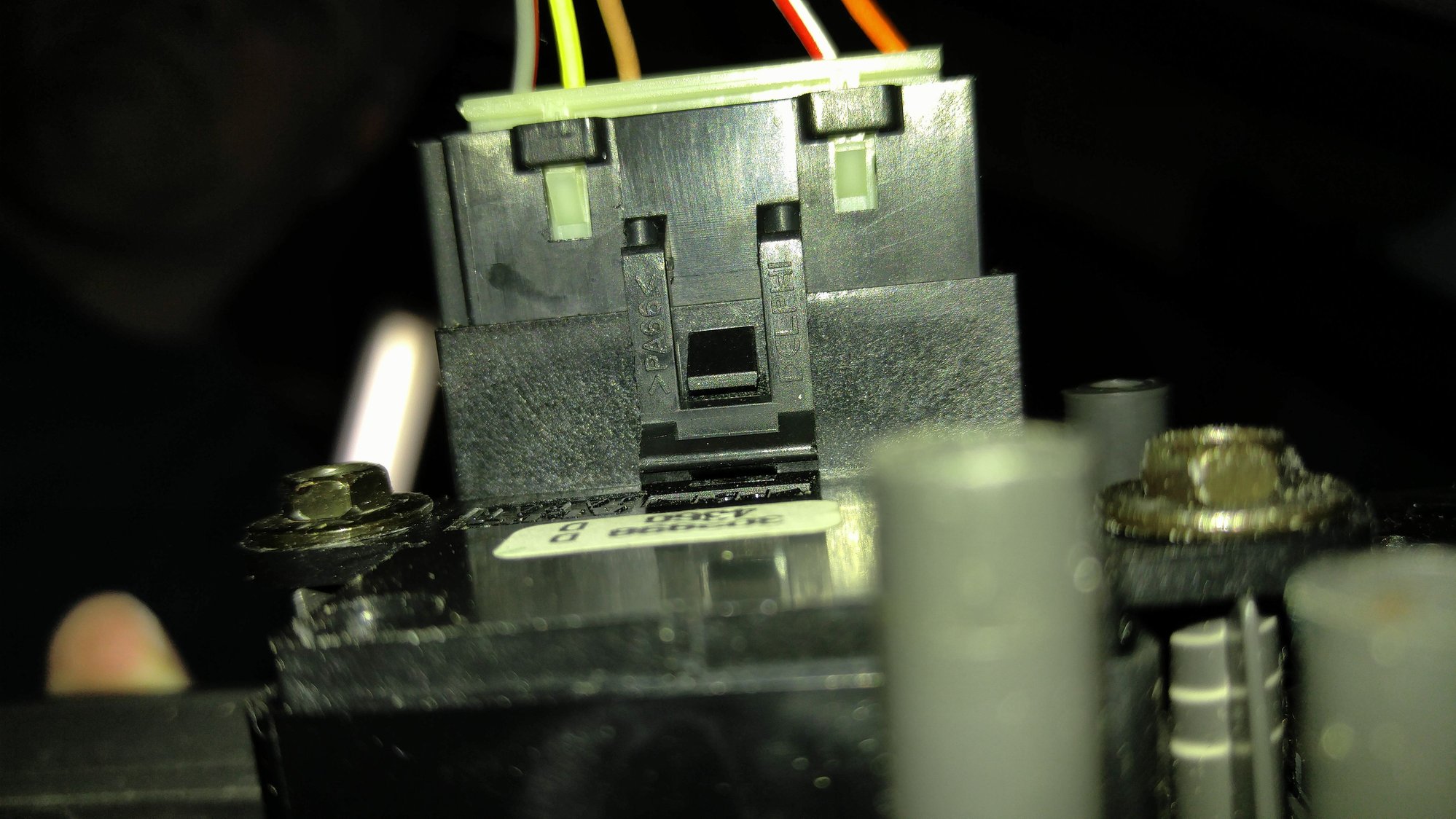

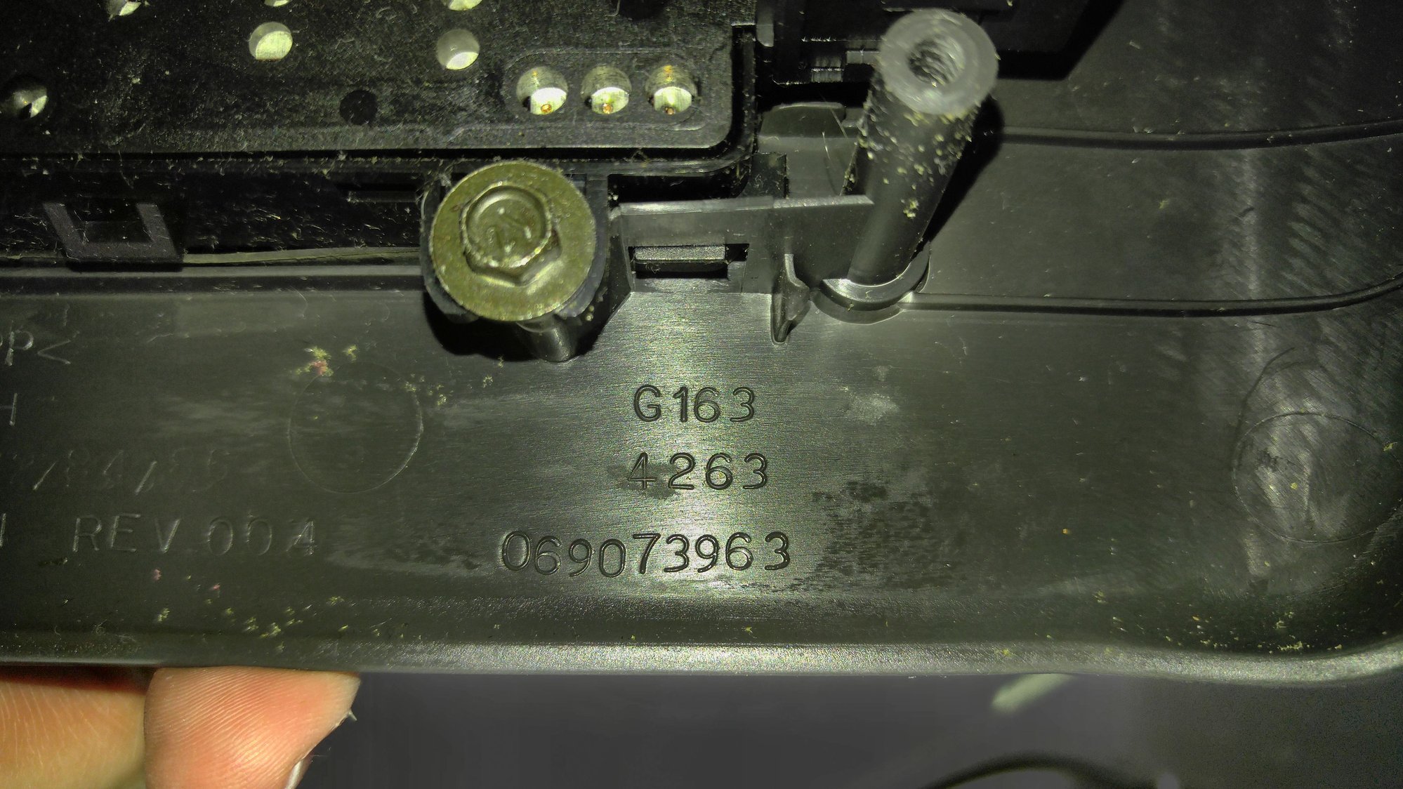

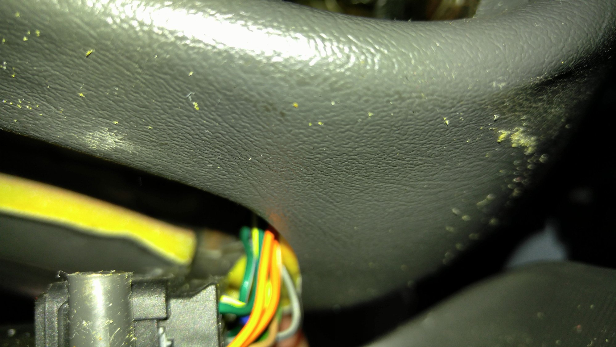

I attempted to fix my driver's power seat in May 2017, but I could not resolve the problem. I noticed the unreliable seat movement in late February when I left Florida to visit Houston, Texas.
I was hoping it was just a quirky glitch that would be gone when I arrived in Texas - NOT. In my humble opinion I am experiencing a "defect" that is a recall item GMC Sierras and other GMC models, but my trim is not on the recall list. Why? I did not get a recall notice because my truck is a low production run [future note to self stick with the vehicles that have large production runs] and there aren't enough numbers of complaints on the NHTSA website. I tried to fix this seat problem, but "no cigar"!
My 2005 GMC Sierra 1500 VHO 6.0L Performance Edition's driver's seat's 8-way power switch in a state of unreliability

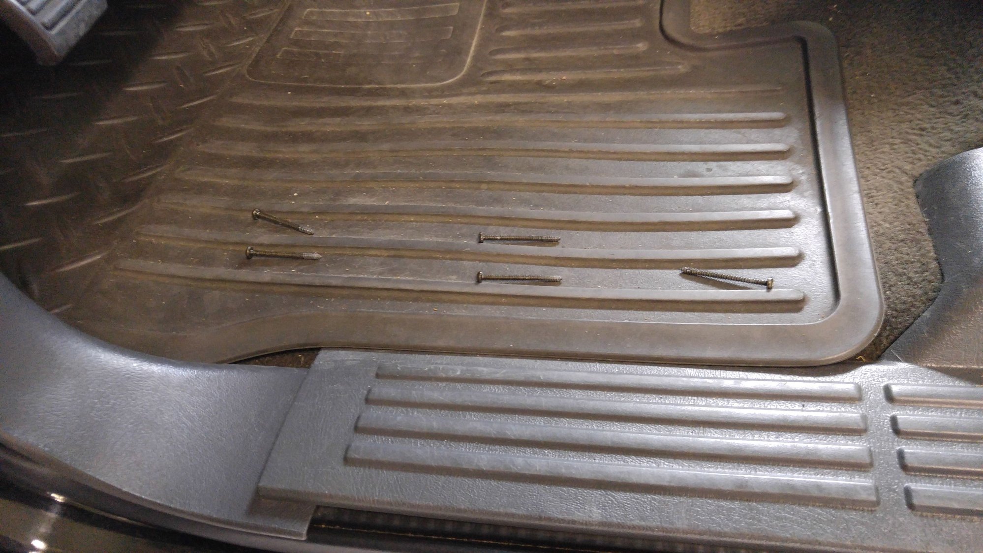

Don't lose your screws!
These connectors were hard to disconnect!
