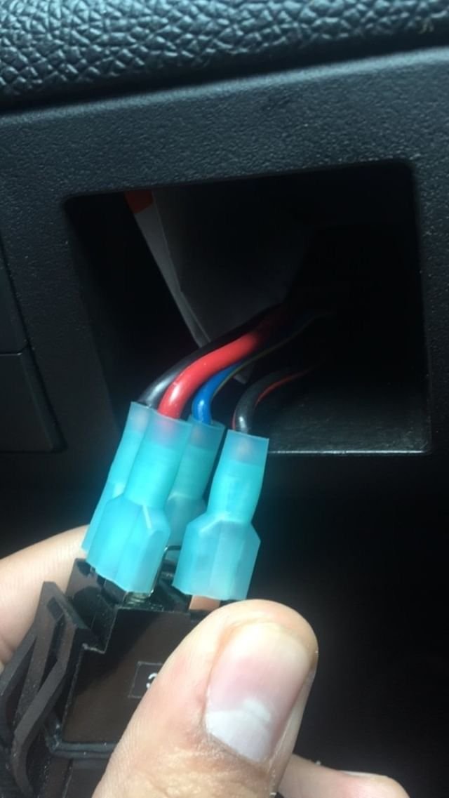

You have any pictures of how you wired the switch?
Originally Posted by kaze_v8
I wired my truck up, unless anyone needs pictures and details, i just bought that forward and reverse switch that was posted, then i ran the wires from the window all the way to my switch location. I used the 2 thicker wires on the window motor, the black and blue.
From the switch i used a fuse tap and tapped into the "rear windshield wiper" motor, i think it was a 30A fuse, and then i used a 25A fuse for my window motor.
Initially that fuse is not used because only the suburbans have a rear windshield wiper. The fuse tap you can get online or at the auto parts, NNBS trucks use the standard mini size fuse, and i just grounded the switch right by the crash bar under the dash. Window has not skipped a beat sense.

Old Mar 28, 2019 | 03:23 PM

  #105
kaze_v8's Avatar
Joined: Feb 2016
Posts: 430
Likes: 25
From: Spring, Tx.
Here you go. Only wires you use are the black/red and blue/yellow wire off the motor.
Then i ran my power to a fuse tap in the dash with at least 25amps i believe, and then ground to a bolt.
I used the switch that was posted in this thread, any other way i wouldnt be able to help as far as wiring.
I added the pic of the switch for reference on what goes where.
