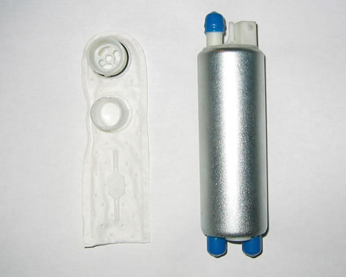

Here is the reply from TRE performance:
We do not carry a 255 LPH pump for the Silverado.
The TRE-382 is not on our website since we do not yet have the full kit for it. We only have the pump and a filter, I have attached an image of what you would receive. The pump is basically a stock replacement pump, so it will not have any problems on a lightly modified truck.

Here is another reply in regards to the $49.95 unit from TRE:
Yes that is correct, it will flow around 110lph.
