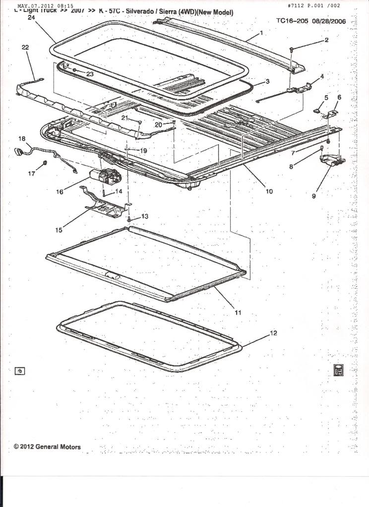

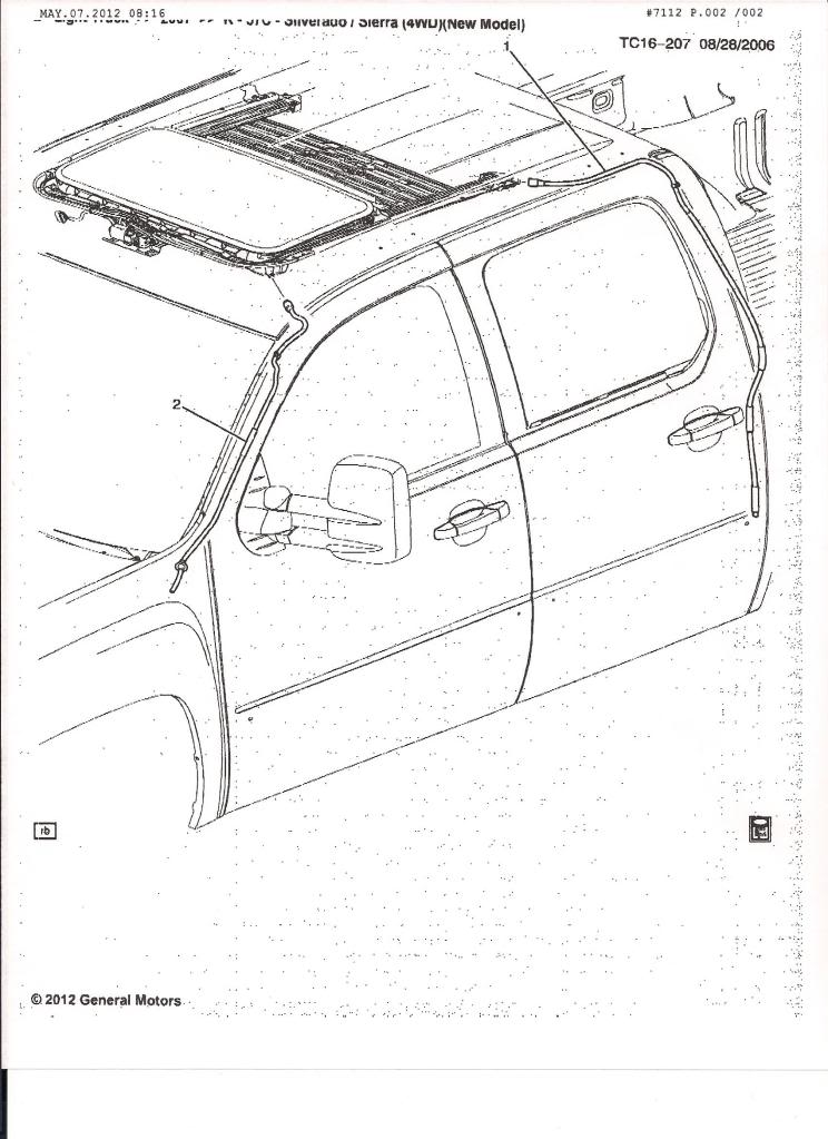

#24 is a seal, and can be serviced seperately. The part number is 20814007, and lists for $43.89, my local dealer has one on the shelf.
There's the breakdown on the parts. Your drain tubes are likely clogged. IIRC, the seal is not designed to keep all the water out. The water that gets around the seal is supposed to fall into the sunroof channel (read: gutter), and then drain out the tubes.

Man, I REALLY appreciate it. According to that drawing there are four drain tubes. I only saw the two but that's because they're up front obviously. I don't think I can access the back two without dropping the headliner. I suppose I can try to find the end of the back by the C pilar and shot some air up it the reverse way. Either way it seems I need to clear my drain tubes, and realign the glass. The seal is probably alright it seems but I'm going to replace it anyway. I'd really rather not have my new-to-me truck destroyed by something easily preventable. Thanks again, one of these days I'm going to have to box up q care package with some Coors light for you.
