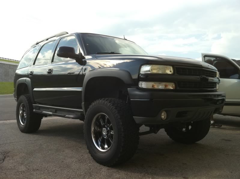

My wife and I are traveling to Colorado Springs (15-16 hrs) for Thanksgiving and we decided to take the tahoe for safety reasons in case it snows/storms (4wd,35",etc.). I was wondering what to check and/or change before the trip(fluids, etc.)? It's a 2004 with 75k miles, 4WD, etc. I was most likely going to change the trans fluid anyways but I would like to hear opinions/comments from y'all. Any help is appreciated!
