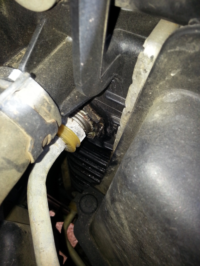

I have a 2002 gmc 1500hd and have sprung a leak. The radiator is leaking around the fitting for the oil cooler. Can it be fixed or replaced or something or do I have to buy a whole new radiator

That radiator is done, beginning to rot. Don't try patching it, the fiberglass will simply shatter later.
Radiator is not too expensive and very easy to swap out.
