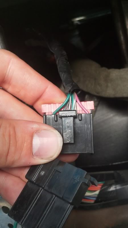

copied from another site-
2000 NBS Tahoe.. Ive been getting a draw on my battery and i traced it to these wires..SEO1 and RADIO both have something to do with these..what are these wires for? do they go to the speakers? when i unplug this plug, my draw goes away.

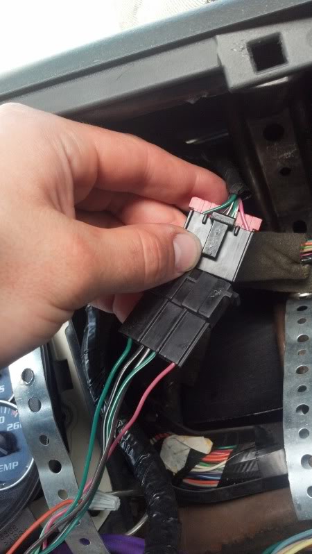

Those wires are used for OnStar's interrupt trigger to override radio functions to the front speakers. The only way to truly bypass the OnStar audio system is to splice each one of the corresponding in and out speaker wires together at the passthrough subwoofer amplifier (and remove the amp completely). You'll have a few wires left over that go to the sub and to the system disable triggers. You'll notice that if you leave that connector unplugged you don't get any sound from your radio.

ya when i unplug it, i get no sound through anything but i have power to the deck.
