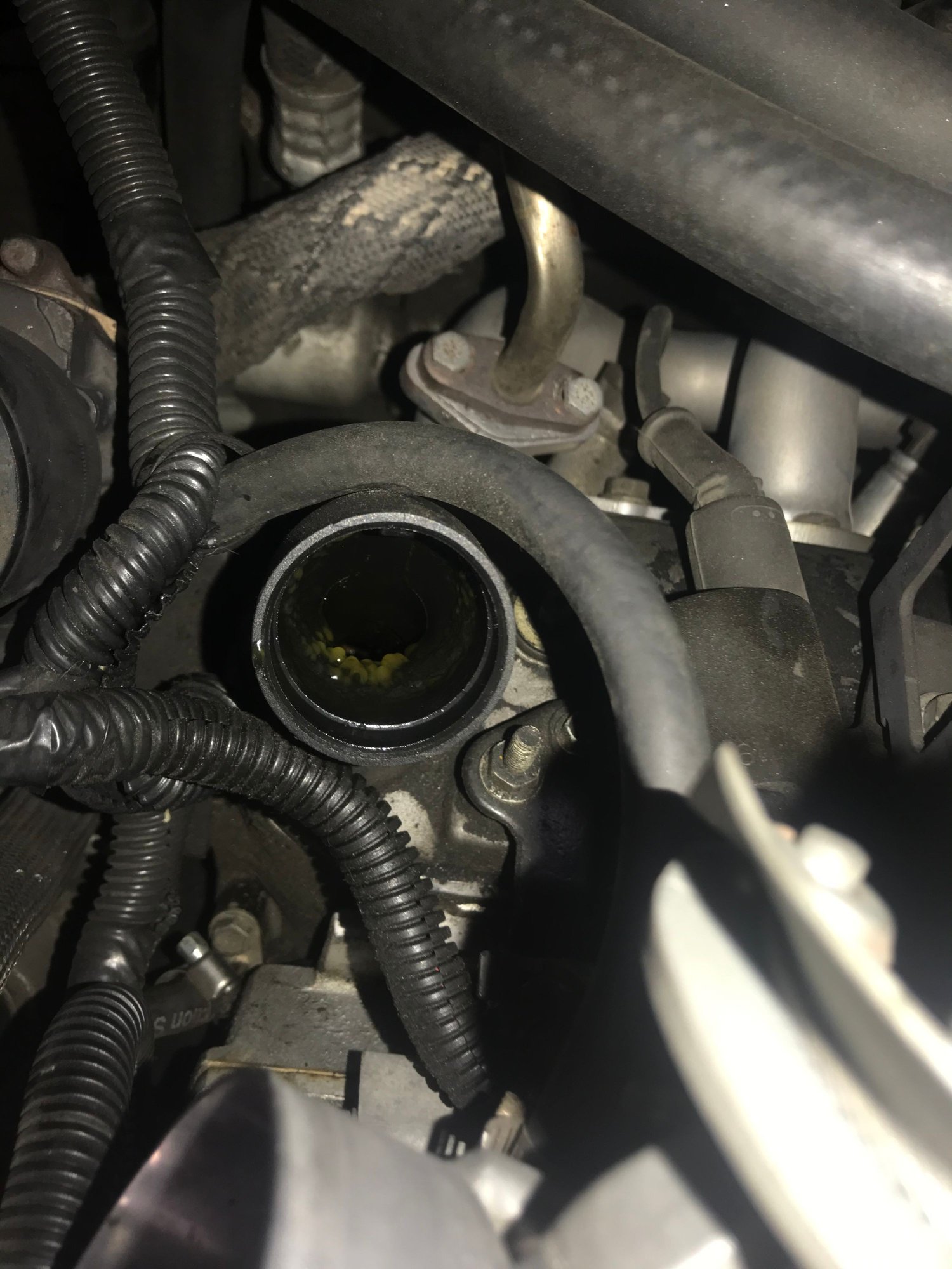

Was changing my oil today and found this in the filler neck and oil cap. Is this glycol from the anti freeze. Ive been loosing a quart a month.....cant find any drips outside. I’m thinking cylinder head has a hair line crack or bad head gasket. This can’t be normal condensation right.

Loosing a qt of what? Antifreeze?

Yes, antifreeze. Every 6000 miles I burn a quart of engine oil. I have 121,000 miles on the engine

If you are losing a quart of engine oil and antifreeze every 6,000 miles then yeah you have a problem for sure.
The oil at 6,000 miles isn't a big deal as GM says 1 quart every ~2,000 is okayish. But the coolant loss is bad. Sounds like a cylinder head issue or head gasket.

Well I changed the oil yesterday....now it idles at 30 psi, it used to be 40 psi. At startup this morning I heard valve chatter for 5 mins before it went away. I’m thinking the pickup has that junk stuck in the screen. I live in So Cal, does anyone have a recommendation for a good shop to go to. I would love to do it myself......but don’t have the time or the place for it. Thanks
