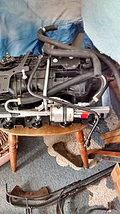

Hey guys doing a nnbs intake swap this weekend and read the write ups on here and a couple other threads but no pics.Im planning on putting the filter on the end of the fuel rail I haven't test fitted yet but looks like it might be a tight fit with the firewall.Heres a pic of what I got so far anybody run this set up with success

That's what I did and used a C5 corvette fuel tank transfer hose to connect it all.

fuel tank transfer hose ok cool thanks man

just picked up this off a 6th gen as camaro at work see if I can flip the rails and make it work with the criss over fuel line

I just used nylon fuel line with the proper quick connect ends and re plumbed it as needed (not modding any stock lines) instead of cutting the mounting tab. However I like how you cut that. I may re do mine then weld a filler on or screw/bolt a piece to reinforce the cut tab. I won't lie as of now my regulator/filter is fastened to the fuel rail with speed ties
